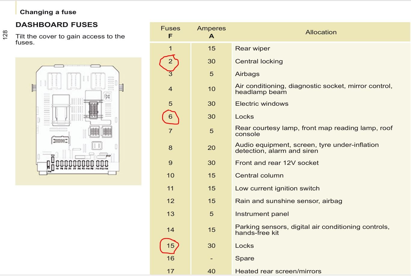

Garryj001 wrote: 17 Jul 2025, 12:56 you happen to know which fuses it could be?
I would start by taking a look at these fuses in the BSI behind the glovebox

Totally forgot about the shunt, however it will be totally different as the van in the other thread is a Mk1.
This post will be more relevant, Make sure the shunt is in the 'Client' position
See here> viewtopic.php?t=68998
