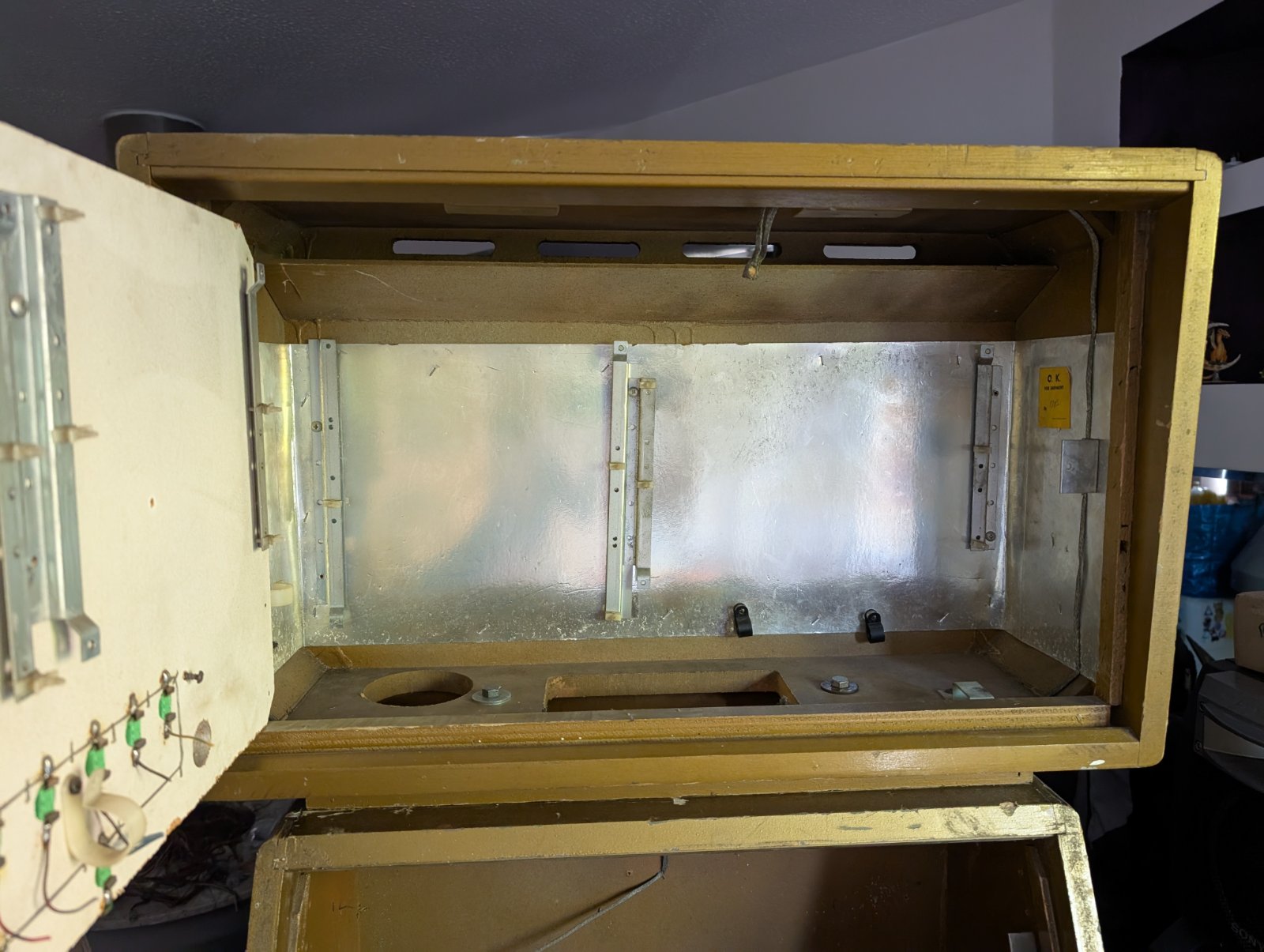

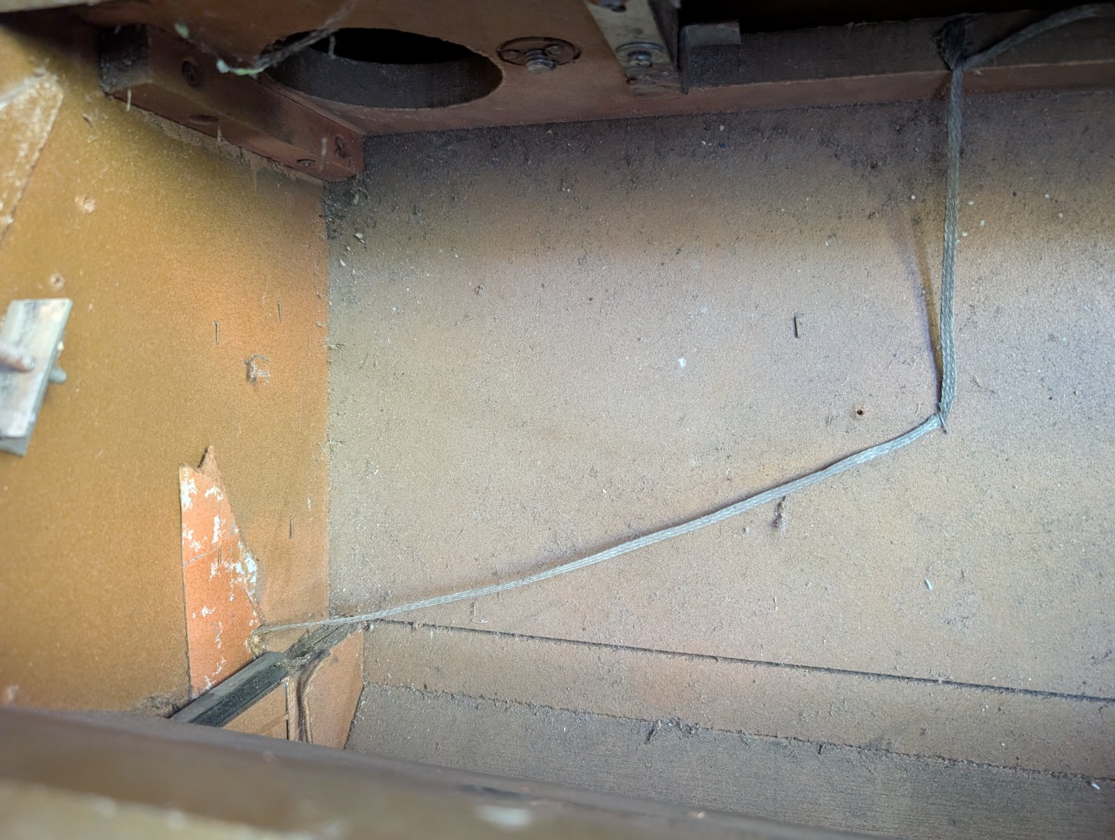

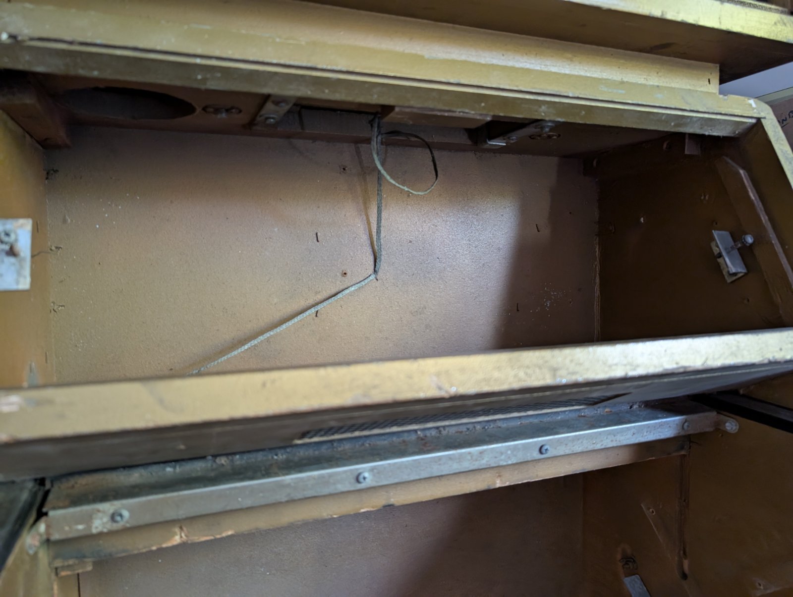

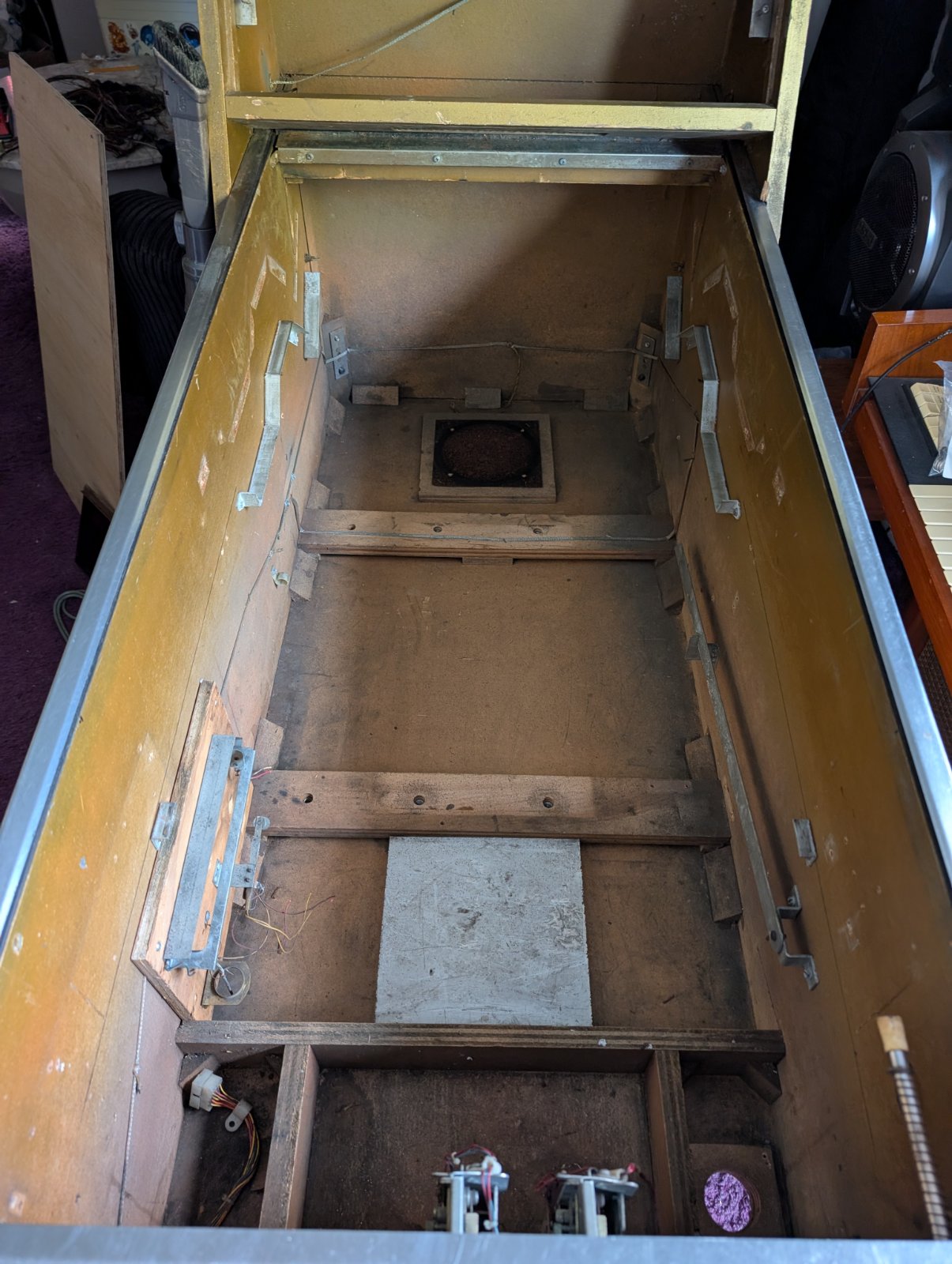

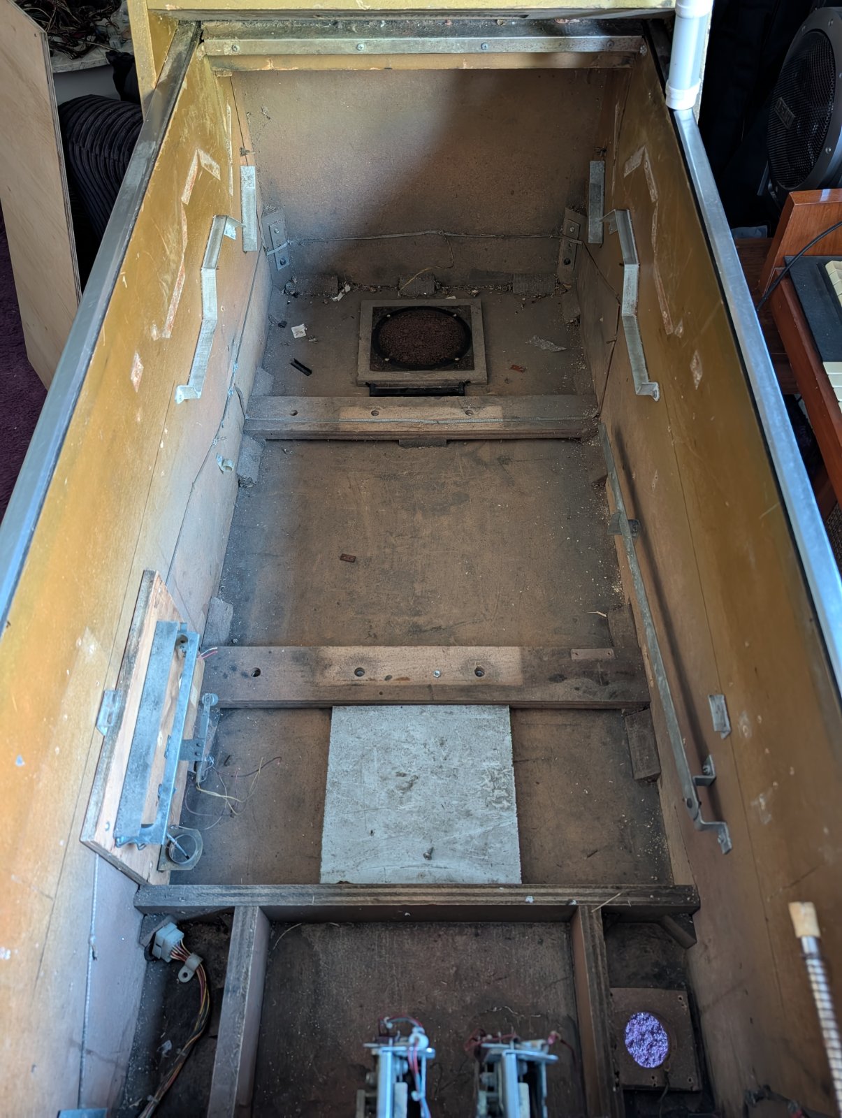

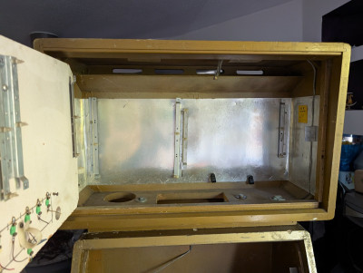

As I've got to the point where I'm going to be starting to put things into the cabinet and doing a few modifications to it, time to make it slightly less unpleasant to work on. Basically get rid of 45 years of cobwebs and grime from in here.
Honestly not all that bad for one of these. A bit of vacuuming later though it was looking far nicer to work on.
The mid box was probably the worst area before.
Back box wasn't bad at all, but is now also now spider free.
Probably the thing I'd like to get started this week is mains power input. The way things will be set up here will be that there will be two power switches. A physical isolator on the back panel which will isolate everything. The actual wall socket this will plug into is buried down behind an armchair so is a real pain to get to, so being able to kill it without having to stand on my head will be nice. The second switch though will be a push button under the front right corner - where the switch normally is on a real table. This will be the power button for the PC inside. Something which will be tied into the 12V feed from that PC will be a contactor which will then turn on the mains to everything else in the cabinet - so once the PC powers up, everything else will then also wake up. Quick, easy way of ensuring we don't have a stupid off-mode power draw without vastly overcomplicating the wiring. Pretty sure I have everything needed for this already on the shelf - assuming the contactor I'm thinking of is a 12V one anyway.

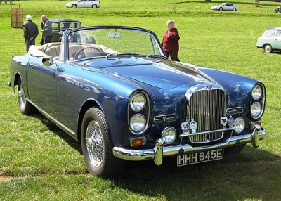

I'll plump for a 1961 Rover 100Zelandeth wrote: 13 Jun 2025, 23:11Congratulations, you're a winner!
...Or do we make you figure out exactly which year and model too?
