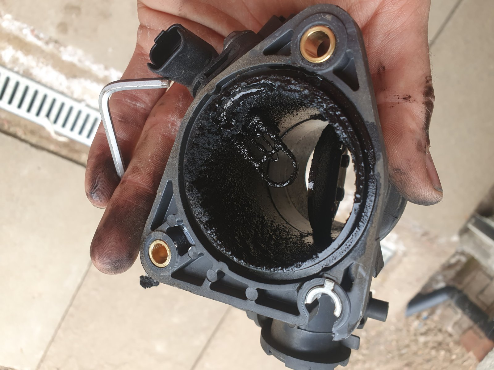

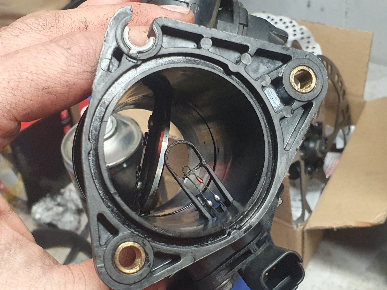

Car drove today without stalling. I gave it a few Italian tune ups on the way in at 6am. Cleared the faults log at work. It was much warmer returning this afternoon and although no stalling, the throttle response is poor. Delayed and not exactly punchy. Checked the faults log getting home and there were faults for the turbo pressure solenoid again, throttle pressure. Same ones as before I cleared it. Kms of when they occurred matches the journey home, actually just leaving the motorway to be more accurate. I wondered what the state of the throttle body was like. It's up stream of the egr pipe inlet but downstream of the turbo and intercooler and wondered if the intake was going to be gummed up with grot.
Anyway, the amount of black horror stuff at the end of the egr valve thing was a hint because it was thick with ink black gunge. So the least i can do is clean the throttle body, the butterfly and the 2 sensors( I think inlet temp and pressure) they were all black coated.
Before After Can actually see the air temp sensor now. No idea if this will help that much but it wasn't too much of a challenge to clean. Although it's used up all my electrical contact cleaner.. also cleaned the reachable part in the intake manifold and vacuumed it out but I plan to remove the manifold to clean once the new gasket set arrives.
But early indication is good, started and ran smoothly and although I didn't go on a test drive, going up the drive way was enough to show the throttle response was better. Unless it was my imagination.

Excellent photo!

Ha thanks, I couldn't believe how grotty it was

It drove surprisingly well this morning. Don't want to jinx it and assume its fixed though

That was indeed very grotty - as you say, difficult to imagine how that temp sensor could be working correctly, when covered in that much crap!
makes me think I may go and check those on mine...

White spirit and old toothbrushes surprisingly effectively at that type of muck. Old socks / rags to wipe down.
Probably keep the white spirit off the temperature sensor (think unscrews from the "throttle body" housing?) but otherwise works pretty well. Won't melt the plastic either
