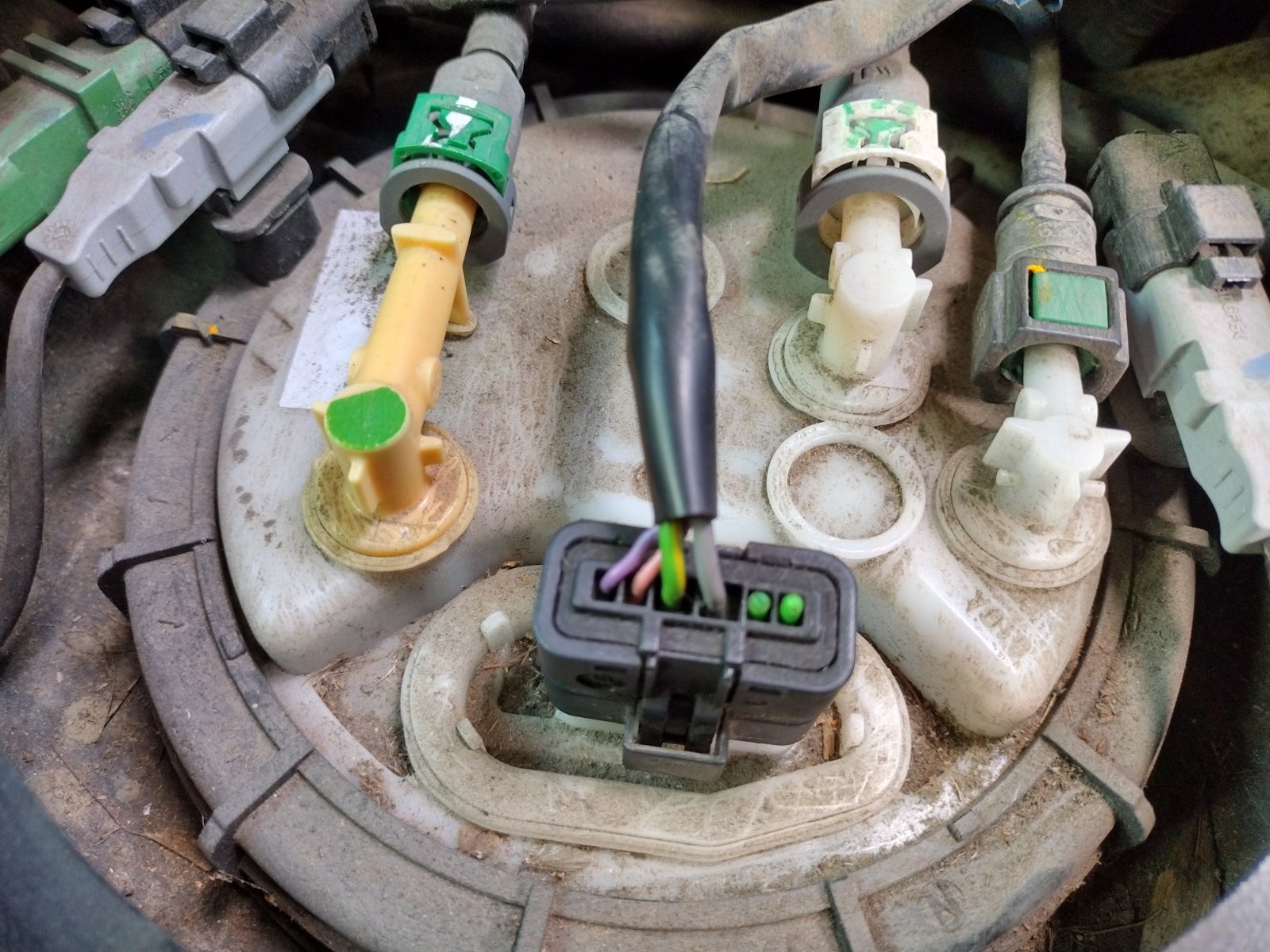

Current hypothesis is the in tank lift pump isn't performing. Top of tank six pin black connector. Two pins unused. Two small wires assumed to be level sensor, two chunkier wires assumed to be pump feed. 12.24 volts measured when ignition switched on (and continued a good few seconds after switching off)
No noise from pump at all. Thumped bottom of tank in blindly optimistic attempt to jolt in to life, but no change.
Is there access to wiring diagrams to confirm my hypothesis? Looked on Diagbox but seems to be beyond what's available (without connection to PSA servers)

- Posts: 5337
- Joined: 25 Apr 2022, 09:03
- x 2355
Re: C5 X7 no start (or only runs for fraction of a second)
Picture tells a thousand words etc

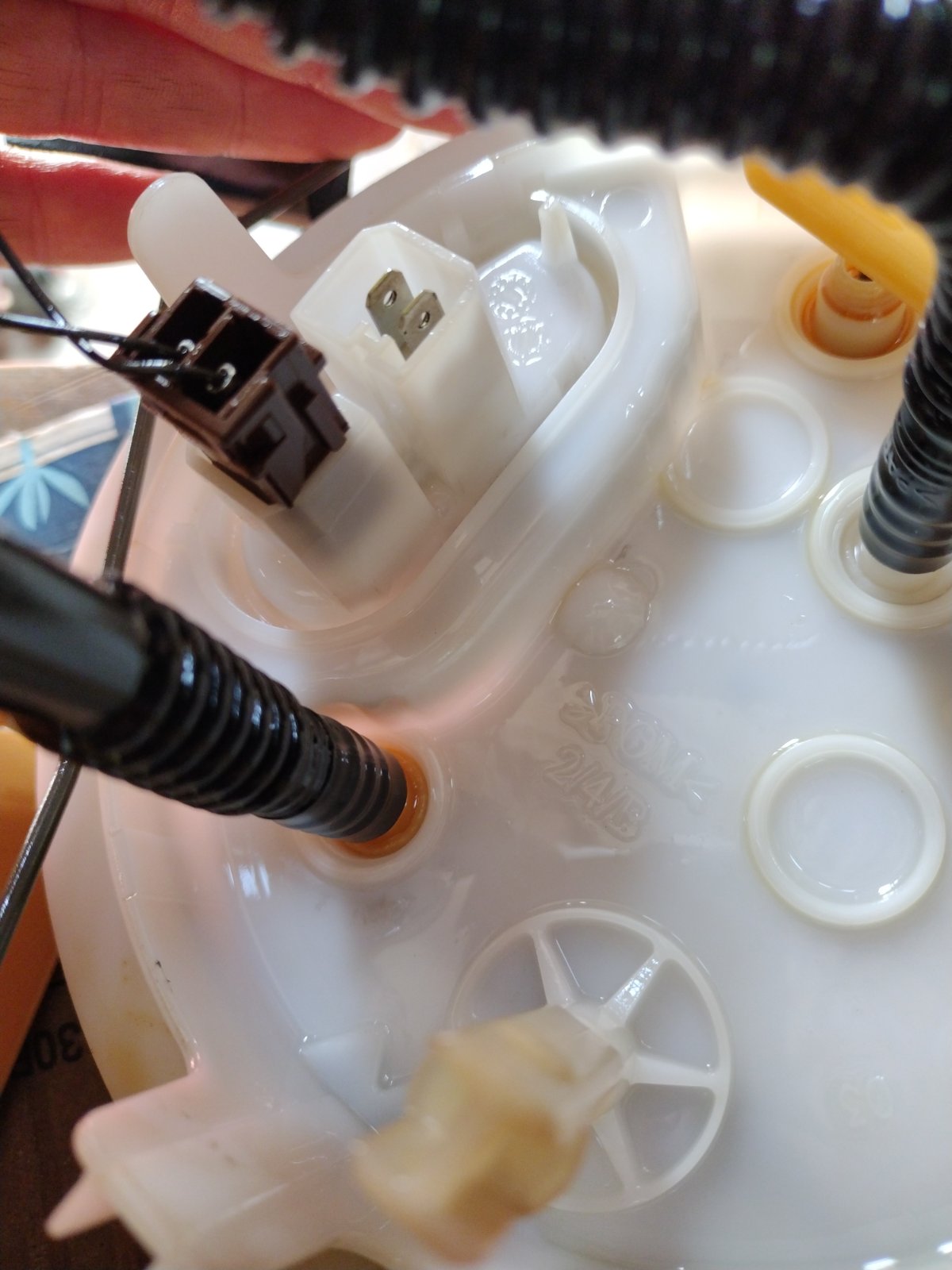

Are there pins in the tank unit that match up to the thicker wires? I suspect there is no in tank pump on this car (although the wiring can still be present & live), If there is a hand primer there is not normally an in tank pump.
- Posts: 5337
- x 2355
Yes, four pins in the socket (the two absent ones corresponding to the two little green lumps on the wiring socket)
Two chunky cable aligned pins read open circuit (but likely would do so for either a dead pump or no pump!)
Will try and get the plastic ring unfastened tomorrow and see what hides within the tank.
Makes sense that no need for a priming bulb with an in tank lift pump (unfortunately, as hoped I'd found the fault!)
Matt

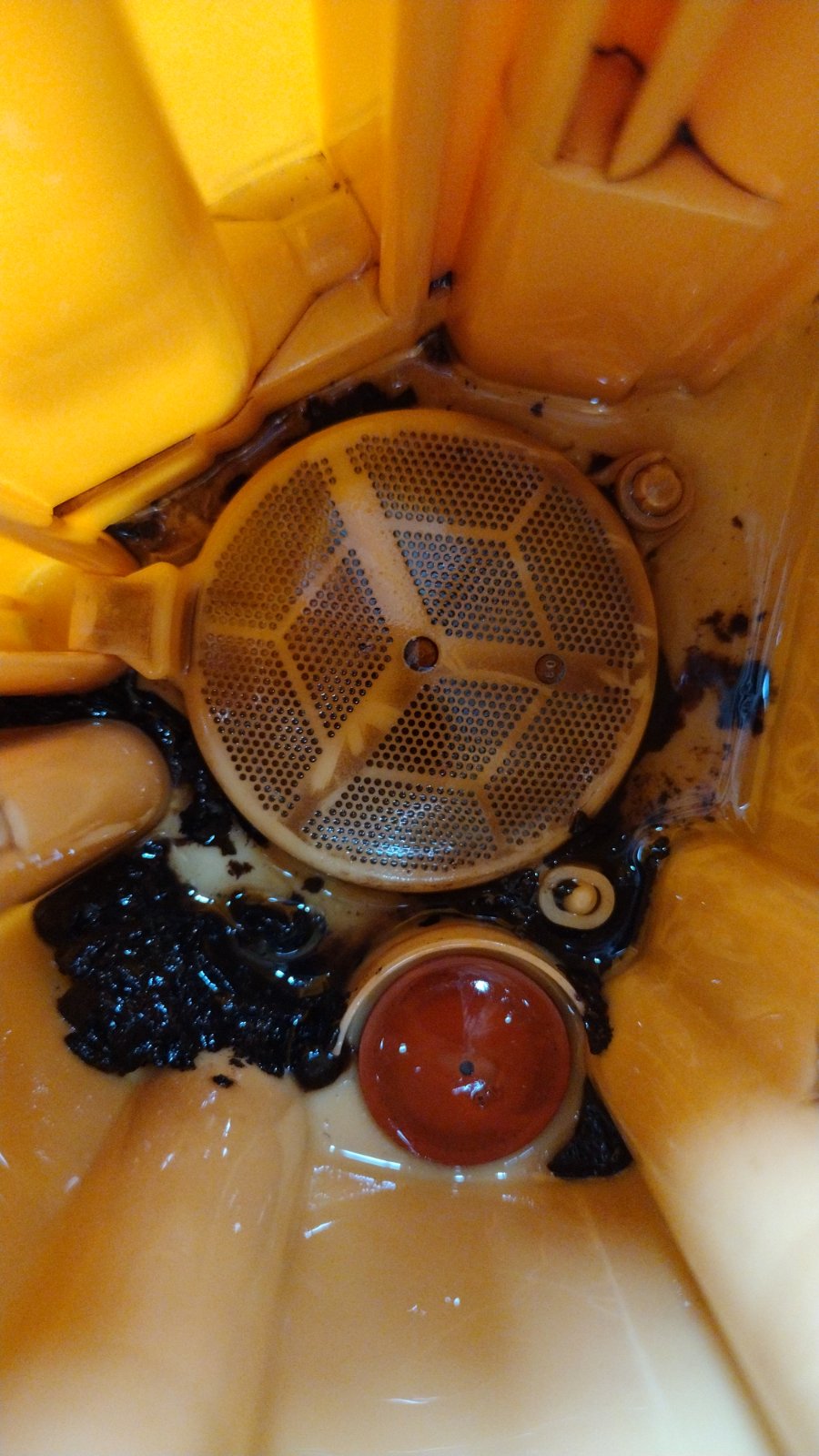

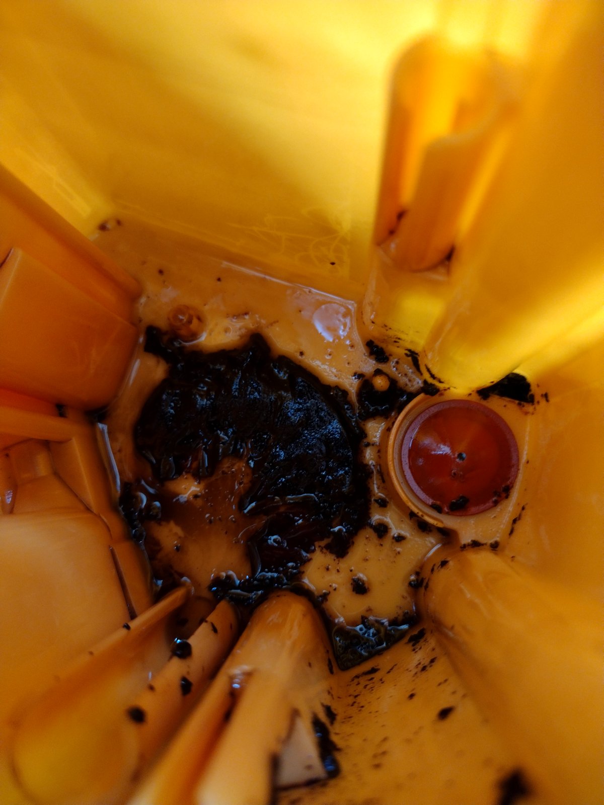

- Posts: 5337
- x 2355
Re: C5 X7 no start (or only runs for fraction of a second) biodiesel bloom?

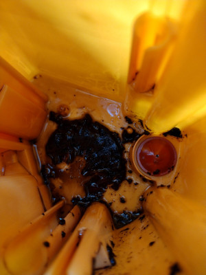

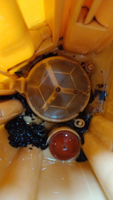

What's the collective opinion on the accumulation of muck here?
To confirm, no in tank pump on this model
Matt

wheeler
- Posts: 7930
- Joined: 21 Sep 2002, 19:07
- x 1055
Doesent look great, whats it like inside the tank? Have you had the fuel filter out for a look? not sure if its a sealed unit or a replaceable cartridge on this engine? If its a sealed one i think i would be cutting it open for a look.
- Posts: 5337
- x 2355
Hard to tell what is like inside the tank as is near enough brim full - poor timing! Decanted 5 litres into a can as was trying to spill over when putting the sender/pickup back into place.
Fuel filter recently replaced, is a big plastic unit. New one is Bosch, old was marked MANN - cut that open and inner element was marked Purflux. No massive accumulation of muck in the filter. Not worked out how long the MANN filter had been in place from previous owner's service history.
The muck is same sort of consistency as coffee grounds, surprisingly firm. Not sure why but expected algae to be sort of gelatinous in texture.

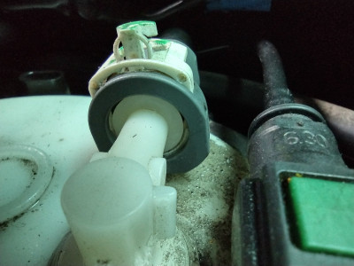

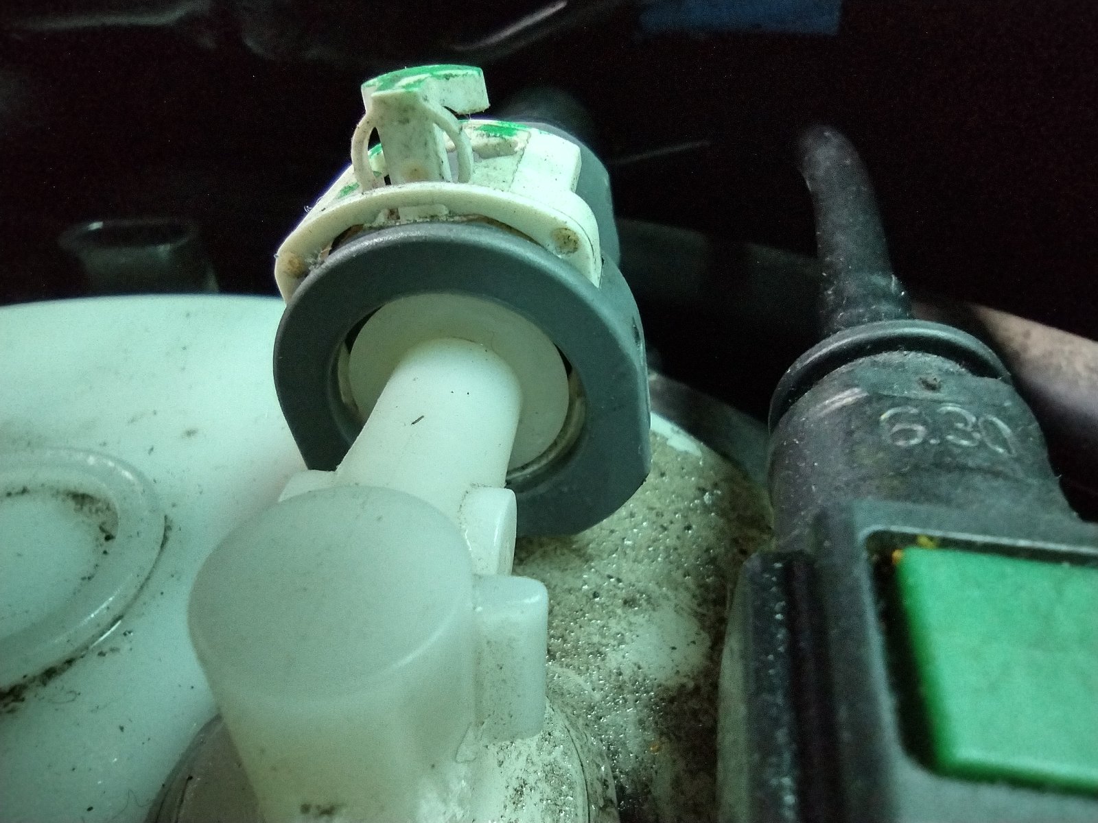

Managed to knackered the clips on the plastic lid (not top of tank, but the push on one on the body shell)
Note for future reference, IT DOESN'T JUST PULL OFF. The clips (location discretely marked with arrows on top surface) should be pushed back with some flat tool (thinner than flat screwdriver, must be more akin to a feeler gauge) special tools can't be too wide otherwise won't push clip back far enough. The clips themselves are very flimsy - the one that did survive seems under stress to reach the point it would unclip.
Or put it another way, it seems engineered specifically to break! Will re-engineer something to sort it as short route from this hole to the road below. Quite surprised given the number of plastic covers under an X7!
Next, after a re-priming, manually and quick try again is battery disconnect and starter off. Will strip regressed, clean up commutator and see if goes any faster. Still don't think it is TOO slow, but as it's reasonably accessible it's worth a fiddle with it.
