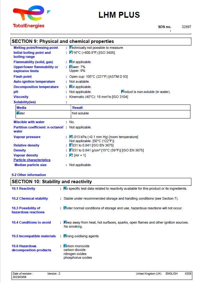

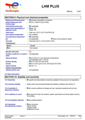

Re: Evaporating temperature of LHM
This doesn't really answer your question, but I think it's the closest you'll get to a meaningful answer. It's taken from the MSDS for Total LHM Plus which contains plenty of information that you never knew you didn't need to know :lol:
https://cdn.autodoc.de/uploads/hazard/p ... 2-EN-1.pdf
Total LHM Plus MSDS - Total Energies

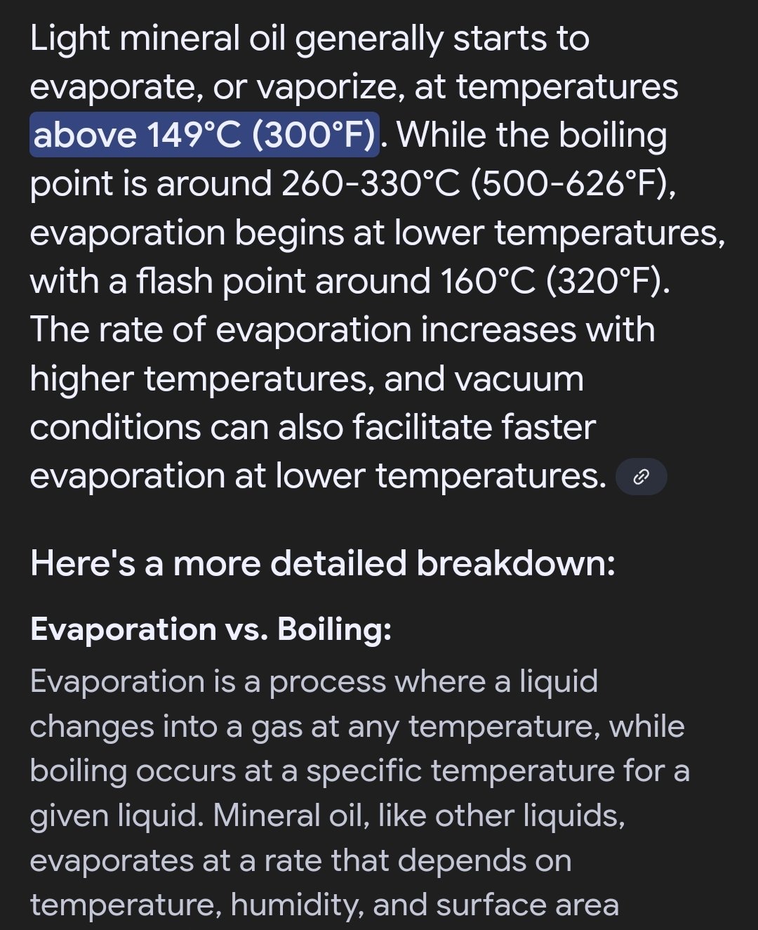

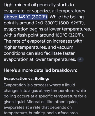

Unread post by aerodynamica »
Just searched evaporating temperature of light mineral oils and this came up.
Graeme M
Unread post by PaulC5 »
If you wanted the atmospheric pressure boiling point the LHM MSDS above gives it as greater than 316°C. Any liquid will evaporate at lower temperatures though, put some water on your hand and it will gradually evaporate to demonstrate this whereas its boiling point is 100°C at atmospheric pressure. If you lower the pressure the boiling point will reduce.
