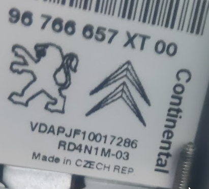

my car Citroen Grand C4 Picasso 2.0 HDi 165 FAP has a weird radio . Could you guys help me identify it .
So this radio :
- has USB port which can play MP3s
- it also has a AUX input. (aux and usb port located between the seats not on radio face)
- it also has bluetooth. I can connect the phone and output audio through bluetooth to car stereo. But the microphone does not work . I suppose it has a microphone but it's faulty.
In order to identify it i took it out of the din slot and i saw the codes : 96766657xt00 rd4n1m-03 A2C53424335.
So is this a RD4 , RD43 , RD45 or anything else ?
Asking because the internet or nowadays GPTs say that RD4 does not have bluetooth or USB.

I think that you have a basic RD4 (single antenna) with an external bluetooth telephone module.

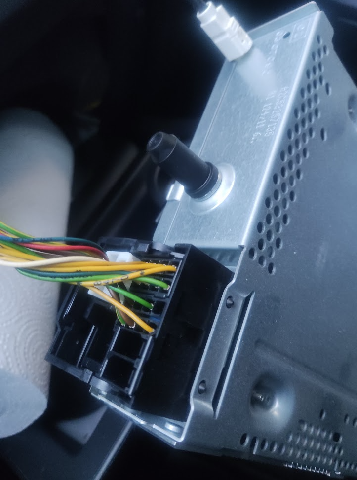

Is the USB cable the white connector on the right side ?
What is the black thing in the middle going nowhere (seen it before but i'm newbie with electronics) ?
There seems to be an additional square white connector inserted in the big black square connector on the left side . Is this normal or is it an aftermarket job ?

There are pinouts for RD4 and RD45 here: viewtopic.php?p=725847#p725847

myfirstpicasso wrote: 26 Mar 2025, 09:38
This is just a locating peg, stops the radio unit dropping down, if you look in the DIN hold you will see the hole it mates into.
