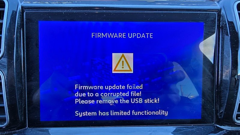

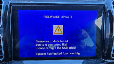

PAS06
- Posts: 3
- Joined: 10 Jan 2025, 06:50
Re: PSA NAC RCC Updates
Bonjour,
j'ai voulu hier faire la mise à jour logiciel de ma Citroën C5 air cross de 2019, mais lors de la mise à jour, au milieu l'écran ma informé qu'il y avait un problème de fichier, et depuis le système est bloqué, j'ai essayé de mettre l'ancien mise à jour de 2023 que j'avais sur un clé USB et la il me dit que ce n'ai pas la bonne version, je suis allé chez Citroën, et il m'on dit que que l'unité devait avoir son disque dur de planté et qu'il fallait peut-être remplacer le système. Sur mon véhicule j'avais la version 44.07.33.32_NAC-r0, je voudrais essayer de la réinjecter mais je n'arrive pas à la trouver pour la télécharger.
N° VIN: VR7**************[VIN obfuscated, can be read by forum staff]
Merci de me donner si possible une solution.

PAS06
- Posts: 3

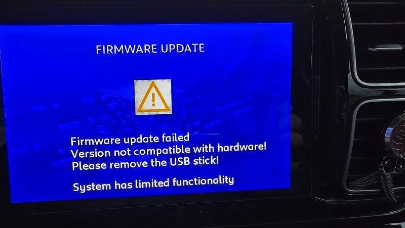

Good morning,
Yesterday I wanted to update the software of my 2019 Citroën C5 air cross, but during the update, in the middle the screen informed me that there was a file problem, and since then the system is blocked, I tried to put the old 2023 update that I had on a USB key and it tells me that it doesn't have the right version, I went to Citroën, and it told me said that the unit must have had its hard drive crashed and that the system may need to be replaced. On my vehicle I had version 44.07.33.32_NAC-r0, I would like to try the reinjector but I cannot find it to download it.
Attached is the progress of the installation before blocking. When I try to put version 2023, it tells me version not compatible.
If you can, please send me the software version
44.07.33.32_NAC-r0 and give me the procedure to install it.
THANKS.
THANKS.
- x 6956
Hi
You cannot install older Firmware over a later version - even if the previous later update failed - by this stage you cannot revert back.
As you have already downloaded the latest firmware (44.07.33.32_NAC-r0) yourself using the App, the server is not allowing it to be re-downloaded, so I can't provide your licence file. I can however provide you with the firmware:
Firmware Version 44.07.33.32_NAC-r0.
Next, these systems DO NOT have Hard Disk Drives, they have internal Flash Memory. But, yes, they can still have issues when firmware fails to install.
So in order to try and reset the unit, have the latest firmware ready to go on a FAT32 Formatted USB Stick and try to reset the BSI as per the instructions below. However instead of waiting for the recommended number of minutes, Leave the battery disconnected for at least 30 minutes if you can.. This should allow time for the Head Unit (NAC) to reset itself whilst the power is removed.
When you complete the restart procedure, insert the firmware and see if it will allow it to install - do not disconnect the USB stick whilst it is updating - if you do that you will hae the same problems. Also, you must keep the engine running, otherwise the vehicle's energy management system can kick in and corrupt the update process.
