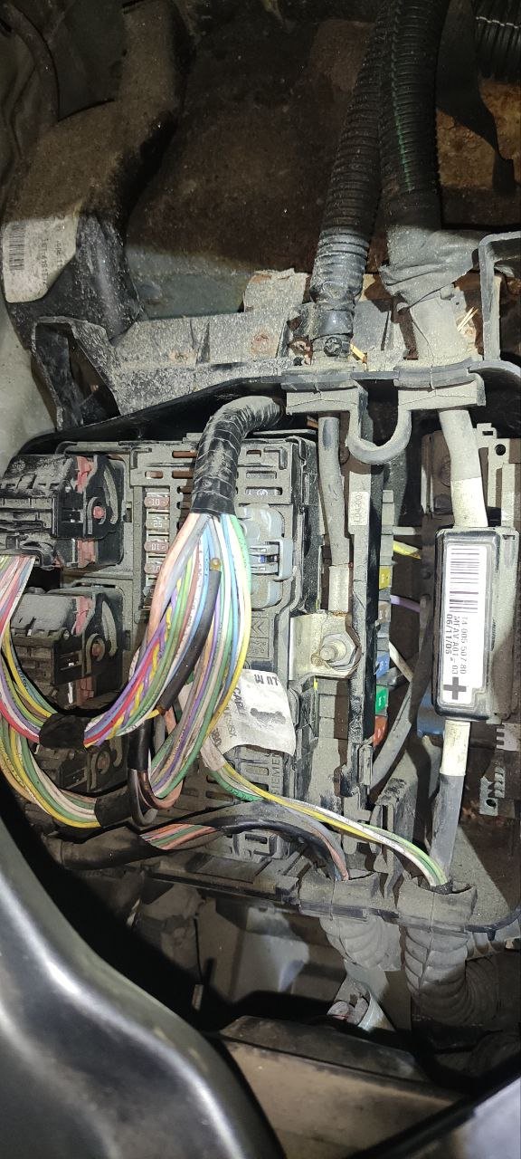

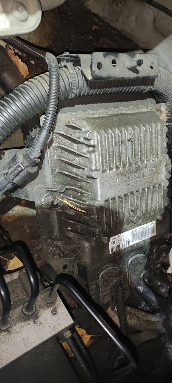

On the engine compartment left corner ( view from van's rear to front ) there a metal book looking like ECU -box as its whole metal so didn't open that.
Other box in engine space is that "Fuse box No. 2 in engine compartment (type 1)" and its located onto right corner not containing that 100A fuse.

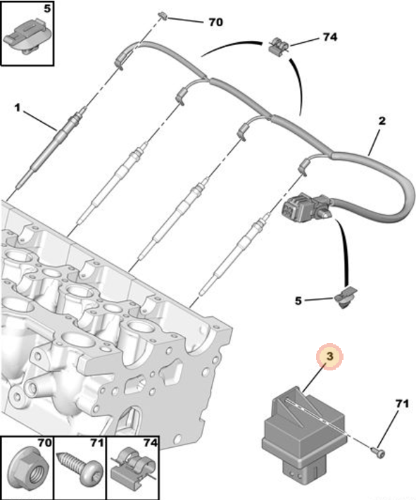

(3) Glow Plug Pre-Heating Unit, part: 9645668680, £102.64

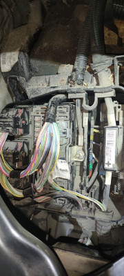

Still looked through and not able to locate that 100Amps fuse.
Looking from front of the car, right corner contains ECU And the left corner contains fuse-box, but not having any that size of fuses This box looks pretty same as "Fuses under the Bonnet" in thread viewtopic.php?t=70361
or that "Fuse box No. 2 in engine compartment (type 1)." in https://fusesdiagram.com/citroen/fuse-b ... (type%201).
But on side of that, can't be seen those MAXI fuses, but none of that are marked like that Preheating fuse, 100Amps
So still wondering where are those MAXI fuses locacted ?
