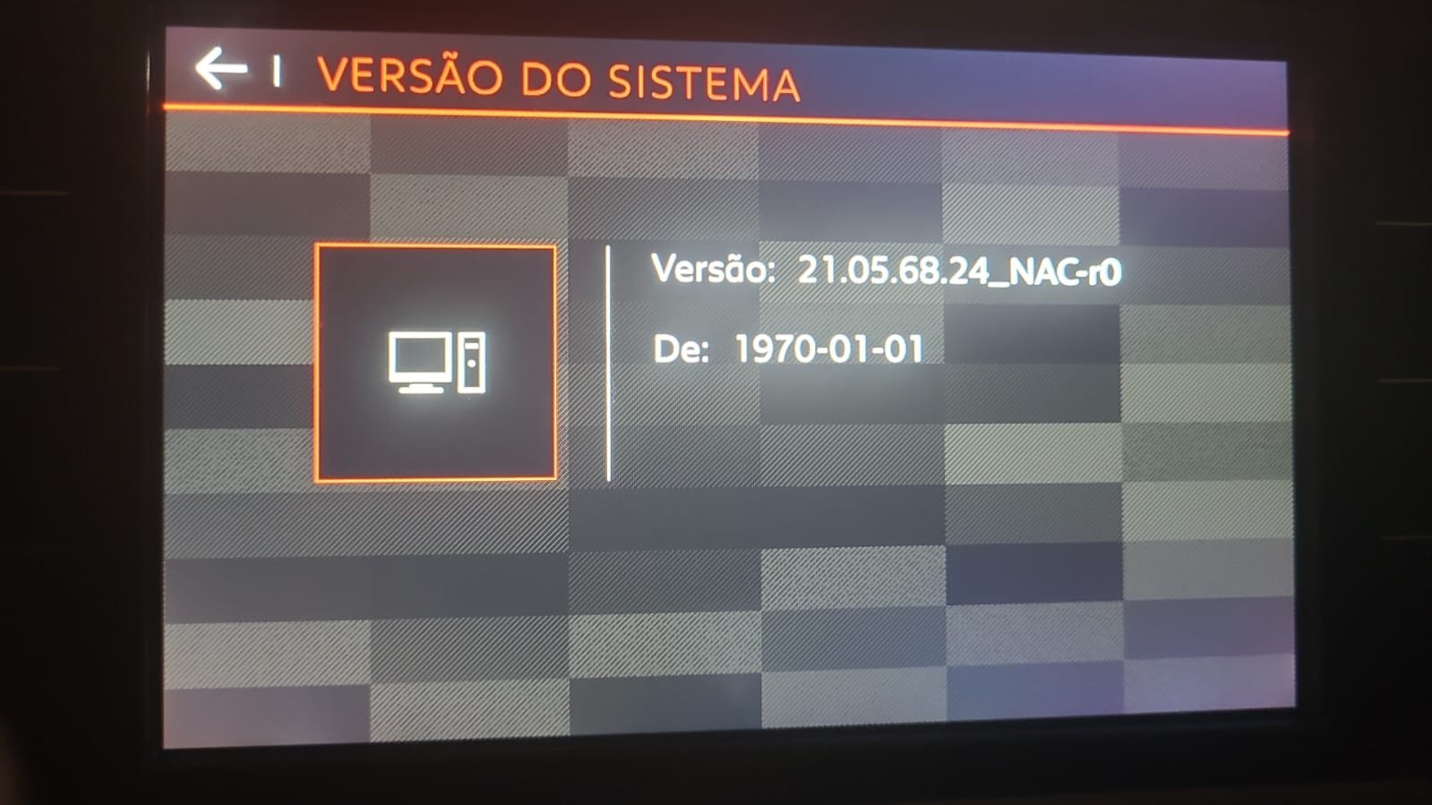

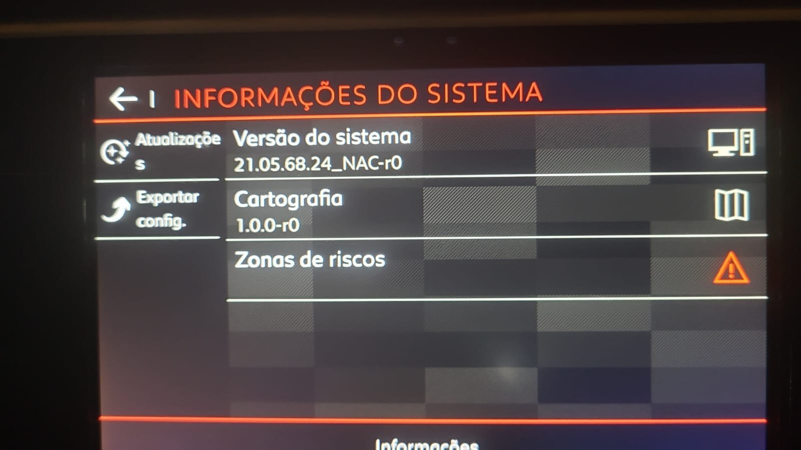

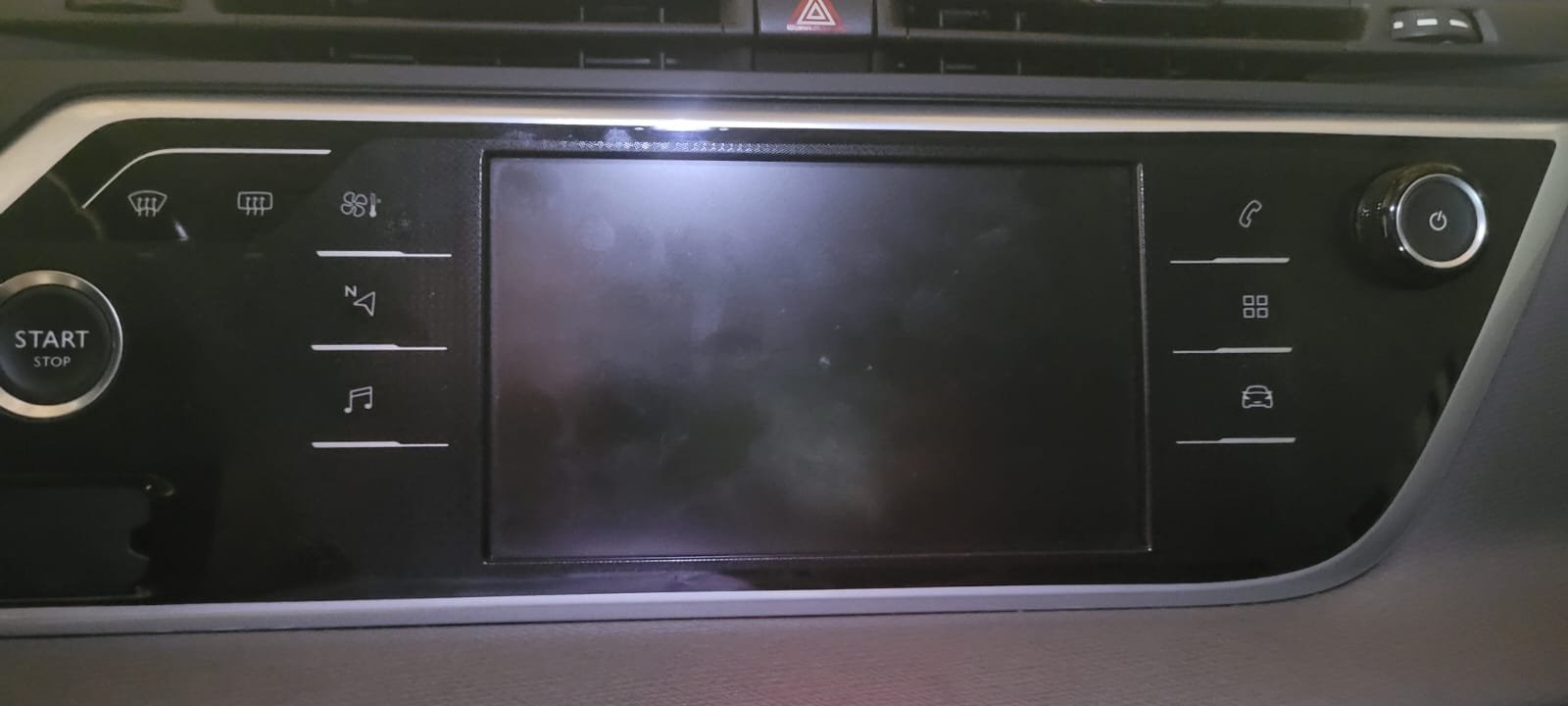

Hello, I have a problem updating the display on the Citroen C4 Picasso II Intensive 2017/18 . I tried to delete the previous owner's profile and it returned to a very old configuration and it keeps restarting every 2 minutes. I'll post a picture. vin:VF7**************[VIN obfuscated, can be read by forum staff] If you can help me with the new updates, thank you.

Staino
- Posts: 11
- Joined: 15 Nov 2024, 09:17
Re: PSA NAC RCC Updates
@GiveMeABreak hello, I have a problem updating the display on the Citroen C4 Picasso II Intensive 2017/18 . I tried to delete the previous owner's profile and it returned to a very old configuration and it keeps restarting every 2 minutes. I'll post a picture. vin: VF7**************[VIN obfuscated, can be read by forum staff]**************[VIN obfuscated, can be read by forum staff] If you can help me with the new updates, thank you. I can't update via the Citroen website

- Posts: 42019
- x 6955
@Staino
Ok, so you have the Wave 2 system - please refer to the paragraph in red 3 posts above ^. You won't be able to update firmware for the reason stated at present, only maps.
You can try using the links, but if it doesn't you'll know why:
Firmware 21.08.90.52_NAC-r0
Staino Licence File
Instructions for Updating NAC or RCC Firmware, Maps & Licences
