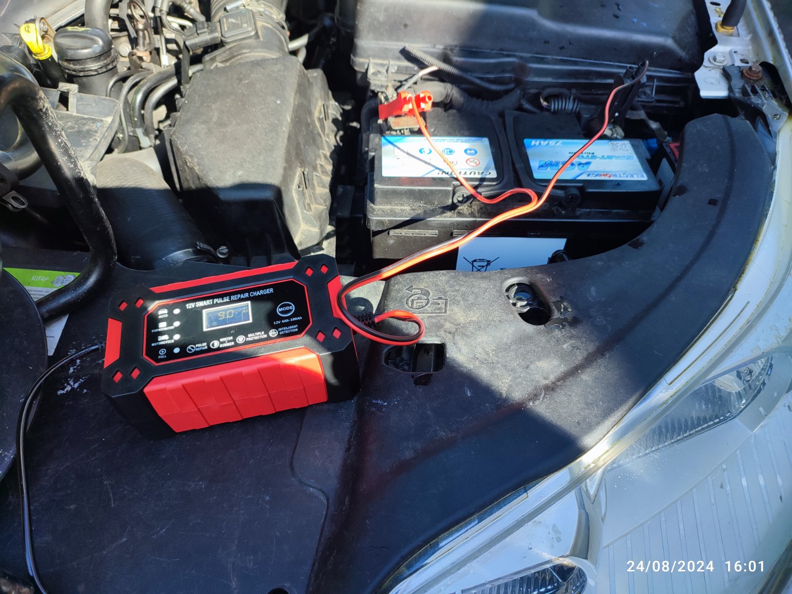

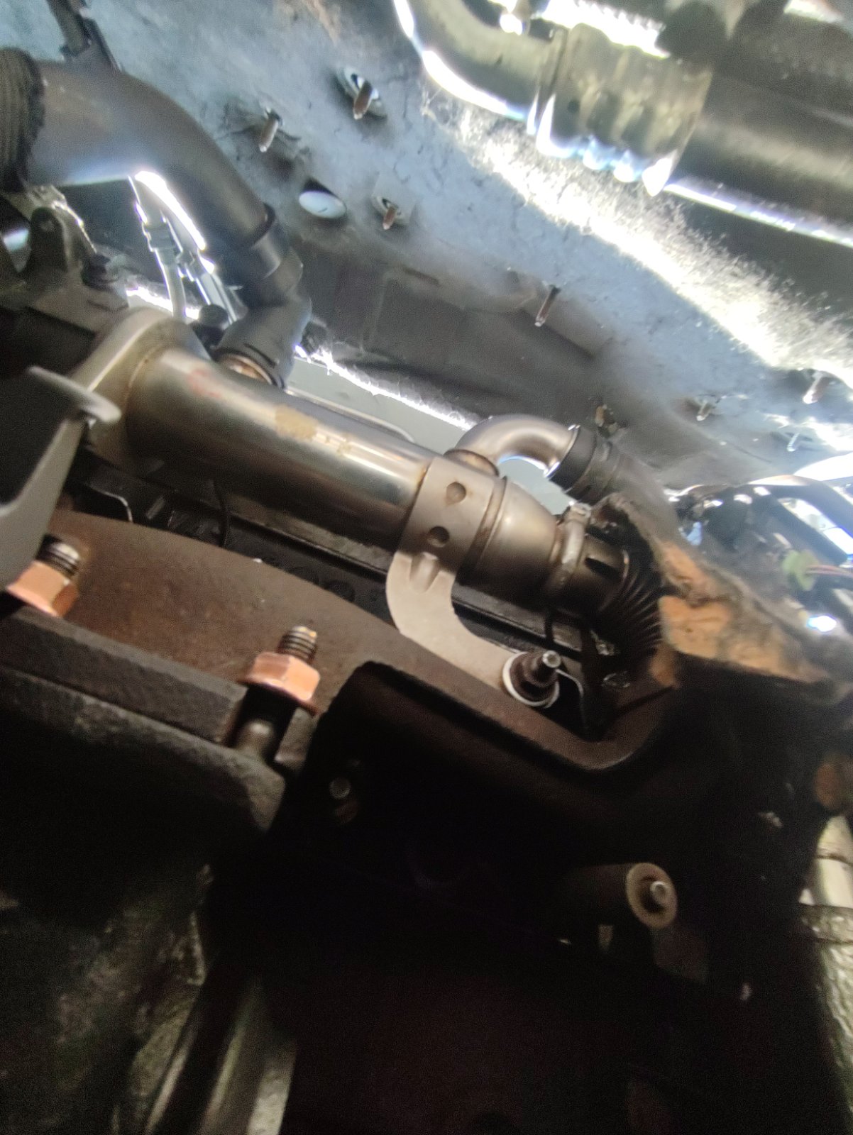

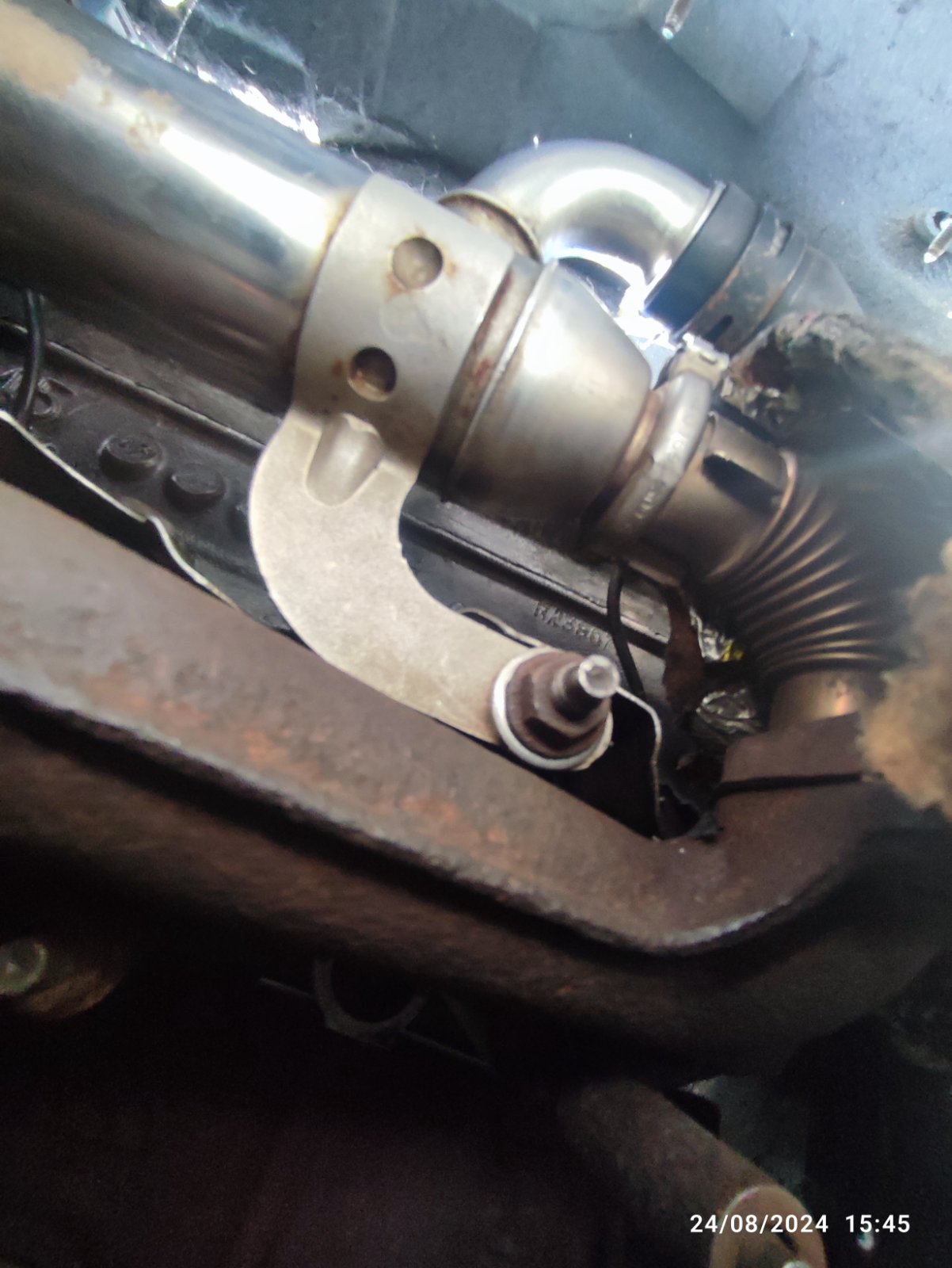

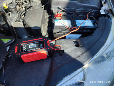

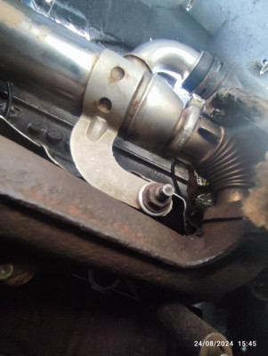

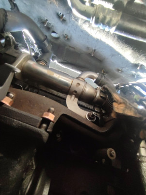

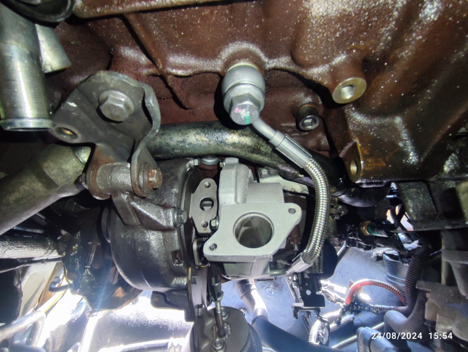

Well rained off again, had to put her on charge to get into the boot. A few pictures for you.

Ok so turbo and pre-cat are in I put a bit of a how to in a different post related to the turbo. Just need to connect up other bits and prime the turbo. I'm contemplating doing a compression test but cant decide if it is worth the hassle. At this point?

So turbo is fully installed I gave the intercooler and pipes a good cleaning just to be safe and I reinstalled the cat and Dpf and smoke tested the exhaust for leaks and everything seems fine no visible leaks. Just the drive shaft and engine mount left to do. Then refill gearbox and engine with fresh oil. I did however have a slight issue with the temperature sensor in the Dpf . It's a little bit bent , I'm not sure what happened it. I haven't tested it yet I'll wait until everything is back together and check for live data.as long as it returns data I should be good. If not I will just have to buy a replacement. I put a new high pressure a/c pipe in as well, mine had a pin hole in it and being aluminium it's hard to find someone willing to weld it , my mate tried but it kept bubbling up and leaving more holes so couldn't get it to work. I have to test the new one is airtight as well. The jobs on this car just seem endless at this point.
