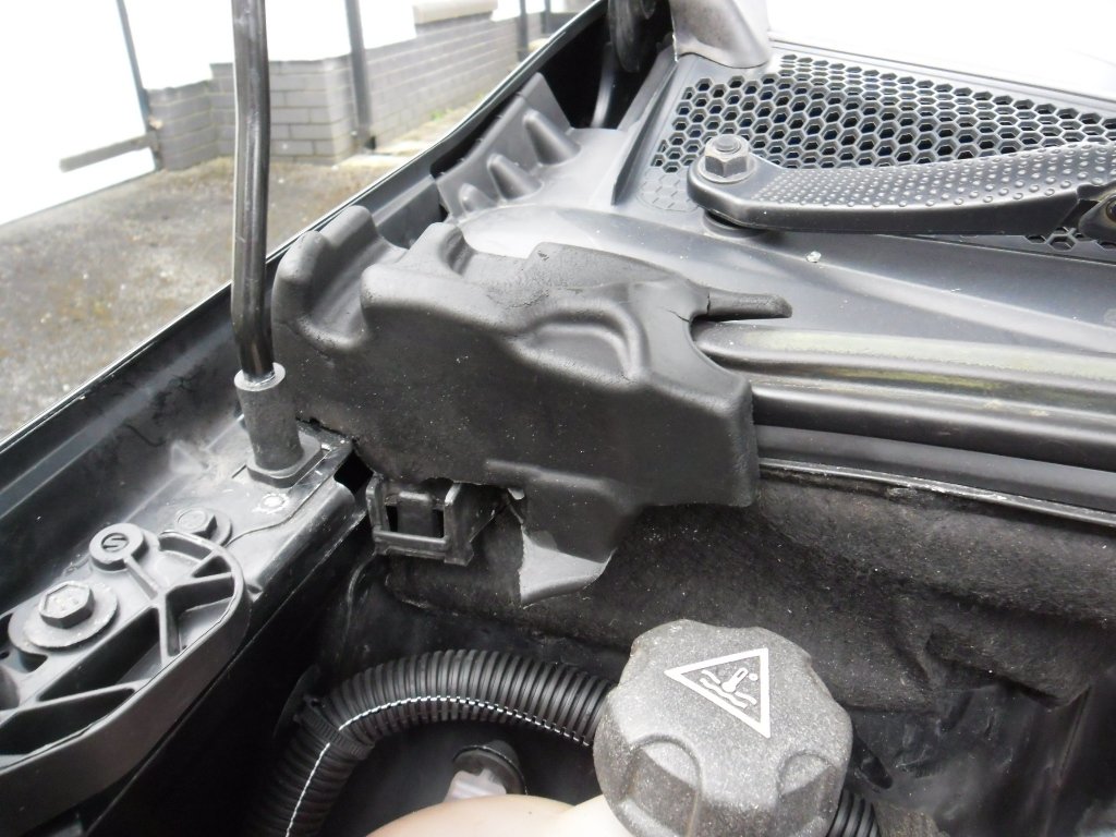

Thanks for that Marc. Would you be able to locate part numbers for the foam pads as per the attached photo. This is the driver's side one and I believe ( thanks to PaulC5) that there should also be one on the passenger side. The pad appears to be attached to the body at the top of the mudguard by means of a bright green plastic stud. This may possibly be a separate item to the pad. Thanks once again for your help.

Daibach wrote: 20 Mar 2024, 12:49 ImageThanks for that Marc. Would you be able to locate part numbers for the foam pads as per the attached photo. This is the driver's side one and I believe ( thanks to PaulC5) that there should also be one on the passenger side. The pad appears to be attached to the body at the top of the mudguard by means of a bright green plastic stud. This may possibly be a separate item to the pad. Thanks once again for your help.
Hi Dai
If you want part numbers, please can you request them in the main official part numbers thread, as I may not pick up the request elsewhere - just picked up this thread now.
(13) Foam
Right, part: 9809092980, £17.78
Left, part: 9809093080, £17.78
