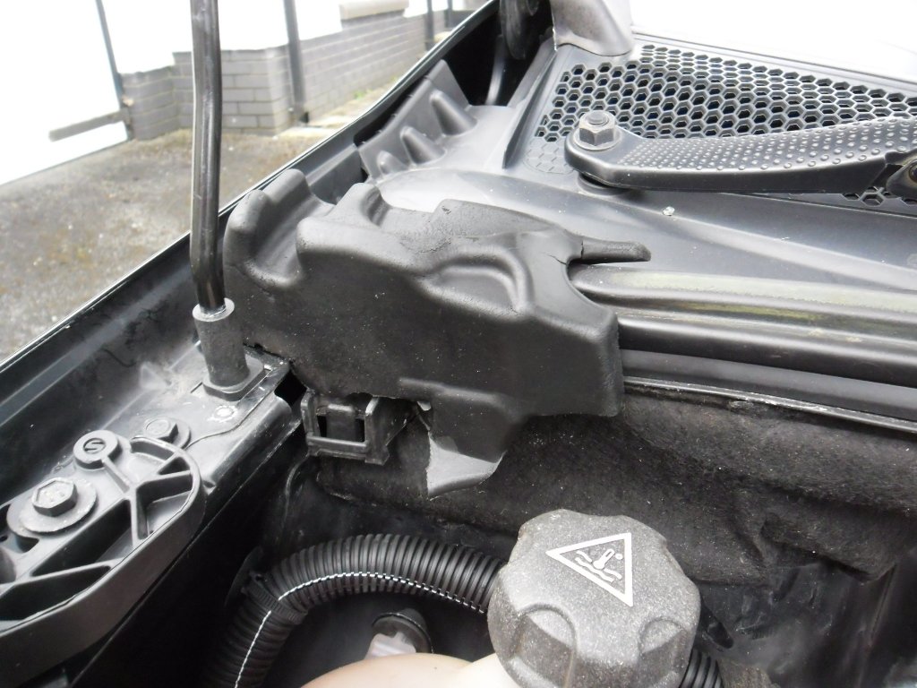

Thanks for that Marc. Would you be able to locate part numbers for the foam pads as per the attached photo. This is the driver's side one and I believe ( thanks to PaulC5) that there should also be one on the passenger side. The pad appears to be attached to the body at the top of the mudguard by means of a bright green plastic stud. This may possibly be a separate item to the pad. Thanks once again for your help.

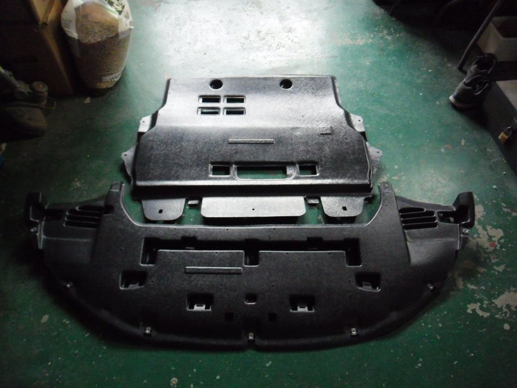

]SAM_6379.JPGHi Everyone, Just FYI I bought these new undertrays...bumper and engine...from Intercarparts and my garage reports that they fit well and all the holes line up. I just pass this info on because I thought the prices were reasonable and the delivery was next day, so it might be of use to somebody looking for the same bits.

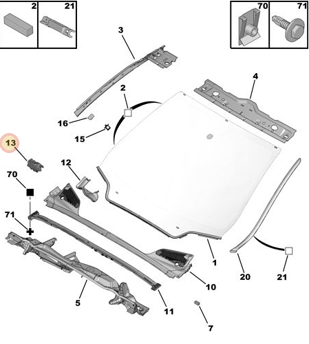

(13) Foam
Right, part: 9809092980, £17.78
Left, part: 9809093080, £17.78

Thanks yet again Marc. When you refer to left side and right side, I assume that for a UK market car right side is driver's side and left side is passenger side.
- x 6963
Re: C4 VTR 2013 Brake Issue
Yes, that's correct Dai - so left and right as from the point of sitting inside the car.
