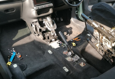

Hi - hoping someone can help out here as I'm struggling to find anything on the internet. Recently bought a lightly-bumped C3 Mk3 1.2 67-plate and completed all the front plastic/lights repair. The ESP light is on and the garage reported codes U1213 (ABS/ESP invalid) C2503 and C263D (Yaw speed sensor). I'm assuming the yaw sensor didn't appreciate the bump and needs replacing, but totally unable to find it! I've taking up the centre console and removed both seats as other posts suggested it may be under the handbrake or passenger seat, but nothing there - only the airbag sensor in front of the handbrake. Any advice on this would be very much appreciated. Thanks!

Those aren't valid PSA codes by the looks of them, so can't help you with those.
When the airbags have been triggered, the airbag ECU switches to locked mode. This means the pyrotechnic components triggering information and the impact conditions are saved and the faults cannot be cleared.
This is for safety reasons and a new Airbag ECU should be fitted and configured in cases where the car will be used again.
The yaw sensor is integral to the airbag ECU positioned in between the handbrake lever and the gear surround.
