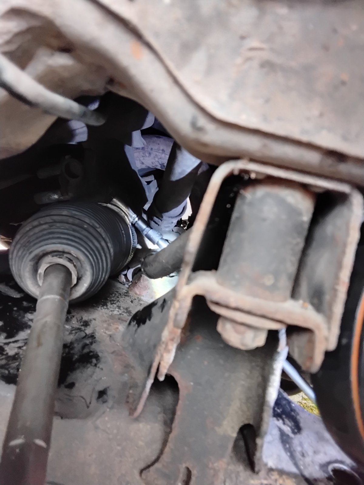

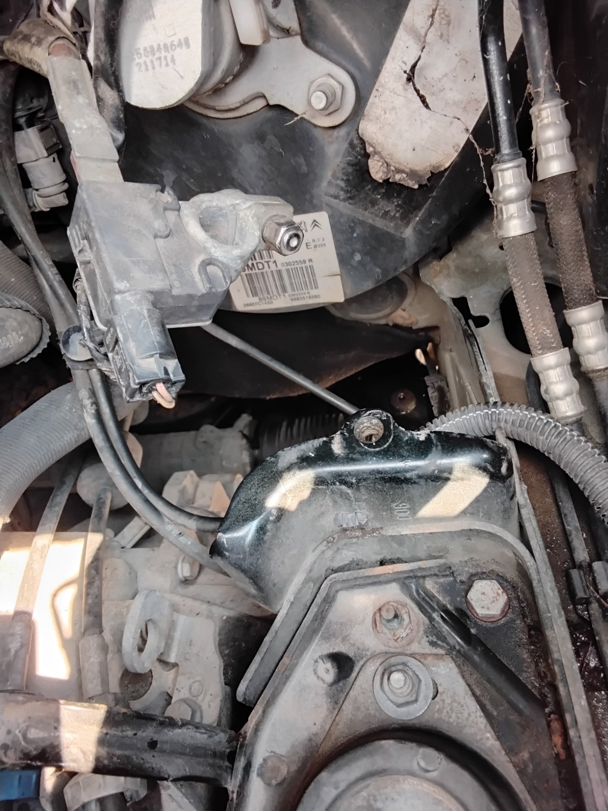

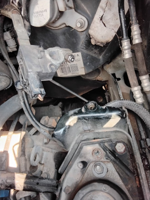

Ok, not sure if this is good enough , but space was hard , i have jubliee clips on order so can swap out this tie for a clip , what does anyone think ? The tie is very tight.

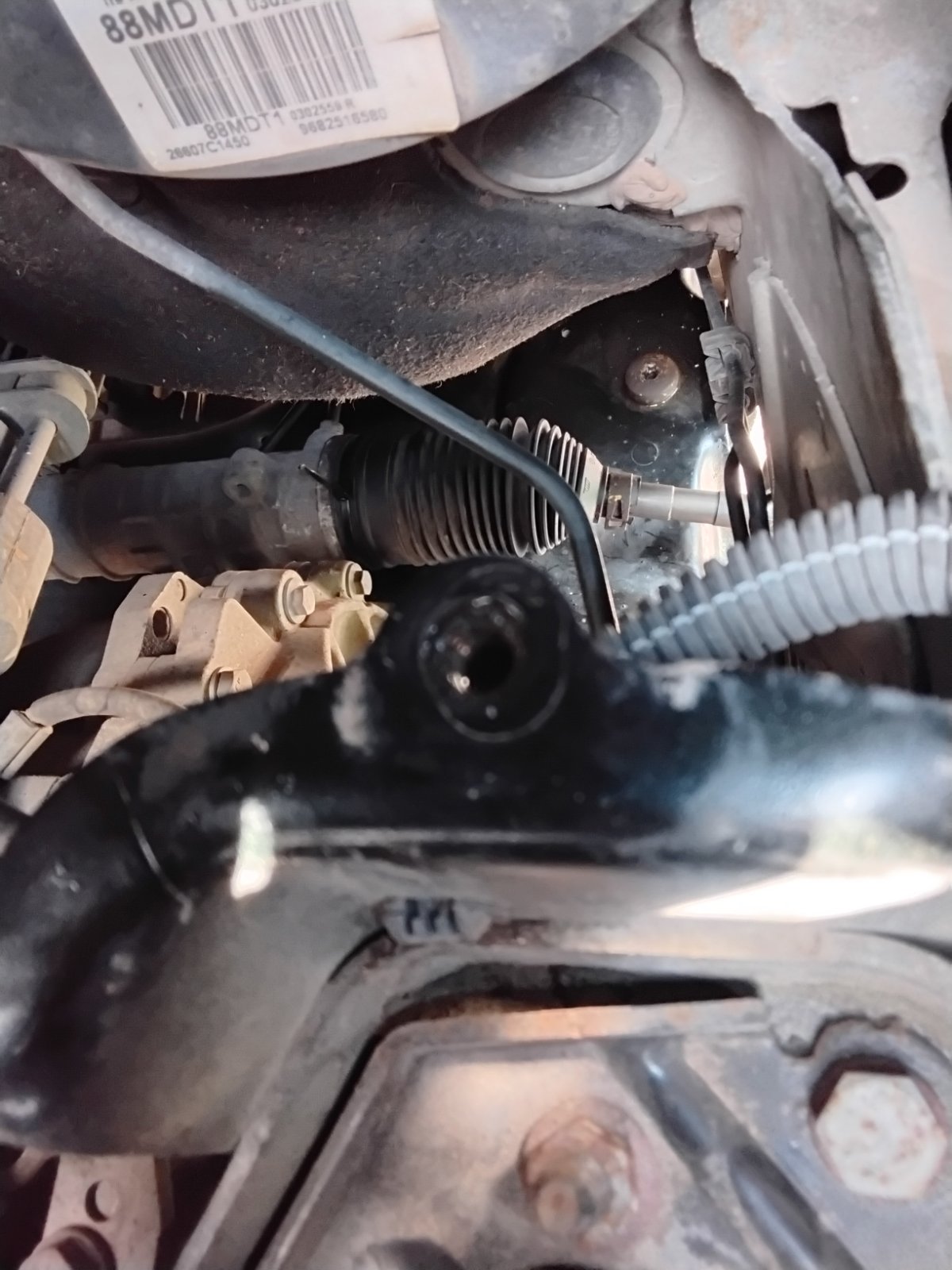

Heres a bit better angle of the cable tie

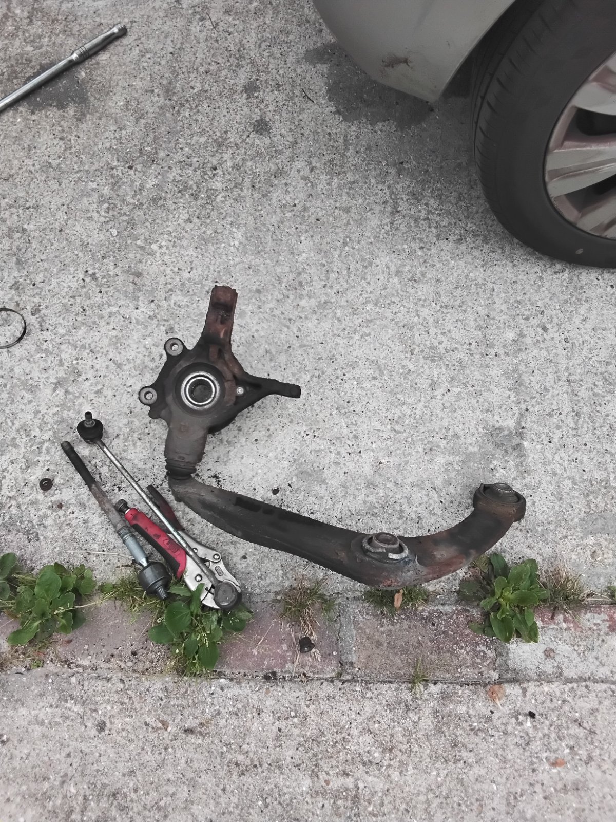

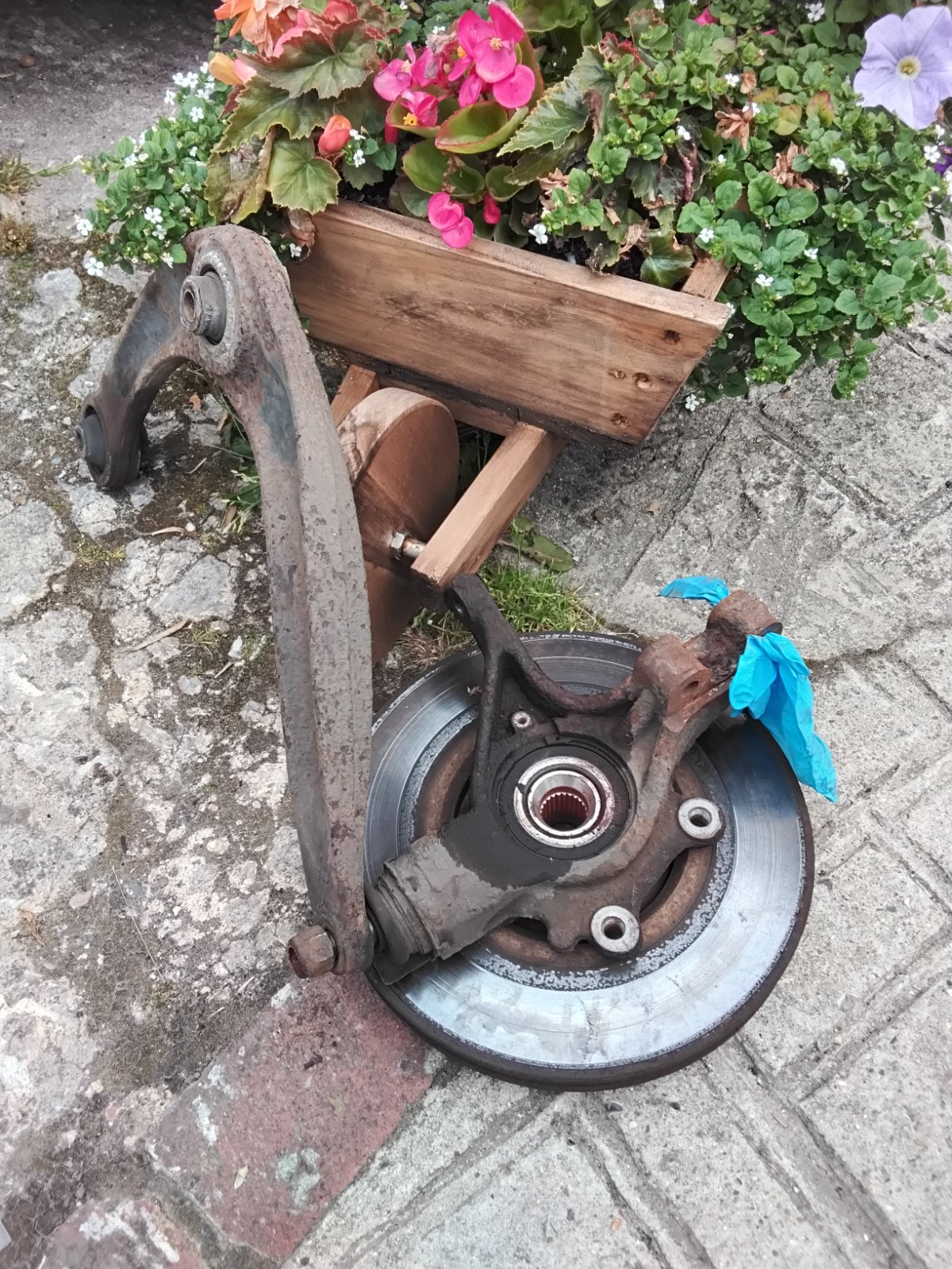

Tested the rotation of the hub it turns a quater turn then almost locks up , i will pressed the old bearing out as i want to see how bad it is. I did drive the route with said pot hole . The hole is over 5 inches deep on a bend to the left which you dont see till its too late.

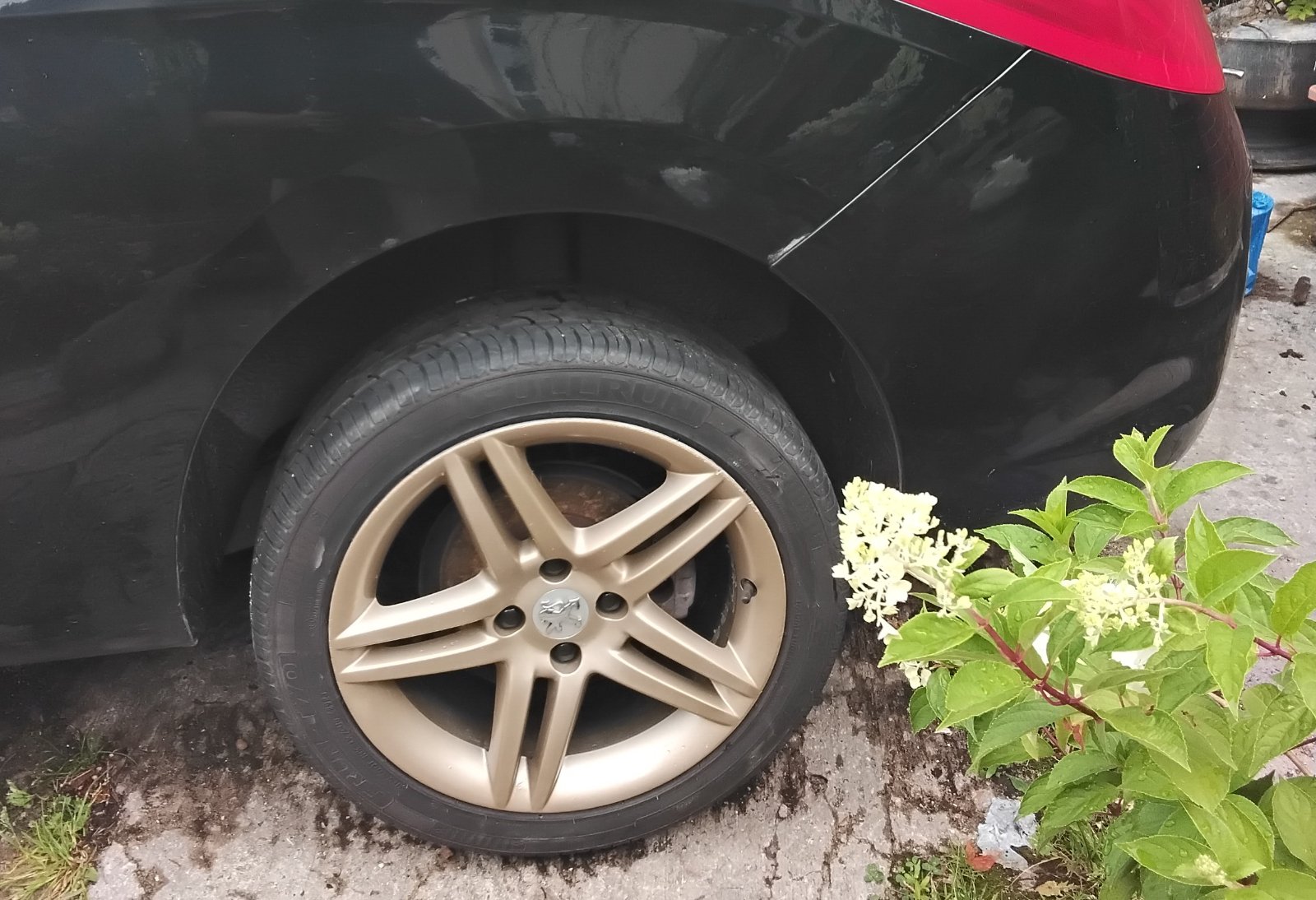

Rattle can job.. Zink primer 2 coats, 3 gold matt top coat followed by 3 coats of clear coat . Looks ok to me. The water marks on the wheel were what flicked off the plant in the photo.

Cars all done , wheel is ok ive put a level across on as many directions as poss and compared it to the other side and everything looked the same so i was lucky , unlike the old 207 i had that did get damage to the wheel , But getting back to clips i found one in my shed as i was finishing the driver side today it was a perfect fit , then had to pop to the hospital for a few hours & when i got home there was a small parcel on the door step , clips !
So with that i took the cable tie off the passenger side popped on the clip sent it home as shown by the photos & thanks to Matts advice plus mick , Job done.

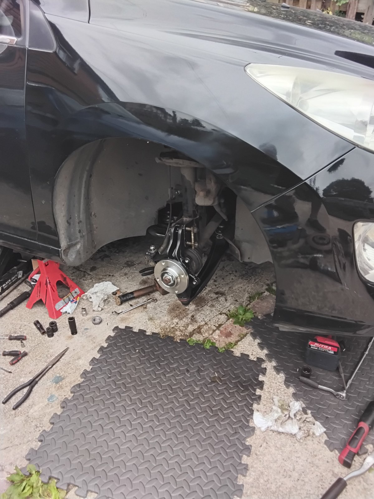

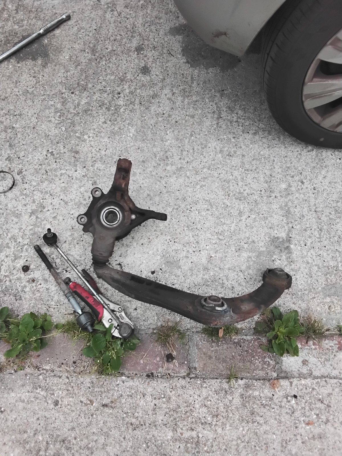

These were in need of change

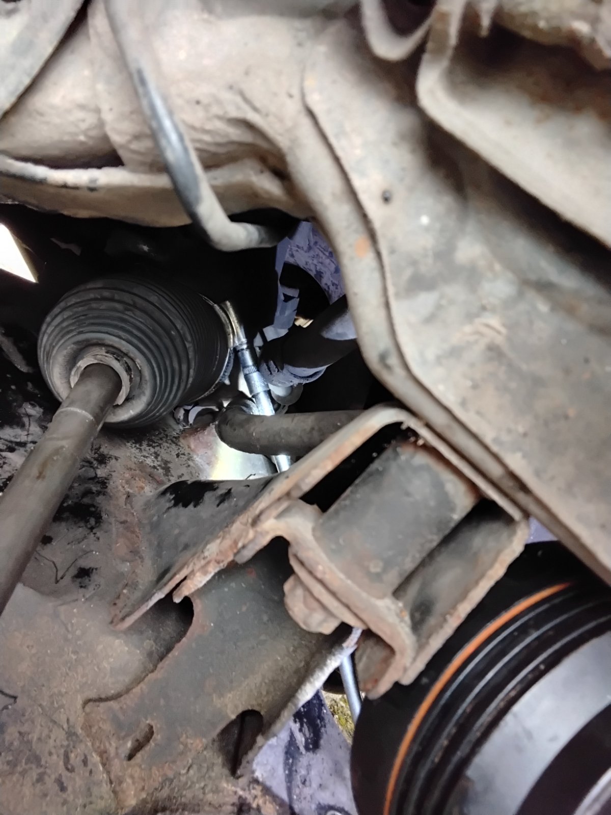

Inner tie rod see speacial tool link a bit further back on this thread.
