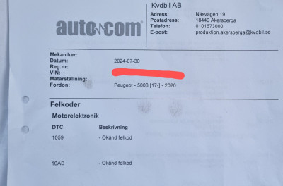

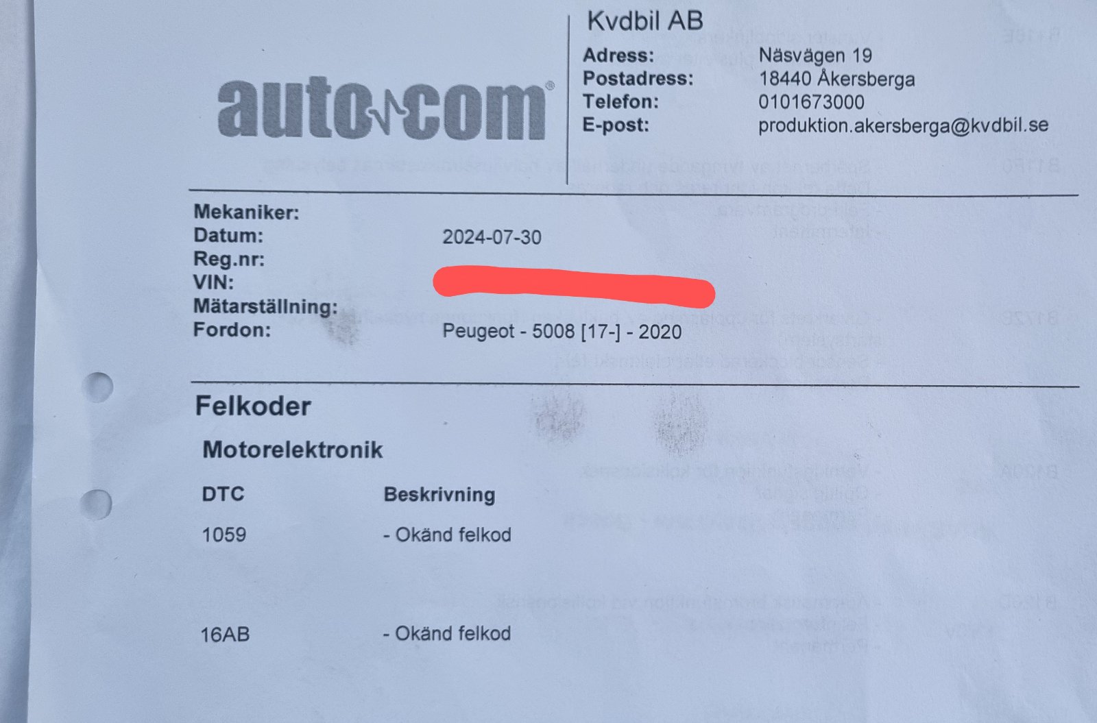

I did not bring my computer with servicebox offline so could not check it myself. So the error codes are from an auto-com system, but it could not decode the manufactory codes. See attachment. Motorelektonik is Swedish for engine elektonics
Okänd felkod is Swedish for Unknown error code
The Traction Battery charges and the car runs on hybrid using all engines. But it always keeps the ice running, i checked the auxiliary battery in the trunk and it had only 2.5v so maybe that is the culprit.
Does the auxiliary battery change from the ice or traction battery? Maybe both? I want to test if its the charging or the battery thats at fault. I have it on charging during the evening and will see tomorrow.
Any input would be helpful.
I will arrive home tomorrow evening and connect offline servicebox to see what it says.
