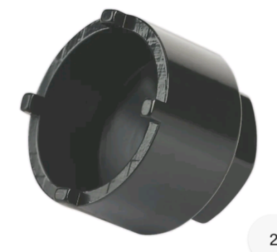

RichardW wrote: 13 Apr 2024, 20:57 Those screwed in joints can be a mare - needs a 41mm very deep socket, and sometimes the thread is no good and they can be very tight. I find it easier to remove the hub and get it in the vice.
Ah, thought had added complication of a special tool with prongs on, like this:
https://www.ebay.co.uk/itm/141461392455?
Picture from eBay advert
I'd not had a close look at the 308 and spotted a hex fitting.
Having said that, 41mm is well beyond my normal set!
