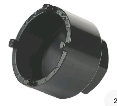

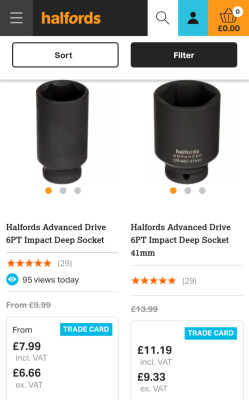

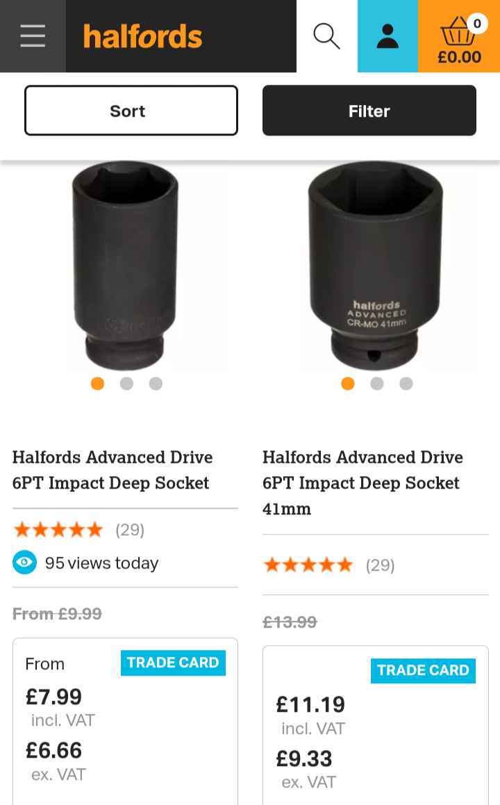

Ah, thought had added complication of a special tool with prongs on, like this:RichardW wrote: 13 Apr 2024, 20:57 Those screwed in joints can be a mare - needs a 41mm very deep socket, and sometimes the thread is no good and they can be very tight. I find it easier to remove the hub and get it in the vice.
https://www.ebay.co.uk/itm/141461392455? I'd not had a close look at the 308 and spotted a hex fitting.
Having said that, 41mm is well beyond my normal set!
- Posts: 5308
- Joined: 25 Apr 2022, 09:03
- x 2341
Re: 206cc to a 308cc How ? Why ? Everything 308cc
41mm deep impact socket, half inch drive, £8.95 free p+p
https://www.ebay.co.uk/itm/323333916435?
Not too bad cost wise
- Posts: 5308
- x 2341
Slightly cheaper if have a Halfords trade card
Just checked= both are half inch drive, not sure on differences between these two!?

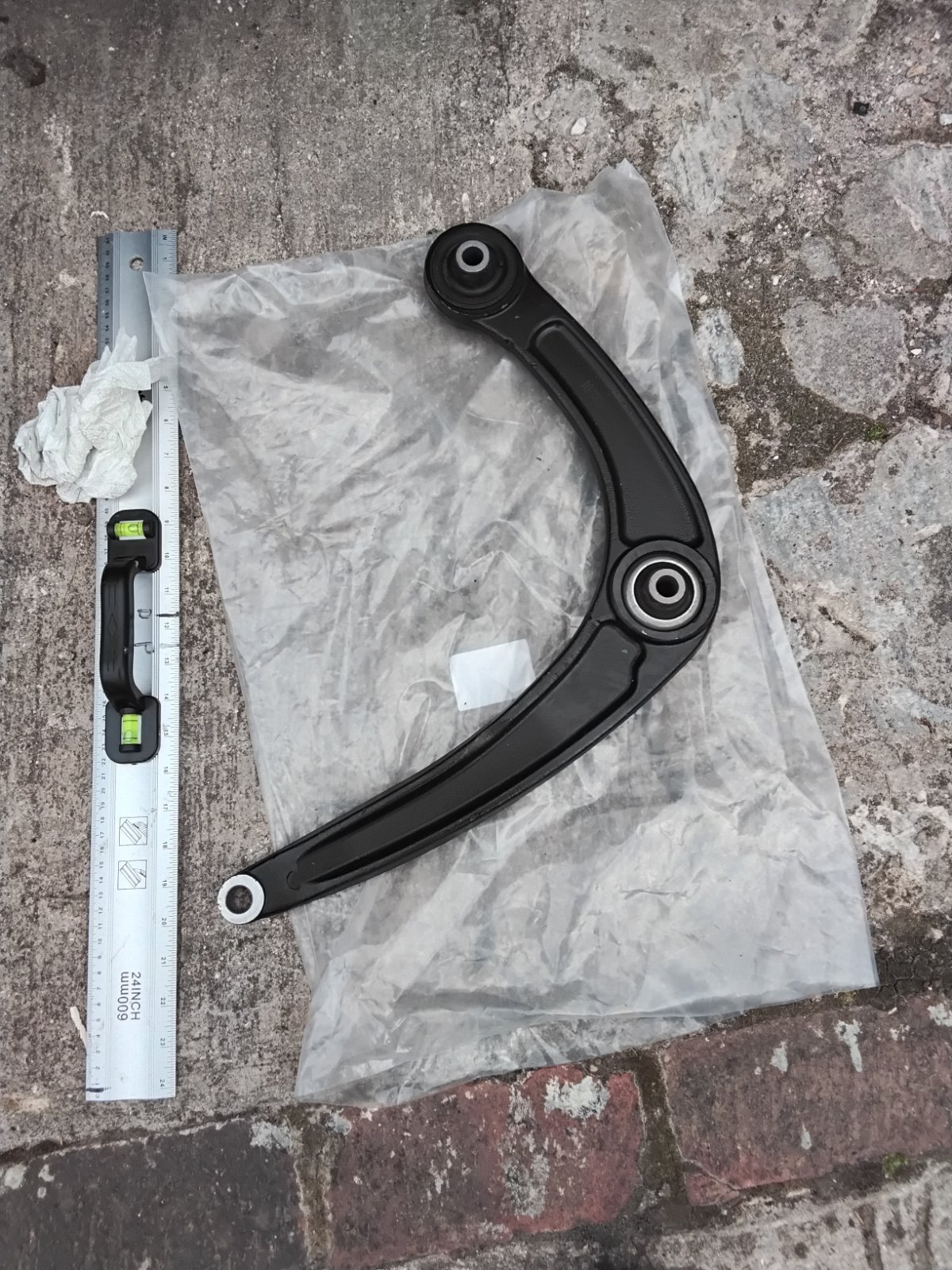

To do.
308cc vs a blind pot hole =

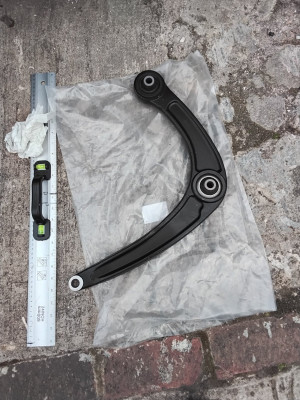

Inner tie rods , lower wish bones , lower ball joints , just checked and cross referenced prices for wheel bearing , hub , carrier , vs the faster way , which is going to cost more , but ive decided to buy complete hub & carrier then i can pop the new lower ball joints in , get the inner tie rods done with everything out of the way then , pop in new lower wish bones, pop the hub carrier back on fit back drive shafts , do drop links , upper tie rods , and so on and so on , then i know its all new , wheel alignment is easy . My string method is pretty good each time ive gone for a free wheel alignment check its been ok . Just got to wait now for the parts , i have most of them , just need these new carriers with the hub & bearing all ready in , then repairs can be sorted . Back soon with more updates.

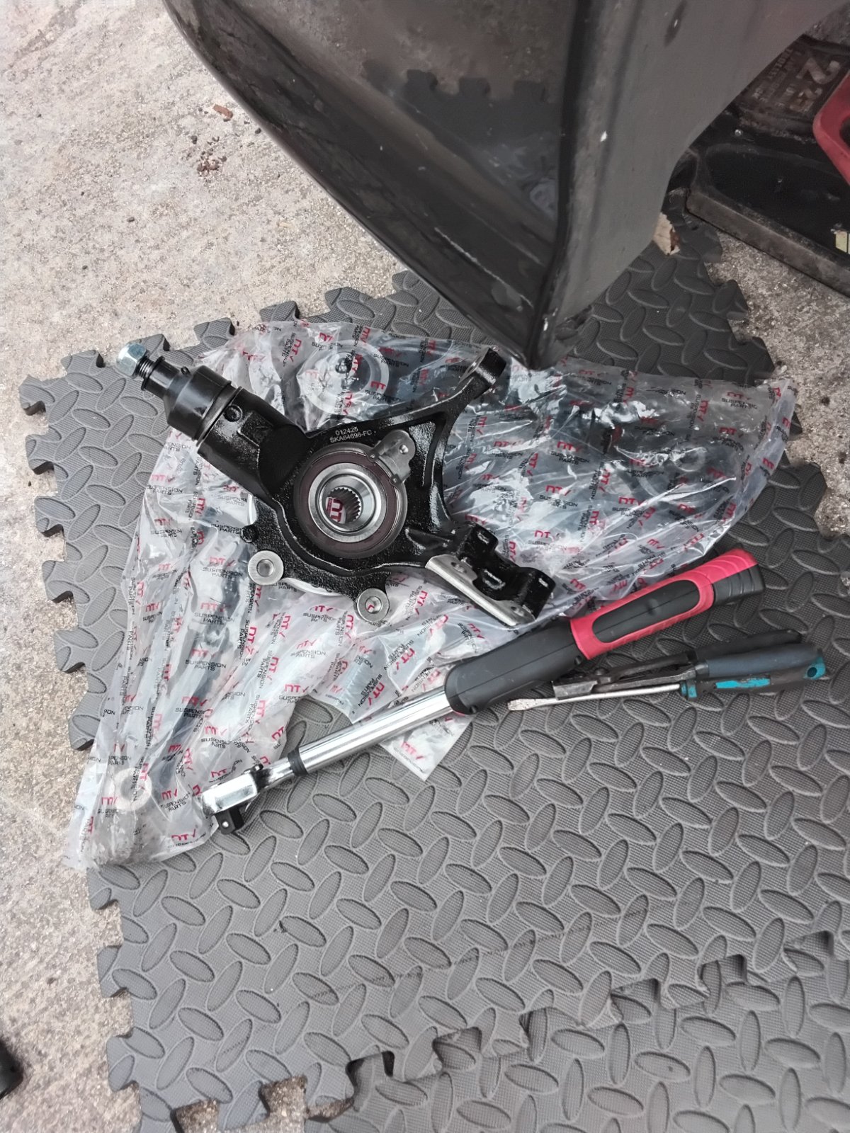

Just got the complete hub carrier set up for both sides cheaper than the main dealer but still almost £200 lighter in the pocket for a Monday morning isnt really want you want is it. Im not bothering claiming off there council where it happend if there anything like mine it aint gonna happen. Tight as rusted on nut . Updates will follow

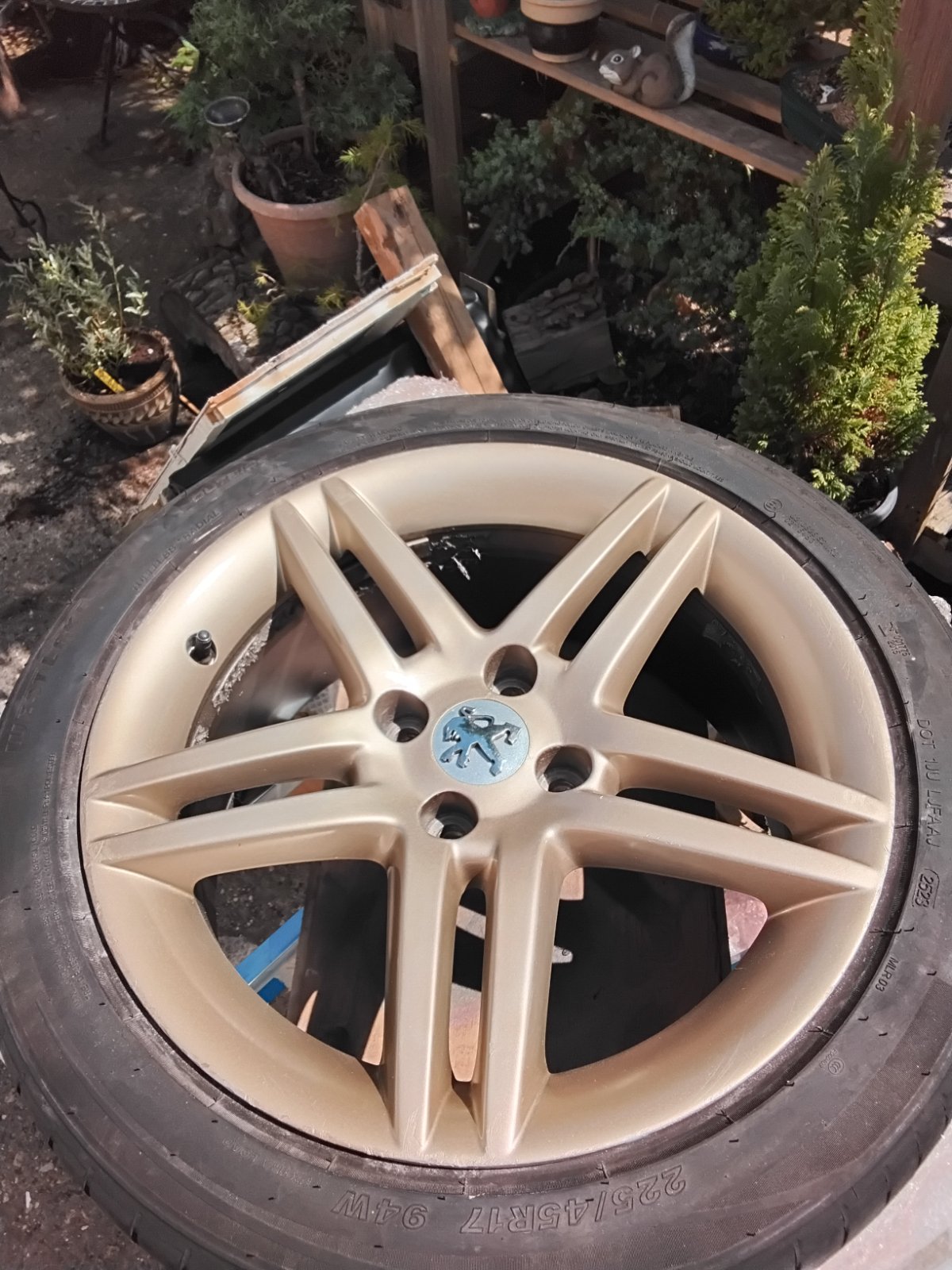

Home D.IY Refurbing the alloys too just a quick job making them look a bit cleaner .
Im not a pro, time is limited too but for me this looks better than before.

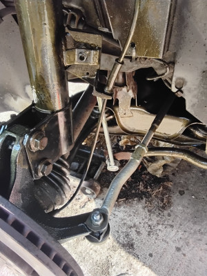

No order , by if Matt sees these then heres a way of not bothering to undo that big big ball joint ...... but only if your refitting all new stuff back .. oh the car parked up on a early summer eve at a private hotel me & the lovley wife stay at for a few nights..i want to got back !
Husky.

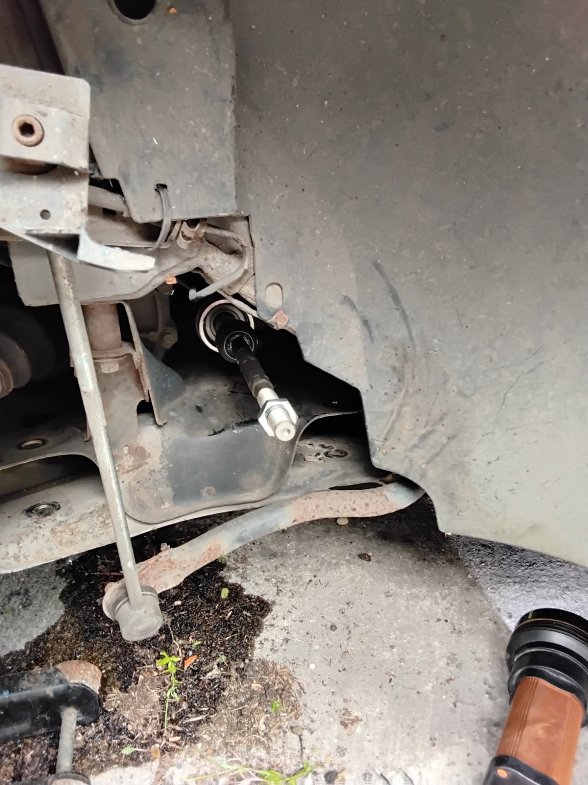

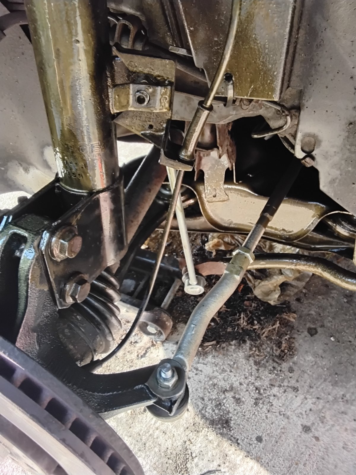

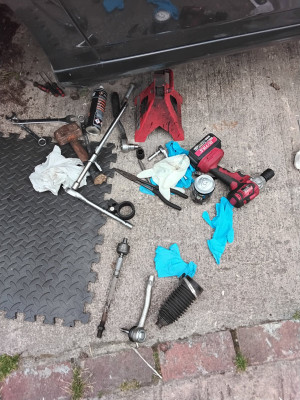

Ns all done , just need that boot and clip back in place , ive seen a route from the top via removal of battery and so on..

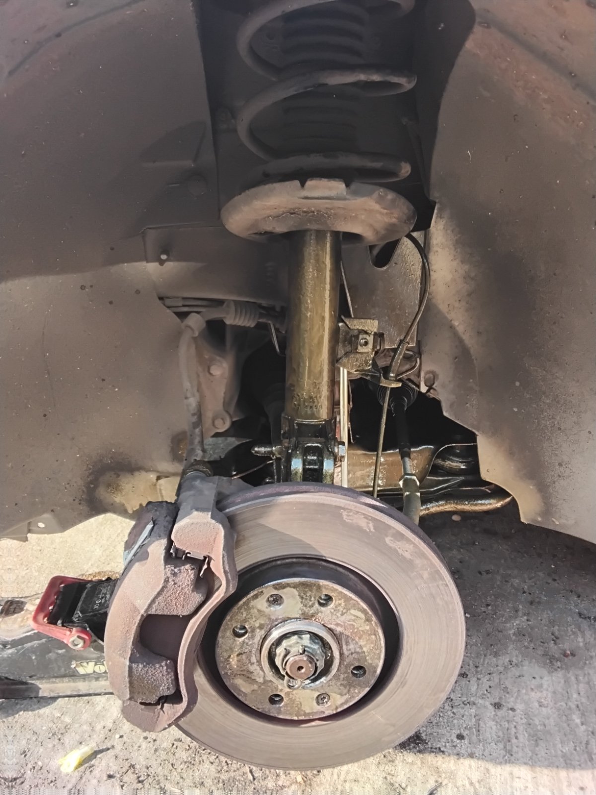

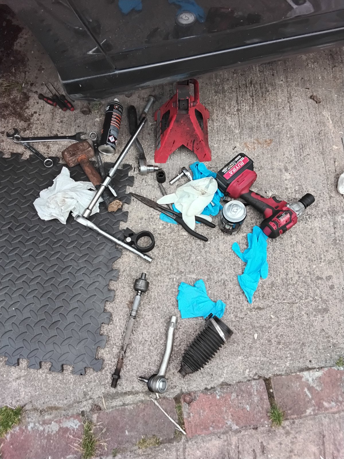

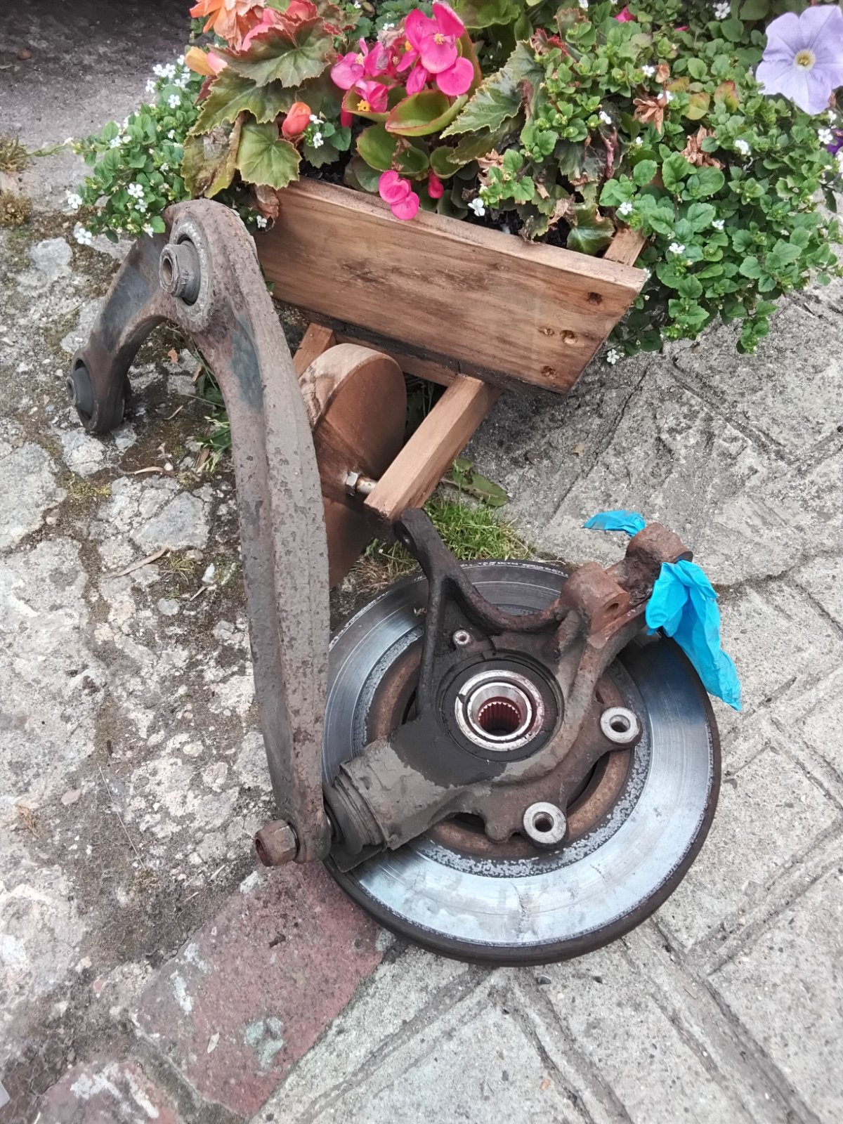

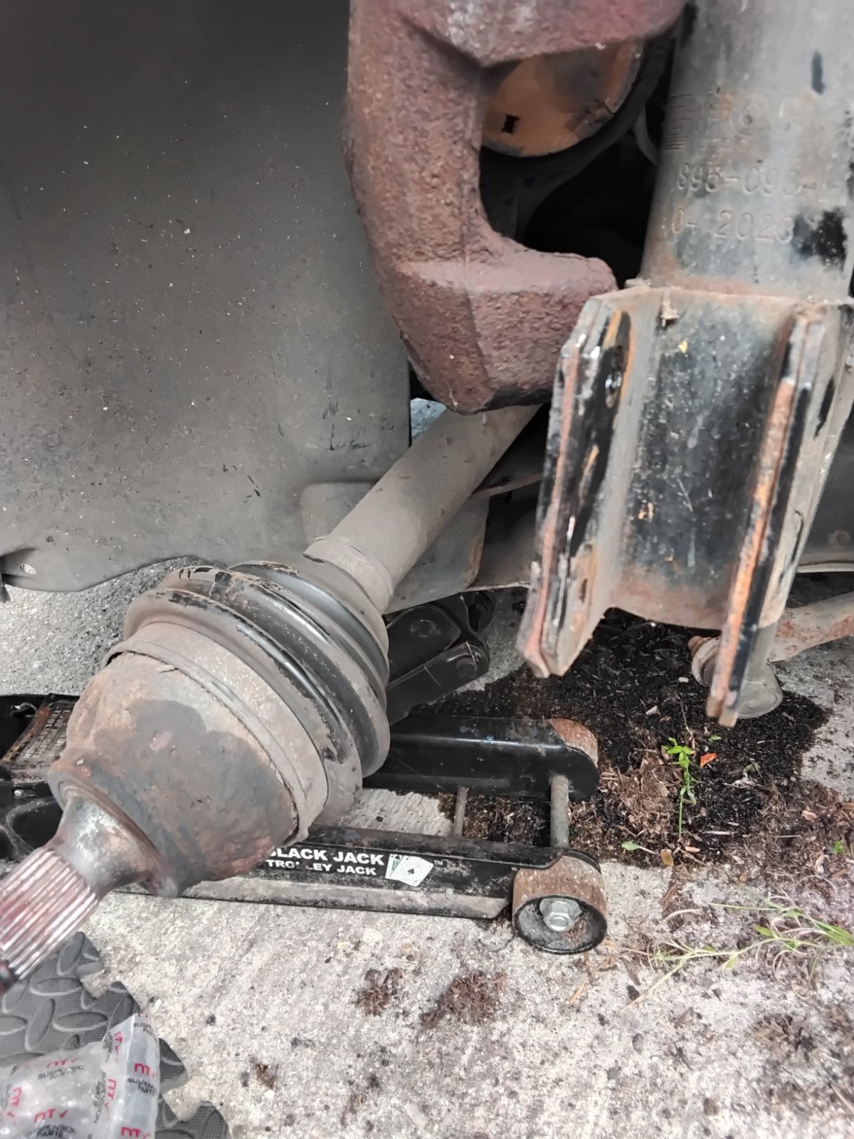

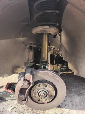

All new strut , spring last november, now lower wishbone , ball joint lower, drop link. Knuckle & hub , im knackered. Really pushed mysepf today and feel it now lol
Excellent pictures Husky! If you've been doing all that in the hot sunshine, it's no wonder you are knackered! It's hard work in the hot weather.
