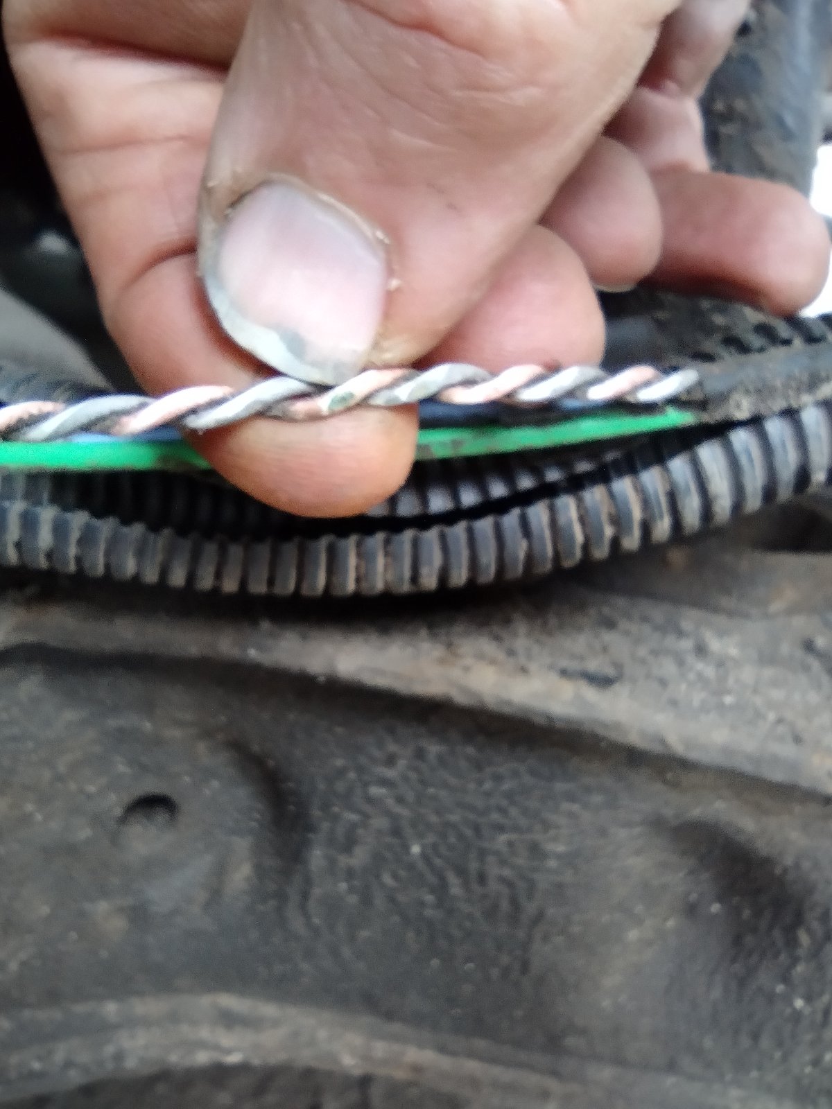

The first suspect on these for any speed sensor related faults is the wiring to the rear ABS sensors that rubs through on the conduit. It's not too hard to check and worth a look if you don't have access to fault reading equipment. The problem area may appear small however!
RichardW wrote: 17 Mar 2024, 21:32
RichardW wrote: 16 Mar 2024, 20:50 Picasso light show....so I'm expecting a rear sensor fault and a corroded cable...
And so it was. Computer pointed to the LH rear sensor, and with the wire popped out the conduit, I spotted this
Seemed like it was just rubbed through and touching so I taped it up and put it back together....to be greeted with a permanent fault🤔. Stripped it back out, and put a connector in, wire just fell apart, I think I had scraped out all the copper! Trip out this afternoon and no warnings 😀 needs new rear pads though....

RichardW wrote: 30 Jul 2024, 16:52 The first suspect on these for any speed sensor related faults is the wiring to the rear ABS sensors that rubs through on the conduit. It's not too hard to check and worth a look if you don't have access to fault reading equipment. The problem area may appear small however!
Thanks so much, I can definately check them, that would be a result if it is that 😊 Thanks again
