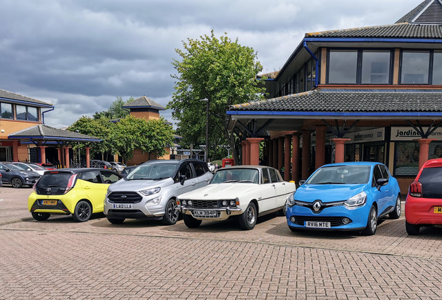

Today on "haven't cars got fat?"

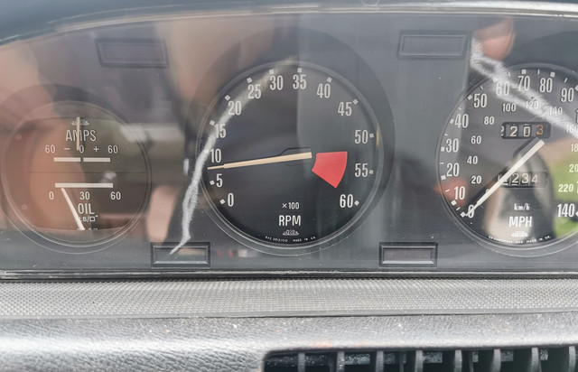

Disconnected the throttle linkage between the two carbs, then used the hose as a stethoscope to listen to each intake as I adjusted things until I got both the desires idle RPM and the same amount of air being drawn through both carbs. The linkage was then adjusted to compensate for the rest position now being slightly different (as predicted, the car was really heavily leaning on the offside carb with virtually nothing being done by the nearside one at idle) and reconnected.
Idle speed is sitting at 700-750rpm in neutral, dropping to 550-600ish in gear, which sounds reasonable enough to me.

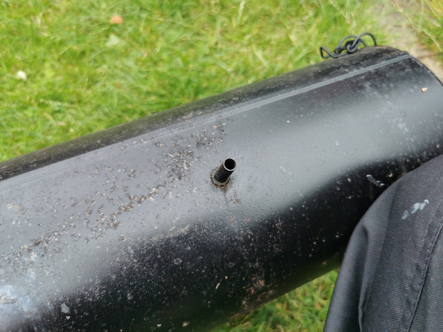

While I had the air cleaner off I took the opportunity to finally ask a question about what this unused hose connection on the back of the air cleaner is meant to be used for?
Given the surface rust on it I don't think it's had anything attached for a good number of years. Answers on a postcard?

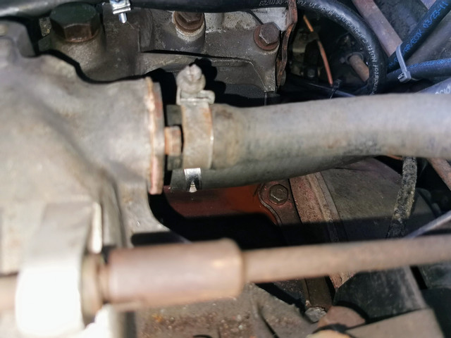

Evidently I do need to do some more leak searching on the cooling system as there's a bit of coolant which has gathered on the valley cover.
It looks like a lot there but one paper towel was fully able to soak it up, so not actually a massive amount. Those heater hose clips are both secure (the lower one is actually on there fine - the fitting the hose goes on to extends a long way into the hose). I'd be tending to look more suspiciously at the thermostat housing or the connection up front to the lower heater hose as they're really quite awkward to connect up as there isn't much space to play with.

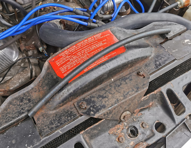

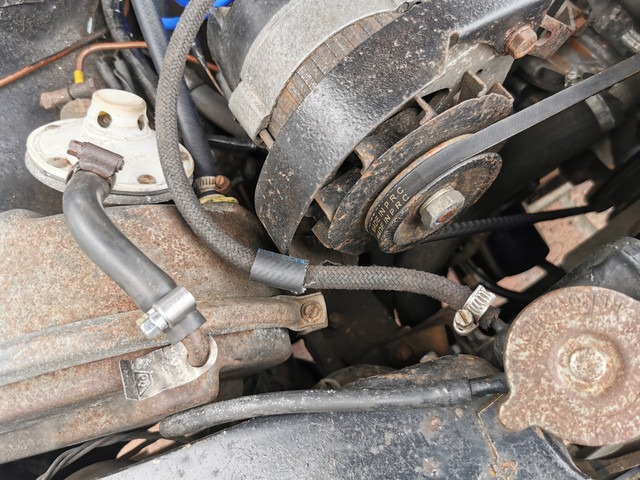

Last thing I did today was to provide a bit of protection for the coolant bleed line that runs between the top of the intake manifold and the top of the radiator.
This was chafing on the alternator belt shield - and given the direction the fitting coming off the radiator points I really don't see how it's meant to go anywhere else.
I realised when going to secure this though that I'd somehow actually managed to run out of zip ties...so securing it properly will need to wait until I've had a chance to pick some more up.

I saw just how fat cars are now when I washed my AX and C3 yesterday... The AX is like washing a matchbox... The C3 is a small car by todays standards but seems to have about three times the surface area!

CitroJim wrote: 13 Jul 2024, 05:30 Looking good Zel :D
They also seem to have so many...I don't know how other to describe them than "really fiddly bits" which make cleaning the car way harder than it needs to be.
The Audi TTRS that Chris had a couple of years back wasn't very big, but it was incredibly time consuming to wash. Took me nearly as long as both of the cars next to it. Thankfully I don't think we'll ever be seeing another one of those as it was a perpetual problem child and had very few redeeming features.
Granted, the front of the Rover is a right faff too, that grill may be iconic but it's also really fiddly.
I'm pretty sure when I get around to giving it a proper polish I'll realise how small a car it isn't as well. Guess at least I don't need to do the roof!
