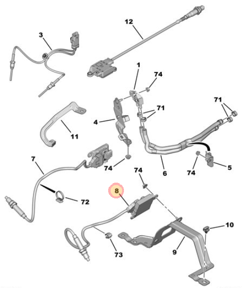

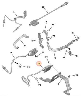

Re: P2A00
Hi. Thanks for your Forum Donation.
Ok, so your vehicle is a Euro 5 emissions standard, so does not have all the additional sensors with later Euro 6.* vehicles, so please understand that there are sensors shown on the diagram that your vehicle does not have fitted.
Your vehicle only has 1 NOx sensor (downstream), so this is the one I suspect that needs to be checked.
The NOx sensor is shown at (8) and is part number: 9821120980, £416.80 inc. UK 20% VAT.
- x 6954
Re: P2A00
Hi
Yes this can be confusing as your engine (DW10FD) is a Euro 5 standard, but the overall vehicle is Euro 6.1. So it can be confusing, but as mentioned you don't have (7) Upstream NOx sensor or (12) Soot Sensor fitted to your vehicle.
