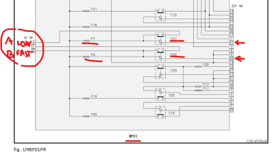

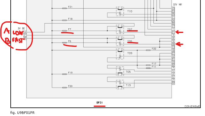

This is how the two relays for the fans are driven by the p21 and p28 pins in connector 32V NR (BF01 fuse box) but I don't understand the schematics as where do this pins are connected, in wich ECU.

One fan will always be on with the A/C, but as for the other one, it probably does not require being on (to save energy) unless the engine temperature is very hot. I'd leave it alone.
