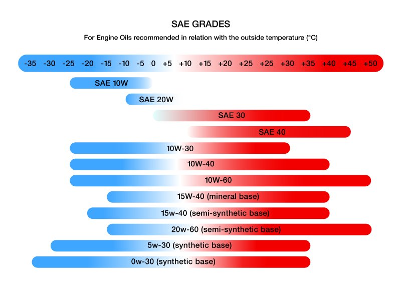

I'm sorry Marc, you've done an amazing job on that chart/S. My brain unfortunately doesn't understand it

I've moved this out of the Parts Thread as it's getting more of a separate topic.
Basically your engine can take any of the grades I listed. For an idea of the one to use, see the chart above which shows the protection range of each.
Basically when oil is cold it is thicker and thins as it heats up.
So a 05W30 oil would provide protection when the outside temperature is from about -25°C to +40°C
