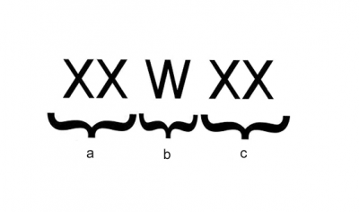

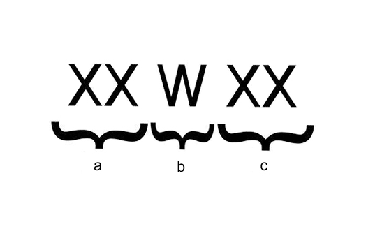

Grade of Engine Oil
The grade of the engine Oil is defined by the standards of the SAE (Society of Automotive Engineers).
The Grade of an Engine Oil is Represented by XX W XX
Key
  1. Digit or number corresponding to the grade of the engine oil when cold (the small the number, the easy cold starting will be).
  2. Letter W for winter.
  3. Number indicating the grade of the engine oil when hot (the higher the number, the more the engine oil will resist high temperatures and remain viscous).
An engine Oil is developed to be highly efficient over a considerable temperature range (for example: 0W30 applicable between -45 and 45°C).
Note: The grade of an engine oil is not linked to its performance with ageing, soiling or wear.
Example: A 5W30 Oil is not necessarily more effective than an 0W30 Oil and vice versa.
