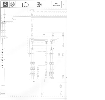

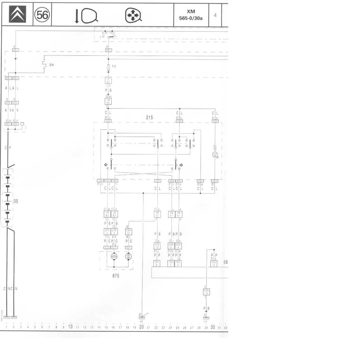

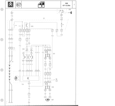

Re: 2000 XM Front Window not working
I probably have these diagrams, I will look tonight.
- Posts: 10939
- Joined: 09 Nov 2005, 22:03
- x 1450

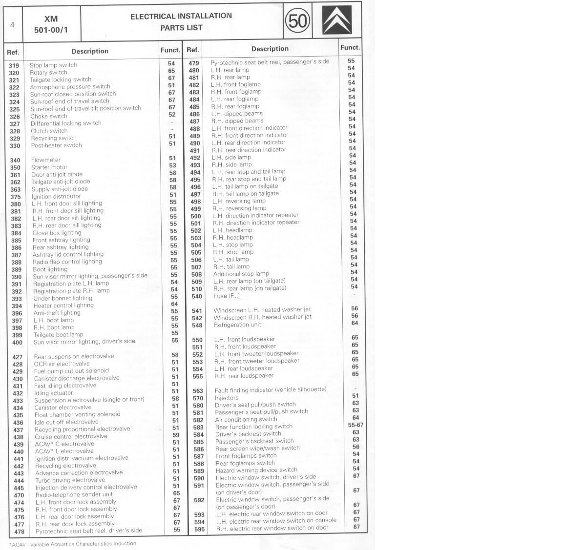

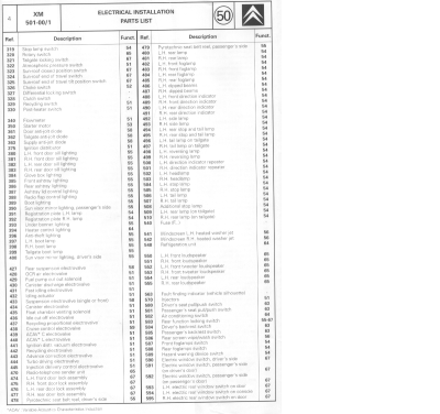

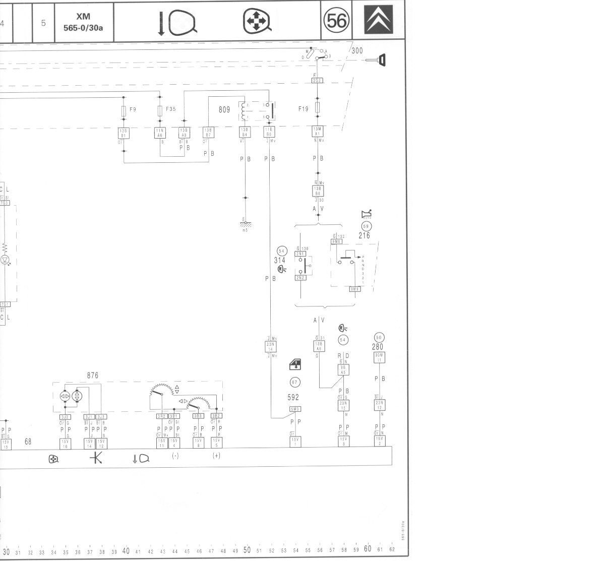

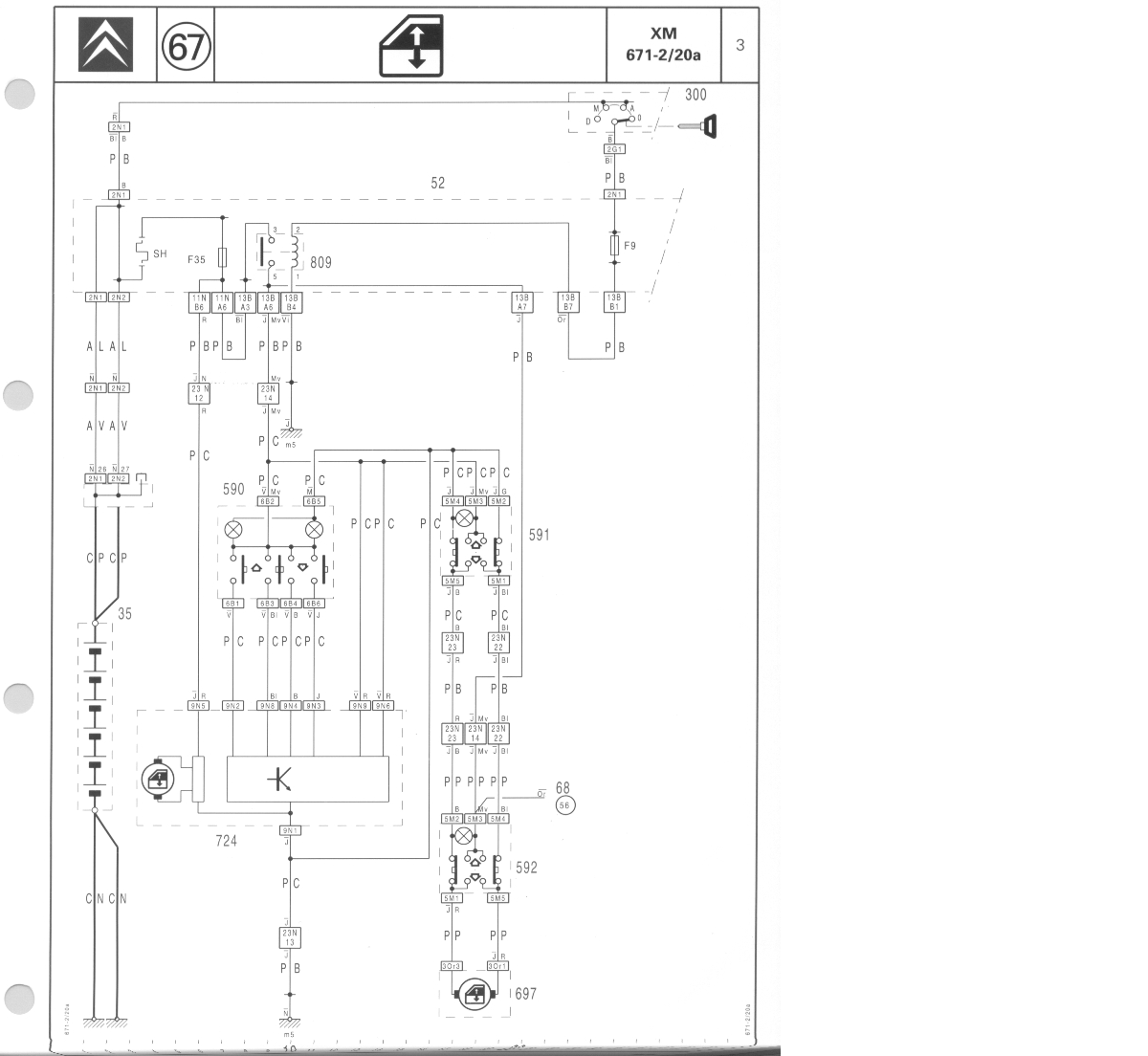

Here are the diagrams for front windows (one-touch) and mirrors a late Series 2 XM. I believe them to be correct for RHD.
Good luck!
Good luck!

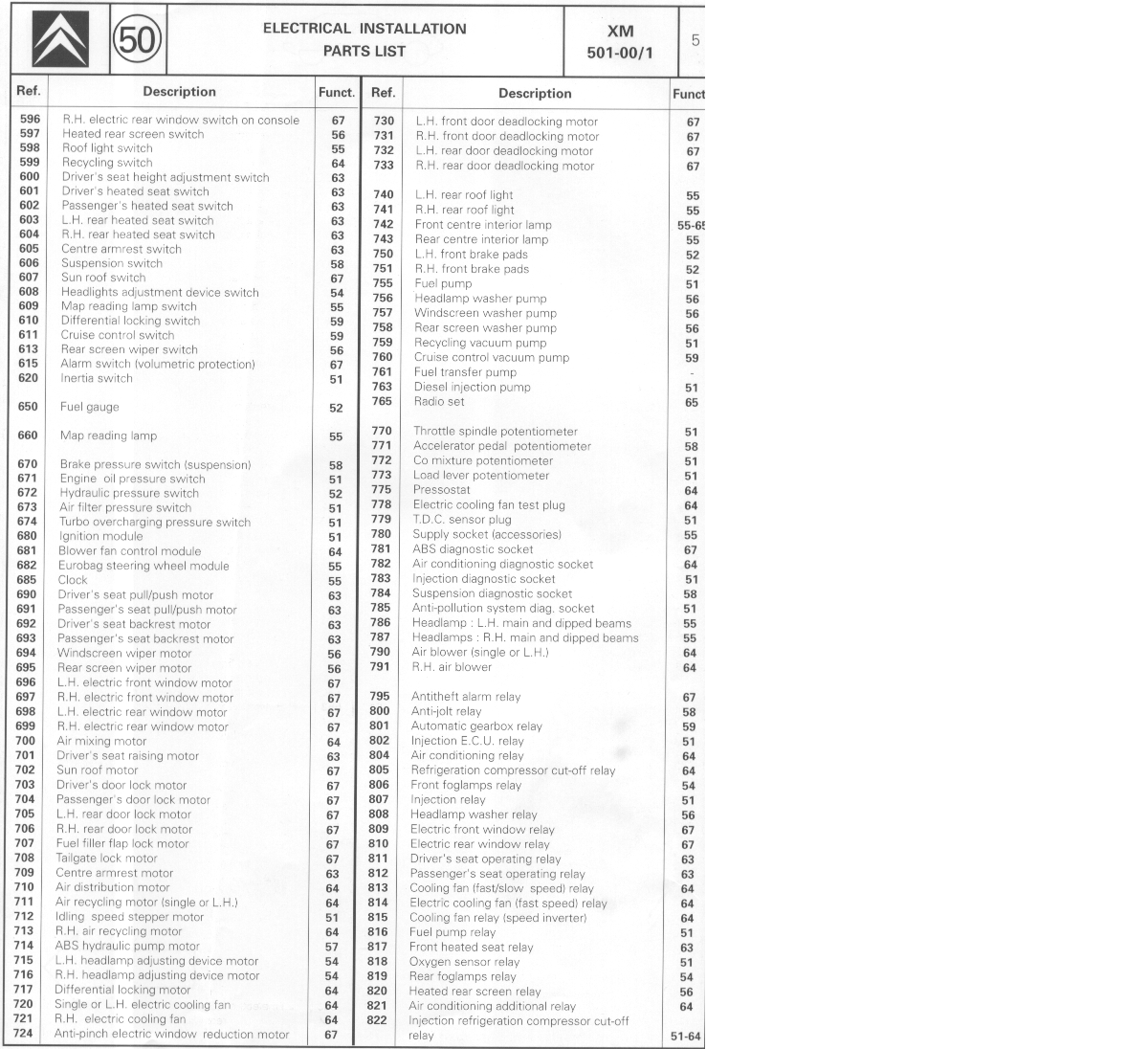

Thank you very much

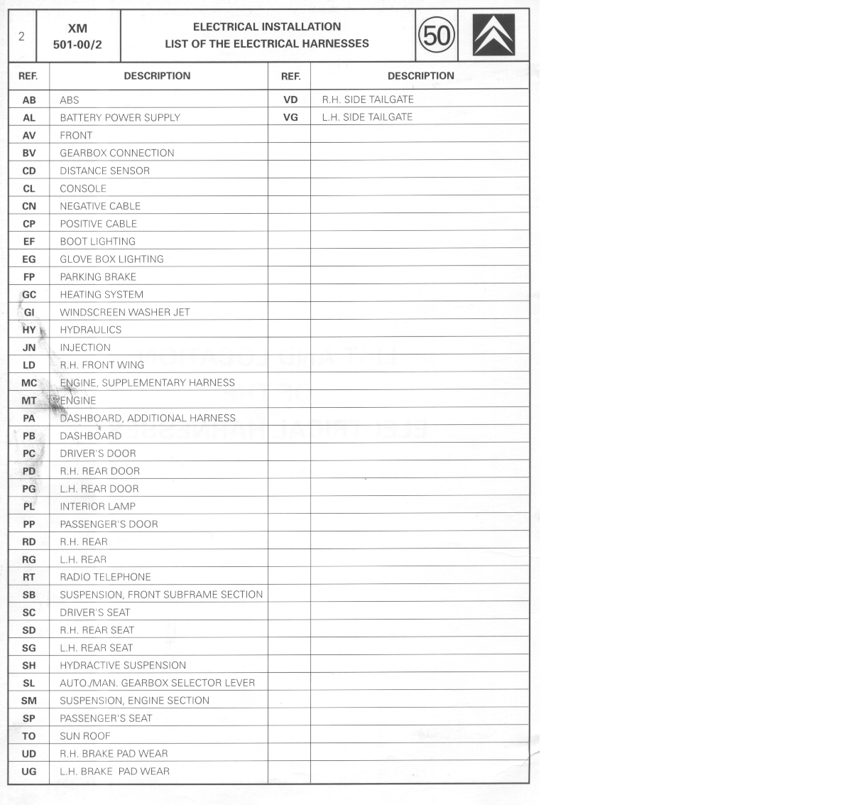

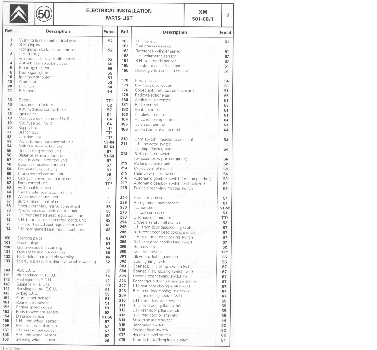

You don't happen to have the key for the diagrams showing what things are, do you?

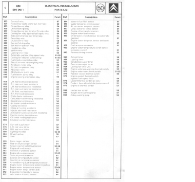

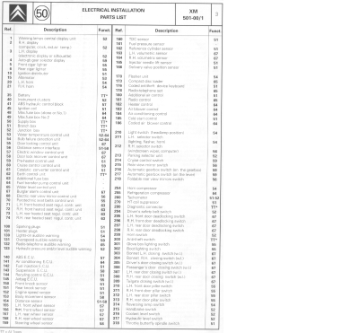

- x 6956
David
With the exception of the wiring codes, most of the component codes are indexed here:
PSA Electrical Diagrams - Wiring & Symbols Codes Index
The main index tables link directly to the relevant section as described
Each page has a link at the top to take you back to the main index.
All the diagrams and images can be zoomed by clicking on them
Hopefully these will cover most areas.

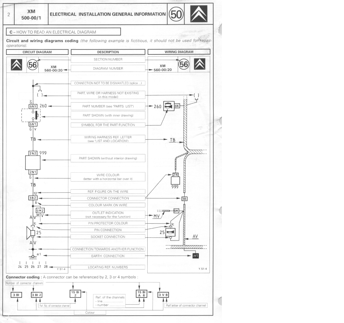

Here are some general pages on the XM wiring diagrams. The general format is I think similar to earlier cars, but different from the Xantia and different again to anything later.
Brilliant. Thanks so much.
Just wanted to say thanks for these diagrams.
I didn't want to take the door card off so knowing where to test for power at the switches and test for continuity between the drivers door and the passengers door was a huge help.
In the end I took the passengers door card off and checked for power at the motor plug, there was power there so I cleaned the contacts with some contact cleaner and a tiny screwdriver and after putting it back together the window is now working.
