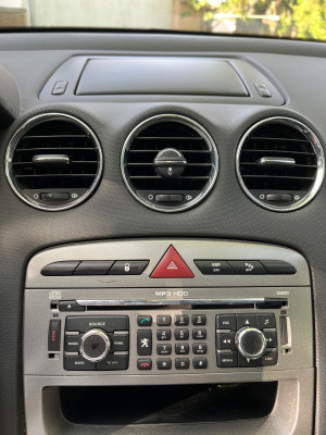

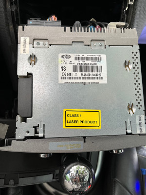

Hello,
I am confused with my navigation in Peugeot 308 sw T7:
Based on viewforum.php?f=44 it looks like RT4:
but on sticker it say it is "RT3 T7-N3" :D
So what kind of Frankenstein I have?
My VIN is VF3**************[VIN obfuscated, can be read by forum staff]
EDIT:
one more information - I can not see Device information (Firmware...) by holding "Menu" button. I only get "Help" menu after holding MENU button for three+ seconds...
x 6957
Re: Identifying Your RT3 Unit
Hi, you have an RT4 which is basically an improved RT3, so don't worry about it.
Unread post by bulkier »
GiveMeABreak wrote: 03 May 2024, 20:55 Hi, you have an RT4 which is basically an improved RT3, so don't worry about it.
Thank you! Now I know in which subforum to post question about it... :)
