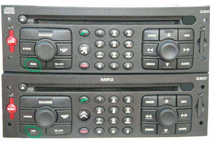

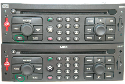

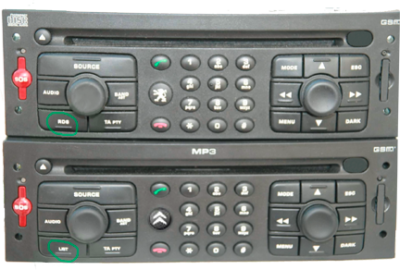

On the Mark I Citroen C5 up to 2004 and prior to the facelift, there were 2 versions available. One was designed to work on the VAN Network an the other on the CAN network.
You can identify them from the following buttons circled in green. On the front of the head unit, under the leftmost rotary dial you will have a button next to the one that says TA PTY that says either LIST or RDS.
If it says LIST the RT3 will be operating on the CAN network and should be on version 6.xx of the firmware.
If it says RDS the RT3 will be on the VAN network and should be on version 5.xx of the firmware.
The 2 firmware versions are not interchangeable. I.e. if your system information says software version 5.xx you cannot apply the firmware for Version 6.xx and vice versa. Confirm this by checking the version in previous post via Menu / Device Information.

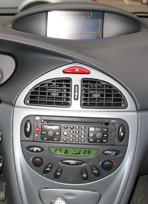

Is your a Mark II / Facelift? The above is for a C5 Mark I only with with RT3 Navidrive.
The Mk1 also had either RB2, RD3, RT2 or Windows CE.
Citroen C5 RT3 Navidrive System
