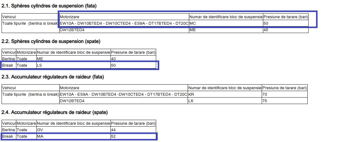

Each sphere has a specific design pressure. Regassing to some unspecified pressure of 50+ bars will not.result in correct suspension performance.GolfMk1Vr6 wrote: 24 Apr 2024, 20:51
All spheres removed from the car had between 30 and 40 bars. They were filled with 50+ bars.
GolfMk1Vr6
- Posts: 54
- Joined: 13 Jan 2024, 21:02
- x 2
Re: Stiff suspension after spheres regassing - C5 X7
For my car, these are the required pressures for each sphere:xantia_v6 wrote: 25 Apr 2024, 08:55Each sphere has a specific design pressure. Regassing to some unspecified pressure of 50+ bars will not.result in correct suspension performance.GolfMk1Vr6 wrote: 24 Apr 2024, 20:51
