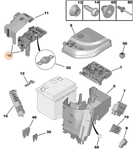

Hi Marc, I have made the donation. Vin is: VF3**************[VIN obfuscated, can be read by forum staff]
- x 6955
Re: 3008 Battery module
Hi, thanks for your Forum donation Tim. If you need any part numbers in future, just post your request Here.
(10) Protection & Management Unit, part: 6500GQ, £317.65 Inc. UK VAT @20%.
At least with the correct part number you can search and maybe source a cheaper one.

Hi Marc, thanks for that. as I said in my original post the new price is ridiculous, especially for a substitution to see if it's what's needed!
That part number comes up as being for a 308 and is exactly the same as the 2nd hand one I've seen, (€70), which says it's from a Citroen C4 Picasso 1.6hdi. Only differences are the "IND" on the Main label, (mine is "IND B" and the 2nd hand one is "IND C".), and the final line on the lower/smaller label, (mine is 10221 Q2, the 2nd hand one is 11172 Q3).
with reference to my original post, is anyone able to tell me if the 2nd hand one is suitable for my car, or what the Differences in numbers refer to.

As long as the main part number is the same, it will be fine. The other numbers are just revisions, but this doesn't require configuring or coding, so no issues there.
Just make sure you follow the BSI Reset / Battery Disconnect / Reconnect Procedure when disconnecting and reconnecting the battery.
