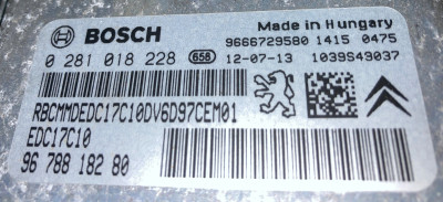

Sorry, I didn't know, but EDC17C10
Not much more information for now.
