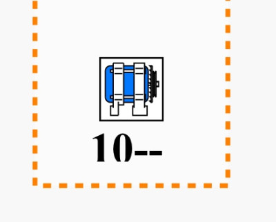

But now that we're writing, I want to hear from you why some numbers are only displayed as, for example, 10- -?

Anything with a ------ line around it means it is optional equipment and may not be installed on your vehicle.

I think that it is more correct that those are off-page connectors to other parts of the electrical system, and the 2 digit code indicates which system is referenced. For example here, 10-- is the charging system, 15-- is the cooling system, 16-- is the transmission etc.GiveMeABreak wrote: 18 Apr 2024, 17:06 Anything with a ------ line around it means it is optional equipment and may not be installed on your vehicle.

You need to look at the info I provided on the electrical diagrams, specifically here:
PSA Electrical Diagrams - Reading The Schematic Diagrams
Look at H, I & J on the example diagram.
'H' & 'I' are what Mike is referring to and 'J' means it's for optional equipment. So in your example yes, it's a link to another system. I should of paid more attention.

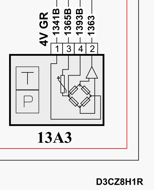

Knows how to interpret a chart and also knows what 1357 was. Was only wondering if it was a mistake that they weren't mentioned on the list, but could also be PSA that didn't state it, they are good at keeping certain things “ secret”, but
From 3 different diagrams I have found these missing, 0004 , 1283, 13A3 (A must be an error), 1356, 1357, 1361, 1362, 1374, 1405, 1604, 7095. I myself find the missing information when comparing other diagrams, either via connection or wire no.

13A3 is not an error. It is the inlet air temperature and pressure sensor.
That's why we use specific diagrams for each vehicle as different engines and engine management systems have different sensors and equipment.
