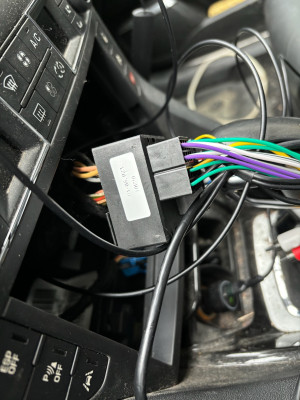

I have a 2010 Citroen C5 V6 3.0 Break. It has the original Harman-Becker 2 din head unit and the about 7” display. It has developed a habit to shut itself down after driving some 40-50 km and again and again…
So, I bought a Junsun 10” Android radio replacement. I have now tested it and seems like GPS is working, WIFI is working, BT is working. However I can’t get the audio working.
I began to explore the connections and found out that the 4x2 connection (purple, green, grey, white) that usually carries the speaker signals (FL, FR, RL, RR) and has of course 8 wires coming from the back of the Android radio, connects to a connector that has only four wires? Still the original radio could control left and right as well as front and back because there are 4 speakers.
Then I remembered that there is a subwoofer on the right of the trunk. Ok, the same 4 wires (2 yellowish, orange and grey) attach to the subwoofer unit. My guess is that they must be line level and there is an amplifier (in the box with the sub speaker) delivering the speaker level signals to door speakers. I just wonder how is that done with 4 wires only coming in? I mean how can it handle both panning L and R and Front and Back?
What should I do? Rewire 8 (or at least 4 extra wires if use the existing 4) speaker wires (plus an RCA cable for the sub amp) to the sub box in the back so I can use the power amp of the new Android unit.
The Android unit of course has got RCA-line outs but I don’t know the pinout of the 4 original wires or what kind of signal is it feeding? What would be the easiest way? The Front / Back adjustment is not so necessary if I could only get a L / R signal through.
And one more thing… The steering wheel button support was not working either when test used the Android unit.
Thanks in advance!

Canbus of the Android Radio
Connector of the Android Radio

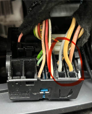

Citroen C5 connector with 4 leads that feed the sub box
Sub box
Sub box

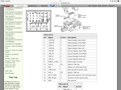

That wiring diagram is for an RT4 not an NG4 with HiFi and possible services module.
If you provide your VIN I'll get a wiring diagram up of the NG4 for you. Please post your VIN in full without spaces - it will be automatically masked from public view after submitting your post & will only be visible to staff.

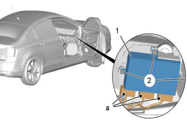

Oh, that is not easy! Where is that box located?
x 6956
Re: NG4 Android radio replacement
On a left hand drive, it's hidden behind the right side (passenger) of the dashboard, so the glovebox need to come off to get access to it.

These are the NG4 Speaker connections:
"e" 3-part connector
Part "A": 16 way connector
Channel numberAllocation of channels of connector
1signal: Right hand rear speaker
2signal: Front right hand speaker
3signal: Front left hand speaker
4signal: Rear left loudspeaker
5Earth : Right hand rear speaker
6Earth : Front right hand speaker
7Earth : Front left hand speaker
8Earth : Rear left loudspeaker
9Supply : Screen DG4
10Comfort CAN High
11Channel not allocated
12Battery + supply
13Comfort CAN Low
14Channel not allocated
15Earth : Screen DG4
16Earth
Part "B": 12 way connector
1Video input no 1 +
2Channel not allocated
3Earth : Microphone
4Right-hand audio auxiliary
5LIN bus for screen DG4
6Video input no 2 +
7Video n°1 -
8Channel not allocated
9Input : Microphone signal
10Left-hand audio auxiliary
11Audio earth
12Video n°2 -
Part "C" : 12-way black connector (*)
(*) Only with CD changer (Not available on hybrid vehicles)
1Earth : CD changer
2VAN Low : CD changer
3Permanent + : CD changer
4Right audio system: CD changer
5Rear socket LH audio output signal
6Channel not allocated
7CAN High : CD changer
8Earth : CD changer
9Rear socket RH audio output signal
10Left audio system: CD changer
12Rear socket audio output earth

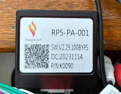

Ok, you are lucky, because I had the same issue while replacing my NG4 (also with HiFi sound). A head unit fully controls the amplifier: volume is set by the can bus (hu provides a constant level of output), equalizer, balance, and fader - all controlled by can packages sent from the head unit to the amplifier by the can bus. And Chinese can bus adapters don't support that functionality. So the solution is to develop a custom can bus adapter that will push missed or broken can packages into the can bus.
I've developed a can bus adapter based on Arduino, here is a sketch: https://github.com/lozynskiy/citroen_ca ... ceiver.ino and here is described a development process (divided into 3 parts, don't miss them all, please use google translator): https://driver.top/exp/498635/
Also, it allows mapping wheel buttons using the SWC application.
Feel free to ask any questions.
