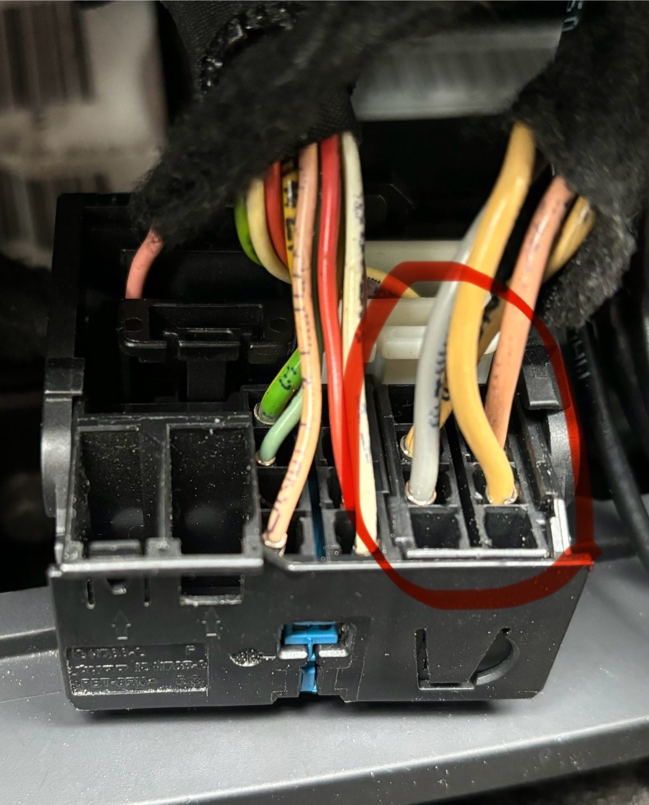

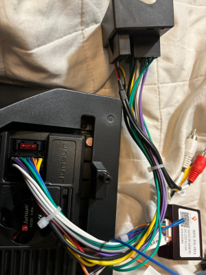

I have a 2010 Citroen C5 V6 3.0 Break. It has the original Harman-Becker 2 din head unit and the about 7” display. It has developed a habit to shut itself down after driving some 40-50 km and again and again…
So, I bought a Junsun 10” Android radio replacement. I have now tested it and seems like GPS is working, WIFI is working, BT is working. However I can’t get the audio working.
I began to explore the connections and found out that the 4x2 connection (purple, green, grey, white) that usually carries the speaker signals (FL, FR, RL, RR) and has of course 8 wires coming from the back of the Android radio, connects to a connector that has only four wires? Still the original radio could control left and right as well as front and back because there are 4 speakers.

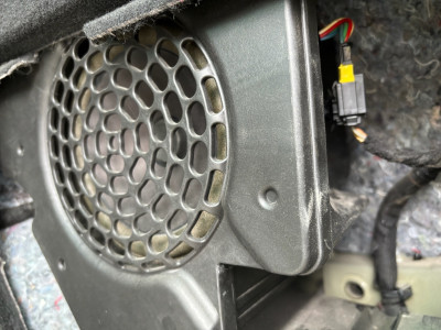

Then I remembered that there is a subwoofer on the right of the trunk. Ok, the same 4 wires (2 yellowish, orange and grey) attach to the subwoofer unit. My guess is that they must be line level and there is an amplifier (in the box with the sub speaker) delivering the speaker level signals to door speakers. I just wonder how is that done with 4 wires only coming in? I mean how can it handle both panning L and R and Front and Back?
What should I do? Rewire 8 (or at least 4 extra wires if use the existing 4) speaker wires (plus an RCA cable for the sub amp) to the sub box in the back so I can use the power amp of the new Android unit.
The Android unit of course has got RCA-line outs but I don’t know the pinout of the 4 original wires or what kind of signal is it feeding? What would be the easiest way? The Front / Back adjustment is not so necessary if I could only get a L / R signal through.
And one more thing… The steering wheel button support was not working either when test used the Android unit.
Thanks in advance!
See the attached photos.

Re: NG4Android radio replacement
I know a little late now as you've bought it, but you could of just done the CF card replacement of the hard drive and you'd be back to normal most likely, unless there was a hardware fault of course.
It's a different kettle of fish with a) the HiFi Amplifier option and b) if you have the services module fitted, which also uses at least on of the speakers for emergency services connection when airbags have been triggered - along with geolocation in a crash.
That wiring diagram is for an RT4 not an NG4 with HiFi and possible services module.
If you provide your VIN I'll get a wiring diagram up of the NG4 for you. Please post your VIN in full without spaces - it will be automatically masked from public view after submitting your post & will only be visible to staff.

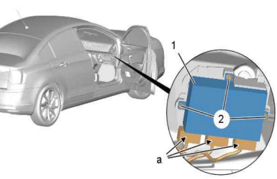

Re: NG4 Android radio replacement
Oh, that is not easy! Where is that box located?
- x 6962
On a left hand drive, it's hidden behind the right side (passenger) of the dashboard, so the glovebox need to come off to get access to it.

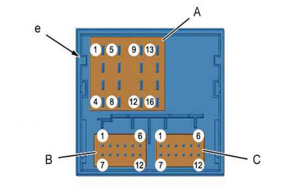

The HiFi was an optional extra - and NG4 was supplied with and without the amp and with or without the services module.
These are the NG4 Speaker connections:
"e" 3-part connector
Part "A": 16 way connector
Part "B": 12 way connector
Part "C" : 12-way black connector (*)
(*) Only with CD changer (Not available on hybrid vehicles)
| Channel number | Allocation of channels of connector |
| 1 | signal: Right hand rear speaker |
| 2 | signal: Front right hand speaker |
| 3 | signal: Front left hand speaker |
| 4 | signal: Rear left loudspeaker |
| 5 | Earth : Right hand rear speaker |
| 6 | Earth : Front right hand speaker |
| 7 | Earth : Front left hand speaker |
| 8 | Earth : Rear left loudspeaker |
| 9 | Supply : Screen DG4 |
| 10 | Comfort CAN High |
| 11 | Channel not allocated |
| 12 | Battery + supply |
| 13 | Comfort CAN Low |
| 14 | Channel not allocated |
| 15 | Earth : Screen DG4 |
| 16 | Earth |
| 1 | Video input no 1 + |
| 2 | Channel not allocated |
| 3 | Earth : Microphone |
| 4 | Right-hand audio auxiliary |
| 5 | LIN bus for screen DG4 |
| 6 | Video input no 2 + |
| 7 | Video n°1 - |
| 8 | Channel not allocated |
| 9 | Input : Microphone signal |
| 10 | Left-hand audio auxiliary |
| 11 | Audio earth |
| 12 | Video n°2 - |
| 1 | Earth : CD changer |
| 2 | VAN Low : CD changer |
| 3 | Permanent + : CD changer |
| 4 | Right audio system: CD changer |
| 5 | Rear socket LH audio output signal |
| 6 | Channel not allocated |
| 7 | CAN High : CD changer |
| 8 | Earth : CD changer |
| 9 | Rear socket RH audio output signal |
| 10 | Left audio system: CD changer |
| 12 | Rear socket audio output earth |

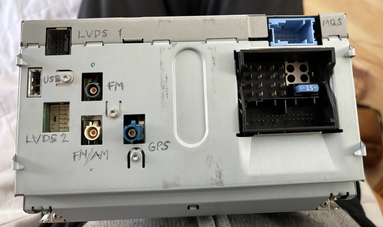

Sorry but I decided to keep the original unit because it is too complicated to try to replace it with a modern Android unit.DHallworth wrote: 10 Apr 2024, 15:36 Sorry to hijack your thread. I might be interested in buying your old NG4 as half of the buttons on the front of mine don't work and the joystick is hanging off. Would be good to make 1 out of the 2.
Let me know if you do decide to sell it please.
David.
I have now tested how to install the Android unit as a second unit and feed the audio signal from its RCA-outs to the AUX ins of the original unit. It works fine. The new 10” diaplay goes to the place of the old display and the old display goes on top of the dashboard in a housing (which I have to custom build). Sounds easy, eh!
