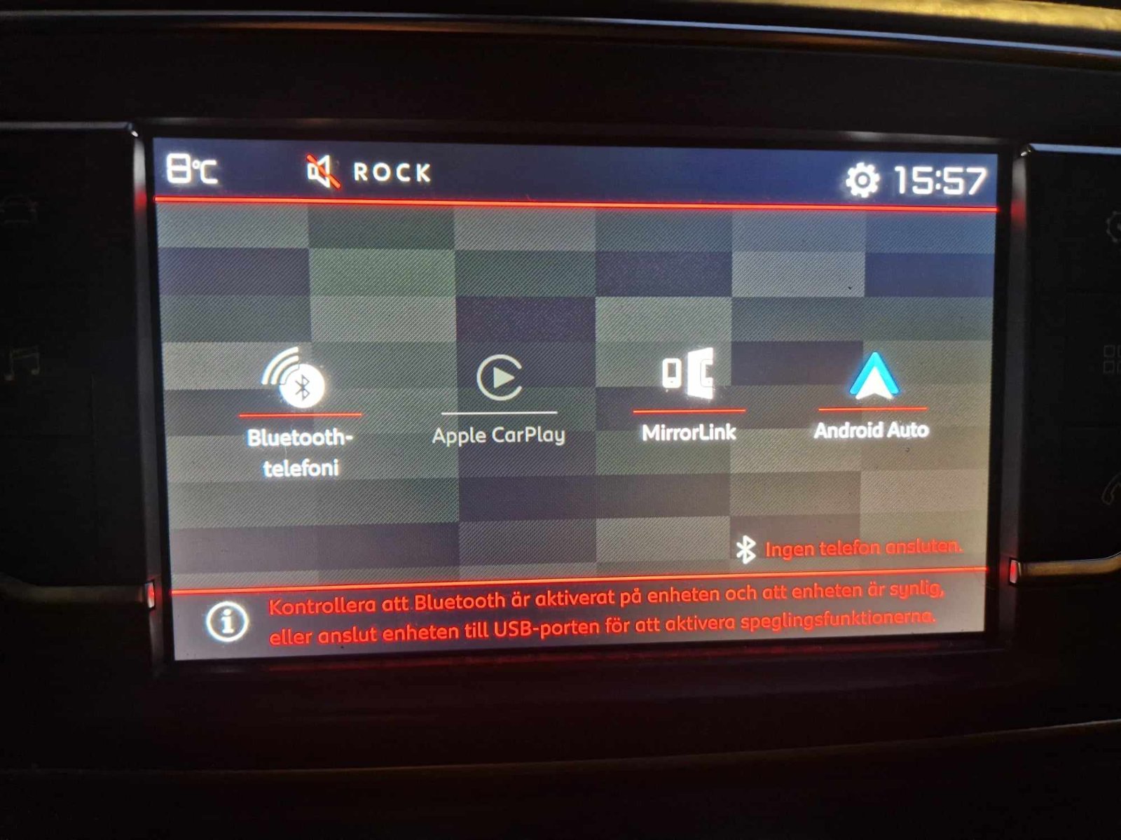

Hello!
I also have issues with Android Auto not working. I have a 2017 Citroen Jumpy (same as Dispatch I believe?). I checked the SW version and I also have an old version from 2017, any chance you could check for an update for my VIN as well? The VIN is VF7**************[VIN obfuscated, can be read by forum staff]. I'm in Sweden BTW if the region matters.
Thanks!

These are the current versions in the vehicle:
HMI version: 21.615.53.14.00
iMX version: x0101175_170420_16.1B108
V850 version: W2.1_16.1S712
And I believe Android Auto should be enabled as I have the menu for both MirrorLink and Android Auto, but get an error saying that I should connect a compatible unit through USB when I try to click on it. I have tried multiple different cables as well as a couple of different phones which is why I believe that it's a software issue. I've used my phone with Android Auto in other cars.
SimonF
Posts: 4
Joined: 25 Nov 2024, 22:24
Re: Android auto
Unread post by SimonF »
I didn't realize I could just download the latest update myself through the Citroen Update application. I'll give that a go and see if the update helps.
x 6956
Re: Android auto
Yes, it looks to be in order according you your screenshot, so use the app to try and install it, but if you have issues let me know and I can provide the file directly.
