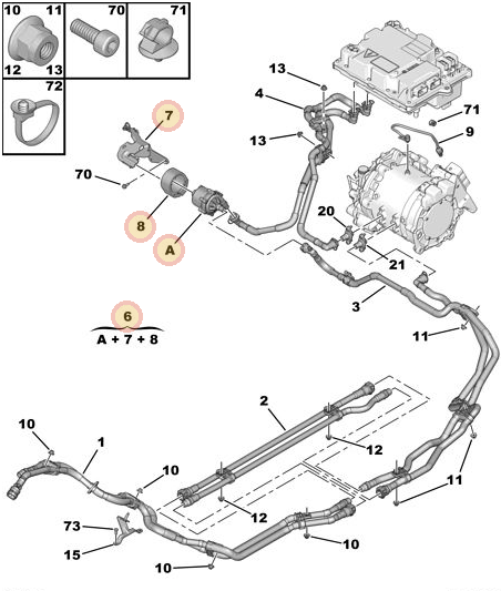

Diag A This is the Cooling Circuit that I mentioned:
(6) Electric Water Pump (includes A, 7 & 8), part: 9807176780, £249.41

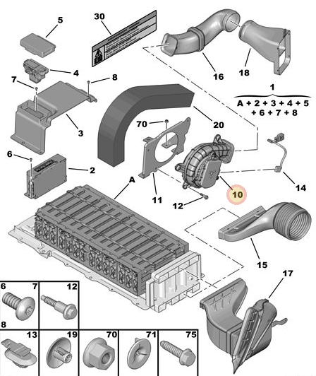

Diag B This is the Fan module:
(10) Battery Blower (Valeo), part: 6441FE, £357.16
(14) Blower Harness, part: 1606452380, £55.98
If there are any other components you need the part number for, let me know whether Diag A or B and the item number :wink:

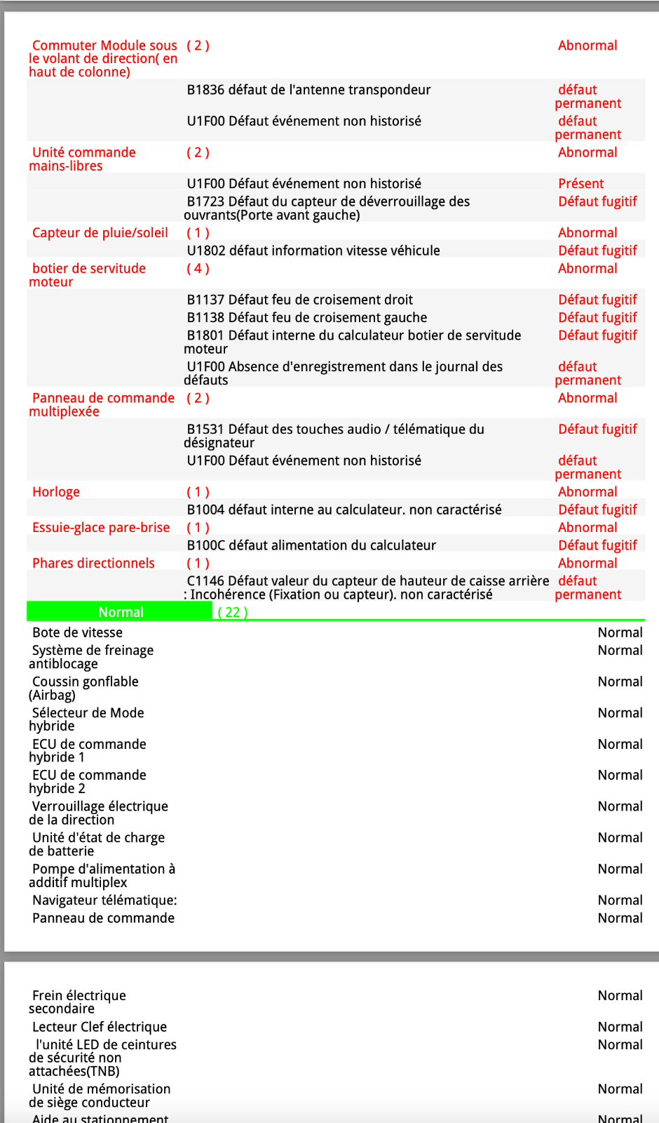

I did have diagnostic this past week. I have attached here the PDF file generated by the diag software. It is probably generic, and is not Diagbox, but hopefully some useful information in there. It is in french, but the codes are there.
I cannot attach pdf files, so I have taken a screen capture of the PDF file.
