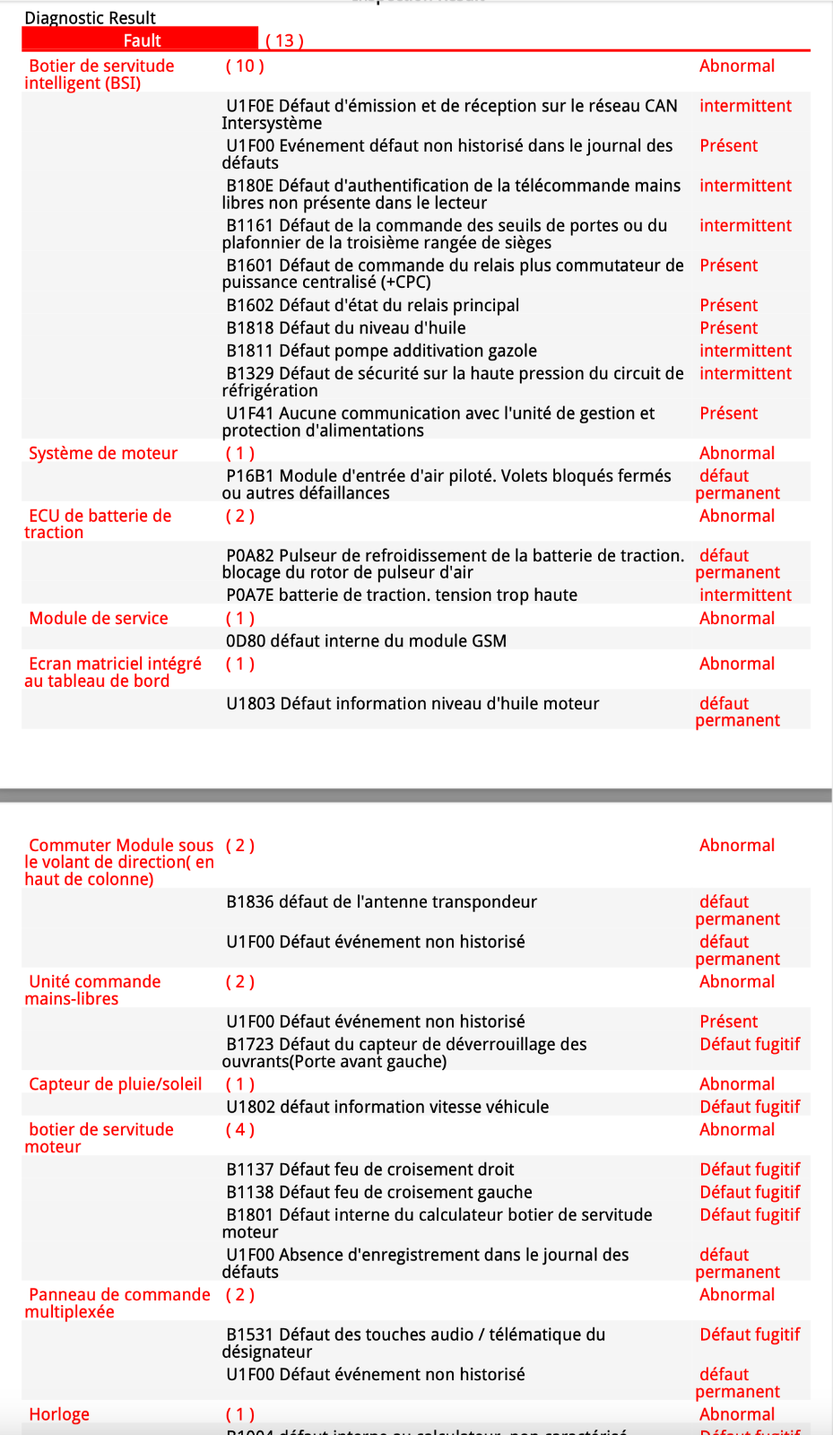

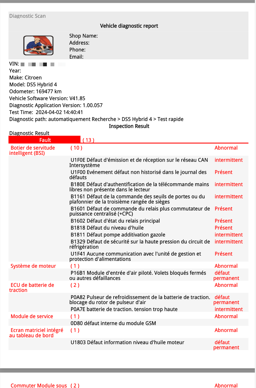

I did have diagnostic this past week. I have attached here the PDF file generated by the diag software. It is probably generic, and is not Diagbox, but hopefully some useful information in there. It is in french, but the codes are there.
I cannot attach pdf files, so I have taken a screen capture of the PDF file.
Thanks.
Thanks.
