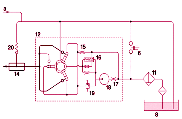

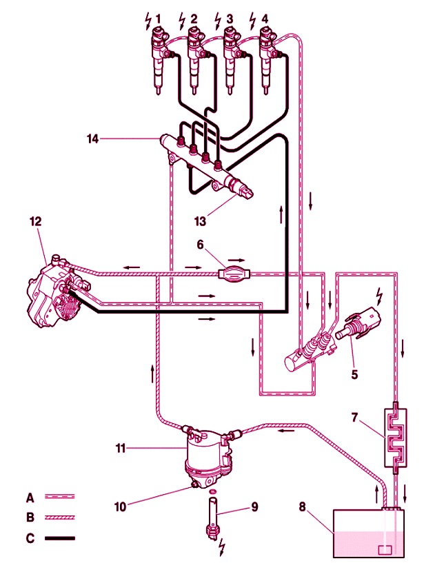

Some info on the fuel circuit for you:
Key
A - Fuel tank return circuit
B - Low pressure fuel circuit (negative pressure)
C - High pressure fuel circuit
Special features:
Key
| Reference | Designation | Part number in the electrical diagrams |
| a | Diesel injector fuel return towards fuel tank | - |
| 1 to 4 | Diesel injectors (electrohydraulic) | 1131 - 1132 - 1133 - 1134 |
| 5 | Fuel temperature sensor | 1221 |
| 6 | Manual fuel primer pump | - |
| 7 | Fuel cooler | - |
| 8 | Fuel tank | - |
| 9 | Fuel heater (electrical) | 1276 |
| 10 | Water bleed screw | - |
| 11 | Fuel filter + water in fuel separator | - |
| 12 | high pressure fuel pump | - |
| 13 | High pressure fuel sensor | 1321 |
| 14 | Fuel high pressure common injection rail | - |
| 15 | Discharge jet | - |
| 16 | Waste gate | - |
| 17 | Flow jet | - |
| 18 | Transfer pump | - |
| 19 | Fuel flow regulator | 1208 or 1277 |
| 20 | Pressure limiter (integral to the fuel high pressure common injection rail) | - |
- The discharge jet ( 15) permits a rapid discharge from the fuel high pressure common injection rail when there is a rapid "foot off"
- The flow jet (17) limits the supply of fuel to the transfer pump (18) at high engine speeds
- Fuel supply circuit with negative pressure : Induction by transfer pump integral to the fuel high pressure pump
- Fuel heater function incorporated in the fuel filter
- Water in diesel fuel detector (4050) (according to market)

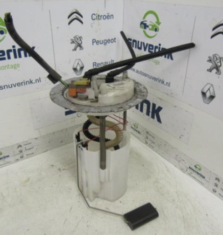

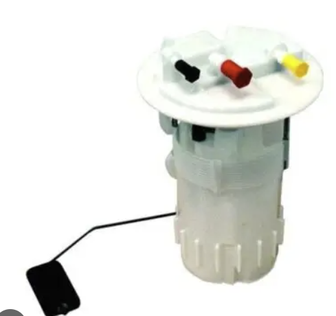

Look - I've checked parts and for a 2009 1.4 HDi Nemo and it is clearly stated gauge with pump.
Here..... .
This one is gauge only - you can see the outlets plugged up:
All 1.4 HDi Nemos have gauge with pump.
Here..... .

Does it equally clearly state that there is a hand pump as well?GiveMeABreak wrote: 16 Mar 2024, 22:07Look - I've checked parts and for a 2009 1.4 HDi Nemo and it is clearly stated gauge with pump.

Just about all diesels I know of have a hand priming pump and yes, it's shown in the diagram I provided (6).
