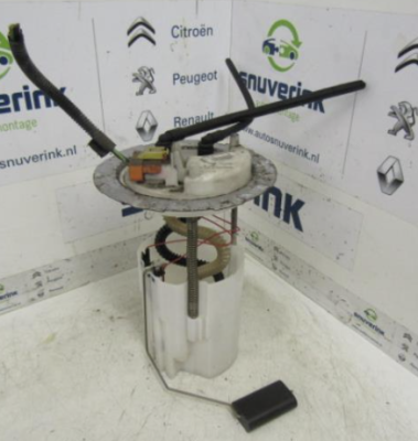

Look - I've checked parts and for a 2009 1.4 HDi Nemo and it is clearly stated gauge with pump.
Here..... .
This one is gauge only - you can see the outlets plugged up:
All 1.4 HDi Nemos have gauge with pump.
Here..... .

Does it equally clearly state that there is a hand pump as well?GiveMeABreak wrote: 16 Mar 2024, 22:07Look - I've checked parts and for a 2009 1.4 HDi Nemo and it is clearly stated gauge with pump.

Hi guys not had time to take the sender unit/ pump out yet as it took ages to strip all the wood out to get access to the point, but I did take off the inspection cover and look at the wiring plug. Now there are two thick wires and two thin wires sonI doubt it is just a sender unit, it has the two thick wires which are likely to power a pump, so I’m guessing it is a pump/sender unit at the moment. So hopefully now going to check for power etc when I get 5, I know the sender unit is working, turned ignition on and checked for power on the two thick wires nothing so going to find out where the pump gets power from next. Cheers guys

Update guys so checked the fuel sender/pump and it is def only a fuel sender, also checked fuse box and no relay for fuel pump or even wiring in the fuse box for a fuel pump relay. So I do think high pressure fuel pump has a fault probably with the transfer pump inside it, what do you guys think.
- Posts: 9335
- x 1942
Re: Citroen Nemo 1.4hdi 2010 turns over but doesn’t start
Did you work out why there are four wires? Is it possible that the thicker power wires are there for other models which do have an in-tank pump? So, the wires are there but connect to nothing. At either end by the sounds of it.
Frankly I am not surprised that there is no in-tank pump as my experience, as questioned by me earlier, is that if you have an in-tank pump then there is no hand pump. Our 2001 Xsara was like that and so was our 2003 C5.
