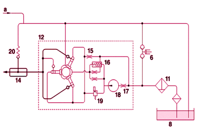

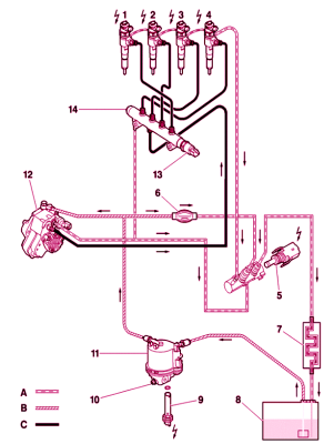

Some info on the fuel circuit for you:
Key
A - Fuel tank return circuit
B - Low pressure fuel circuit (negative pressure)
C - High pressure fuel circuit
Special features:
Key
| Reference | Designation | Part number in the electrical diagrams |
| a | Diesel injector fuel return towards fuel tank | - |
| 1 to 4 | Diesel injectors (electrohydraulic) | 1131 - 1132 - 1133 - 1134 |
| 5 | Fuel temperature sensor | 1221 |
| 6 | Manual fuel primer pump | - |
| 7 | Fuel cooler | - |
| 8 | Fuel tank | - |
| 9 | Fuel heater (electrical) | 1276 |
| 10 | Water bleed screw | - |
| 11 | Fuel filter + water in fuel separator | - |
| 12 | high pressure fuel pump | - |
| 13 | High pressure fuel sensor | 1321 |
| 14 | Fuel high pressure common injection rail | - |
| 15 | Discharge jet | - |
| 16 | Waste gate | - |
| 17 | Flow jet | - |
| 18 | Transfer pump | - |
| 19 | Fuel flow regulator | 1208 or 1277 |
| 20 | Pressure limiter (integral to the fuel high pressure common injection rail) | - |
- The discharge jet ( 15) permits a rapid discharge from the fuel high pressure common injection rail when there is a rapid "foot off"
- The flow jet (17) limits the supply of fuel to the transfer pump (18) at high engine speeds
- Fuel supply circuit with negative pressure : Induction by transfer pump integral to the fuel high pressure pump
- Fuel heater function incorporated in the fuel filter
- Water in diesel fuel detector (4050) (according to market)

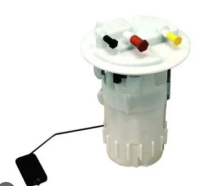

Look - I've checked parts and for a 2009 1.4 HDi Nemo and it is clearly stated gauge with pump.
Here..... .
This one is gauge only - you can see the outlets plugged up:
All 1.4 HDi Nemos have gauge with pump.
Here..... .

Hi guys not had time to take the sender unit/ pump out yet as it took ages to strip all the wood out to get access to the point, but I did take off the inspection cover and look at the wiring plug. Now there are two thick wires and two thin wires sonI doubt it is just a sender unit, it has the two thick wires which are likely to power a pump, so I’m guessing it is a pump/sender unit at the moment. So hopefully now going to check for power etc when I get 5, I know the sender unit is working, turned ignition on and checked for power on the two thick wires nothing so going to find out where the pump gets power from next. Cheers guys

Update guys so checked the fuel sender/pump and it is def only a fuel sender, also checked fuse box and no relay for fuel pump or even wiring in the fuse box for a fuel pump relay. So I do think high pressure fuel pump has a fault probably with the transfer pump inside it, what do you guys think.
