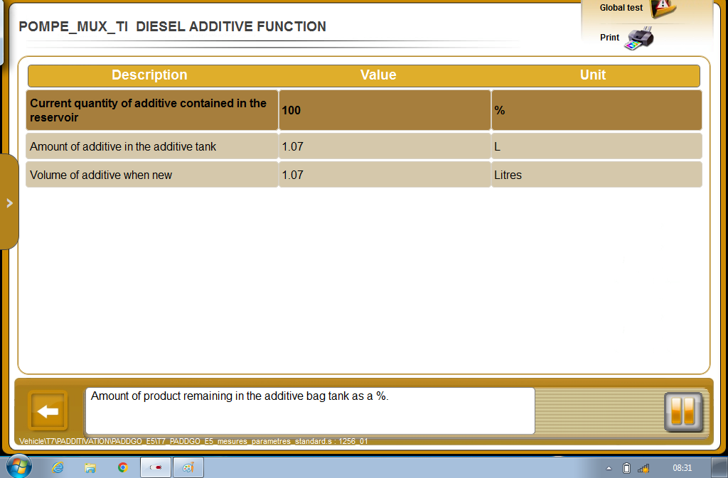

Very quick download of this morning's DiagBox session, order probably a mess will reshuffle and make sense of it later today:
"A" = duplicate, deleted
Edit: a few labels added now
B additive level as found, pre top up
C error message will check when this popped up and update with details
D screen requesting additive level (as part of Top Up procedure)
E additive level post completion of top up process
F additive ECU faults menu post clearing and post top up procedure
G faults as found
G faults as found
H. faults as found
H. faults as found
I. faults as found
I. faults as found
J DPF screen (went no further than this: chickened out!!)
K additive level after I did the "function test" on the additive pump! One percent used in a few seconds!

Interesting Matt , I like how you put up all the Diagbox screens so the whole picture can be seen :)
So has telling the ECU you've replaced the DPF made it happy with the pump fault and injector faults cleared?
