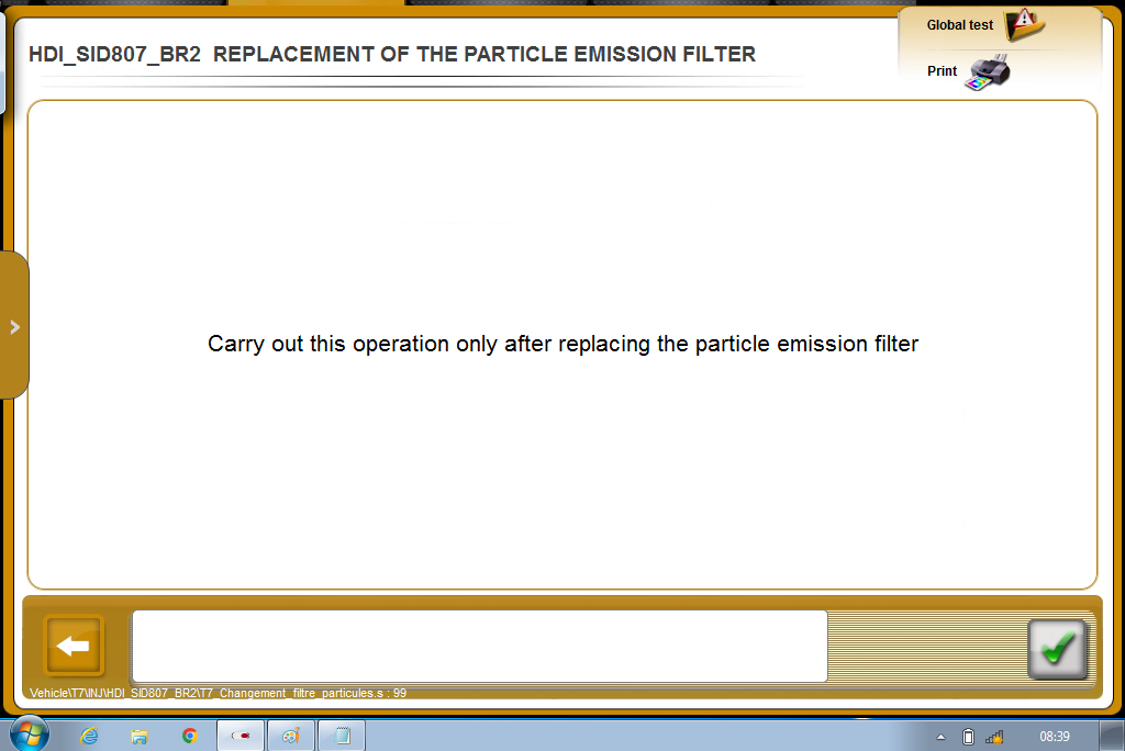

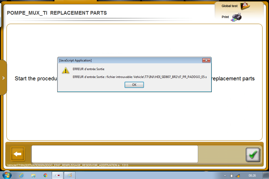

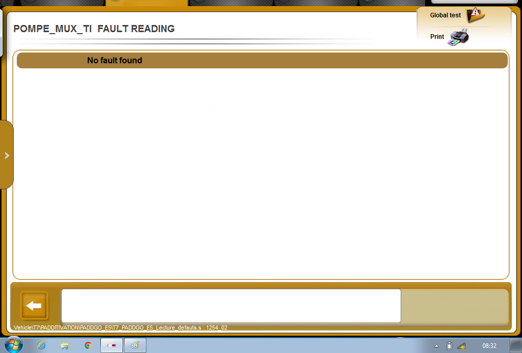

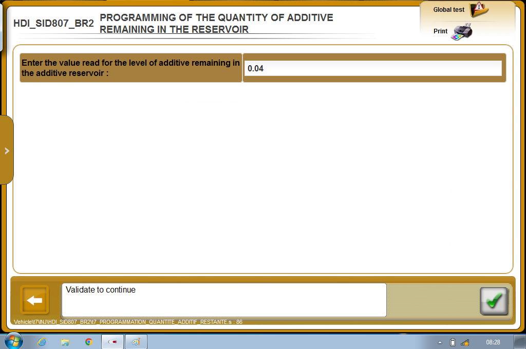

Very quick download of this morning's DiagBox session, order probably a mess will reshuffle and make sense of it later today:

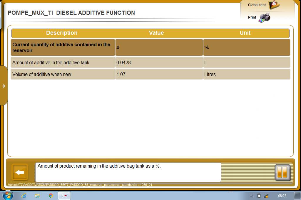

B additive level as found, pre top up
C error message will check when this popped up and update with details
D screen requesting additive level (as part of Top Up procedure)

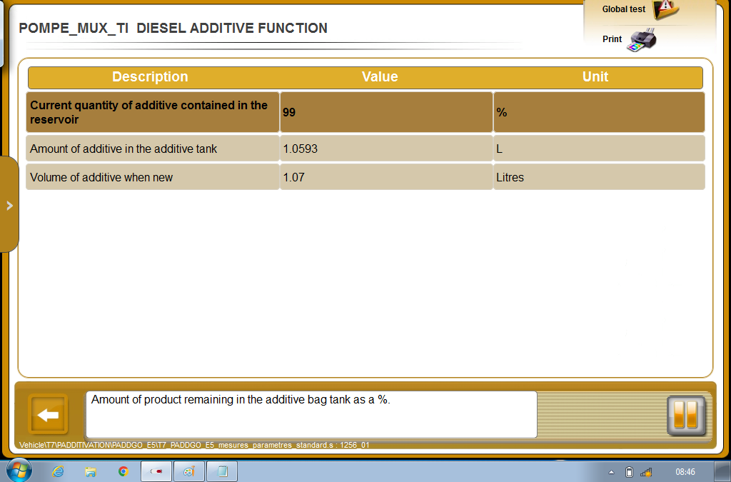

E additive level post completion of top up process

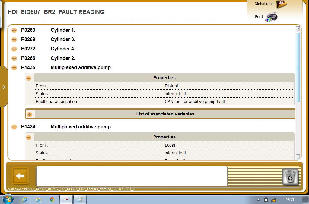

F additive ECU faults menu post clearing and post top up procedure

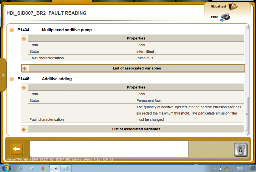

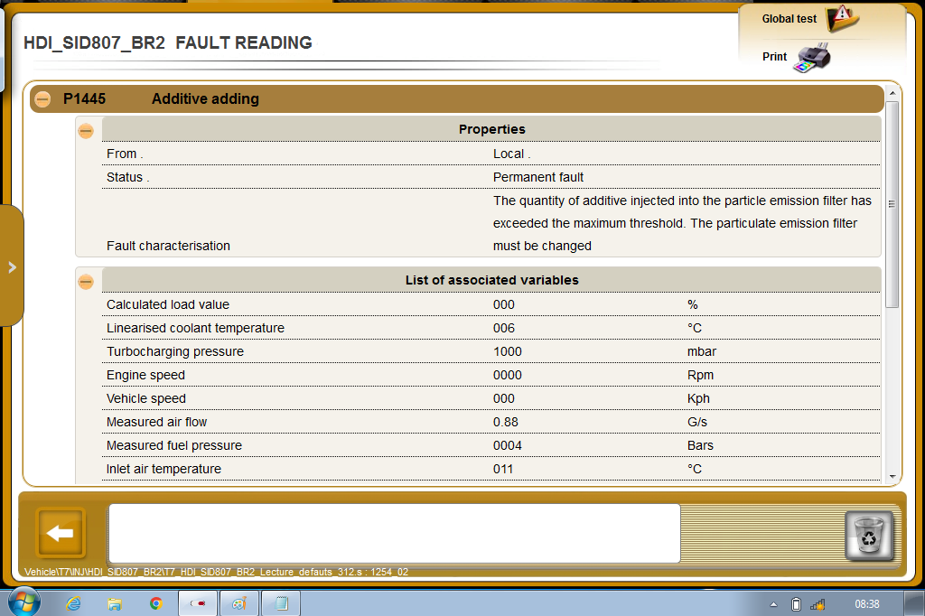

G faults as found
G faults as found
H. faults as found
H. faults as found
I. faults as found
I. faults as found

Interesting Matt , I like how you put up all the Diagbox screens so the whole picture can be seen :)
So has telling the ECU you've replaced the DPF made it happy with the pump fault and injector faults cleared?
