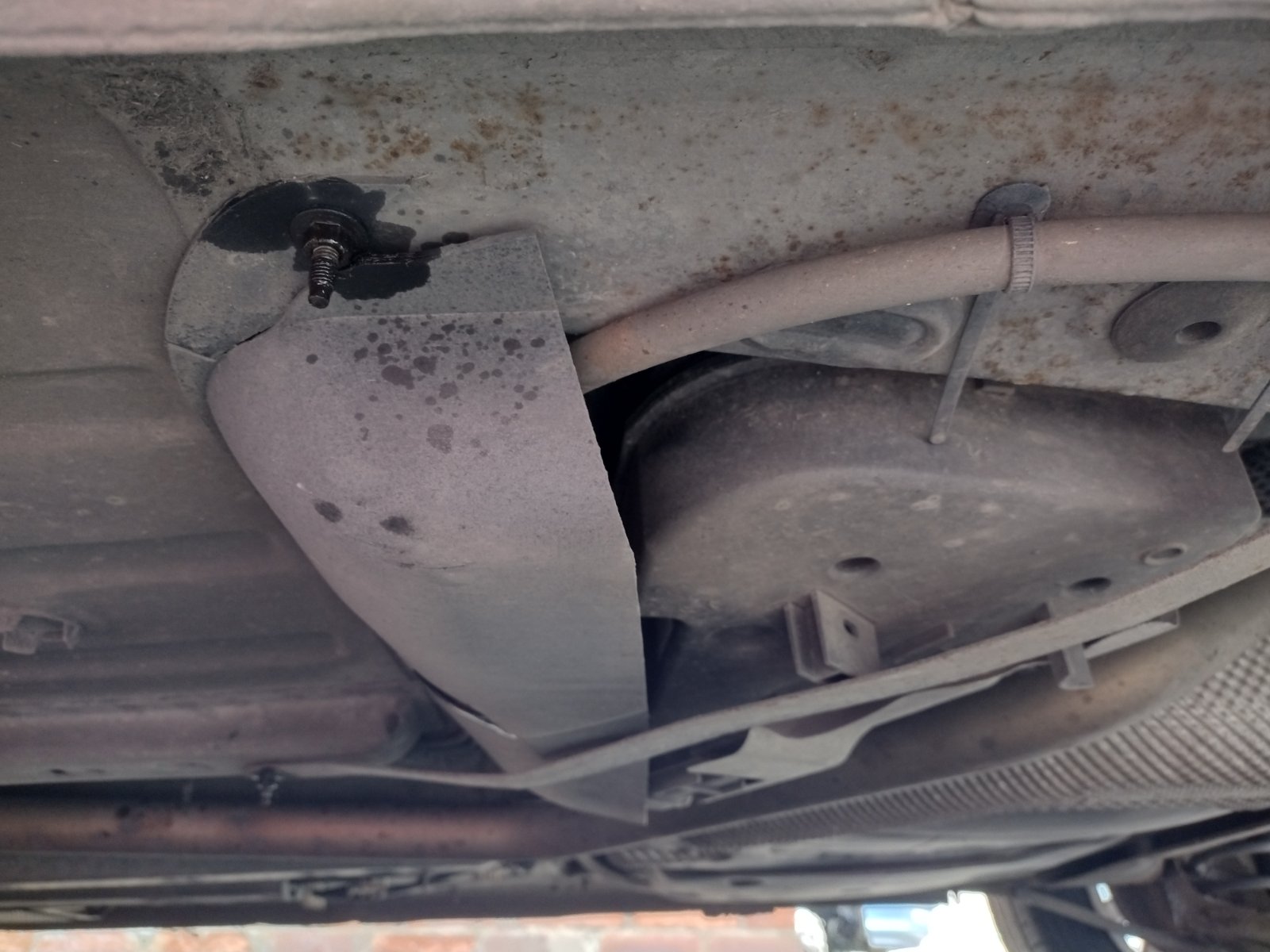

Well, does not seem to have gone to smoothly as the video suggests!
The large plastic undertray seen on the video is a tiny flap on an SW. No major drama to remove.
Pipe in same location on tank.
However having added only about a third of the bottle much to my surprise found it erupting from the connector on tank itself!
Finger over the hole I've only managed to get a bit more in.
Interestingly the bottle cap with hose tail on this kit also includes a small bypass route presumably for air to escape. Fair to say squeezing the bottle in this setup not a good idea.

It is a messy job, thats why i use the pump its faster and less mess , get that stuff off your hands matt, its not good for you at all. My first refill was my 206cc that taught me use a pump its less hassle the gravity feed method dont work its messy and its a hit amd miss affair. When i used the pump for the first time it was so much better.

It's odd really, I'd no issue getting it out the bottle down the pipe and into the tank just by gravity - it was only that it was coming from the other connection that was my problem. It suggests the tank is near full rather than empty (and so it overflowed once I'd put an extra say half a litre in!?!
Who knows at present. There's definitely some in there now, so clearing the error codes is next priority job.
When I get chance, I'll unbolt the tank complete and then can perhaps empty it, confirm how full it is, then refill again.

Ive known some tanks with 800ml still in and for some reason the brain of the car screams it need refilling , if its come out the overflow as you say then you have a full tank, reset the counters then your be all good. Since i did my 308cc last year its only used 25mls from a tad over a litre.

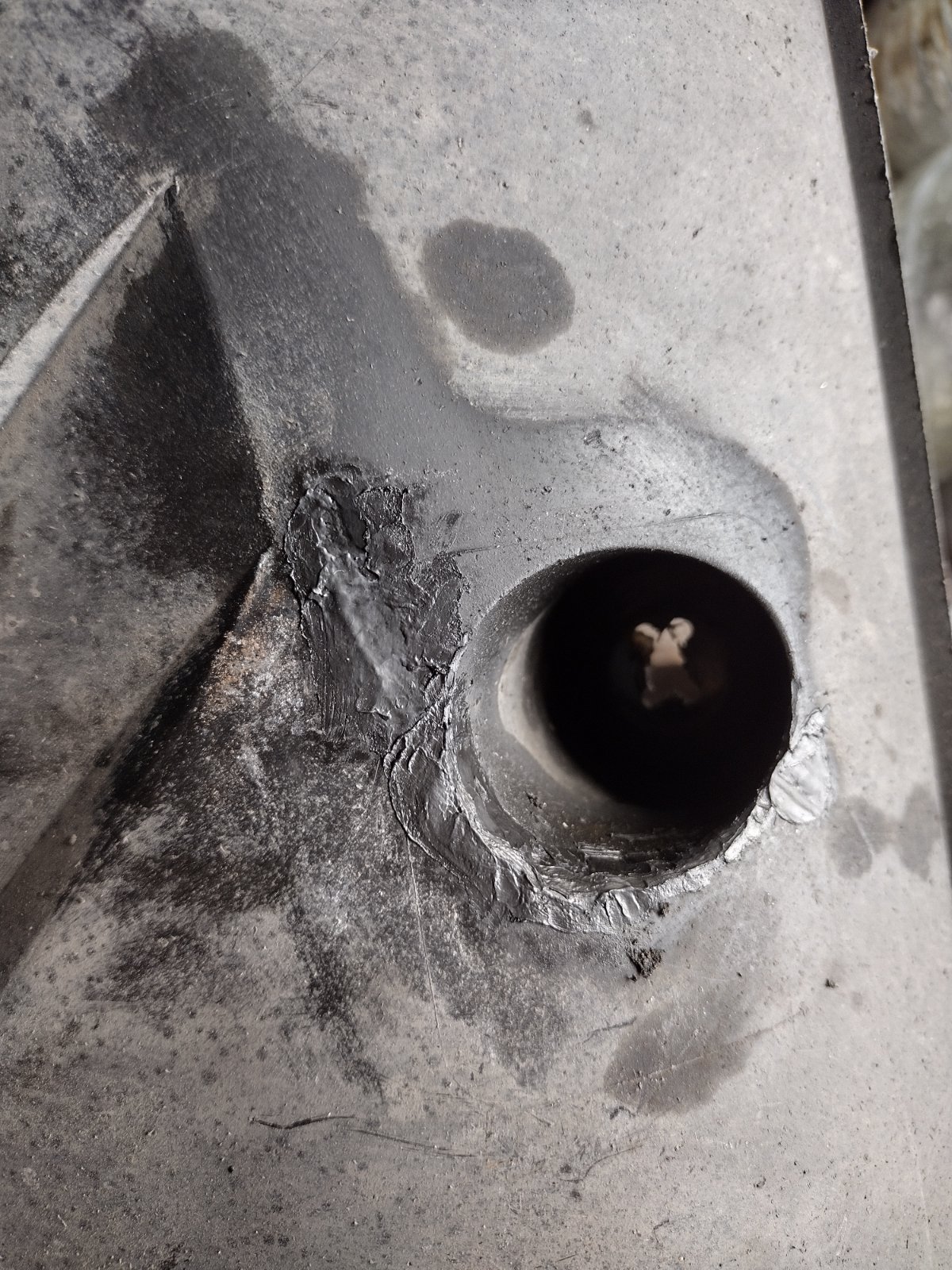

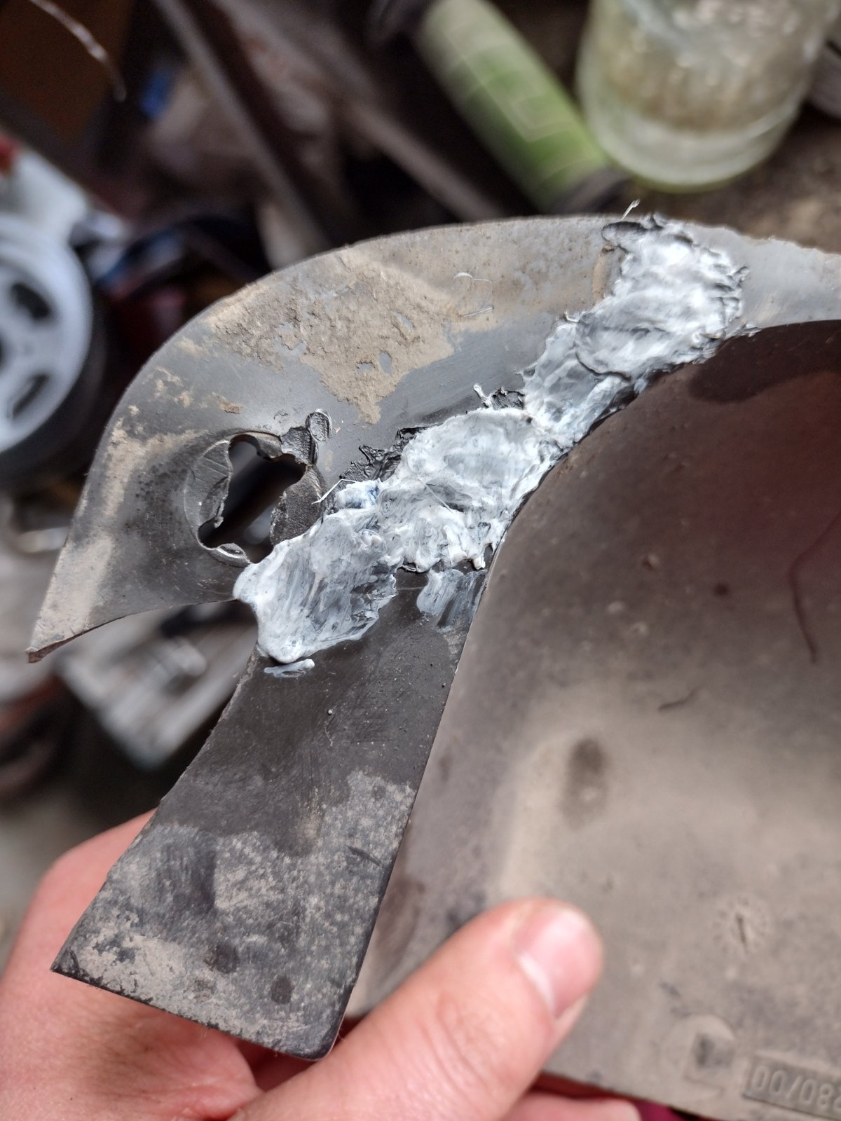

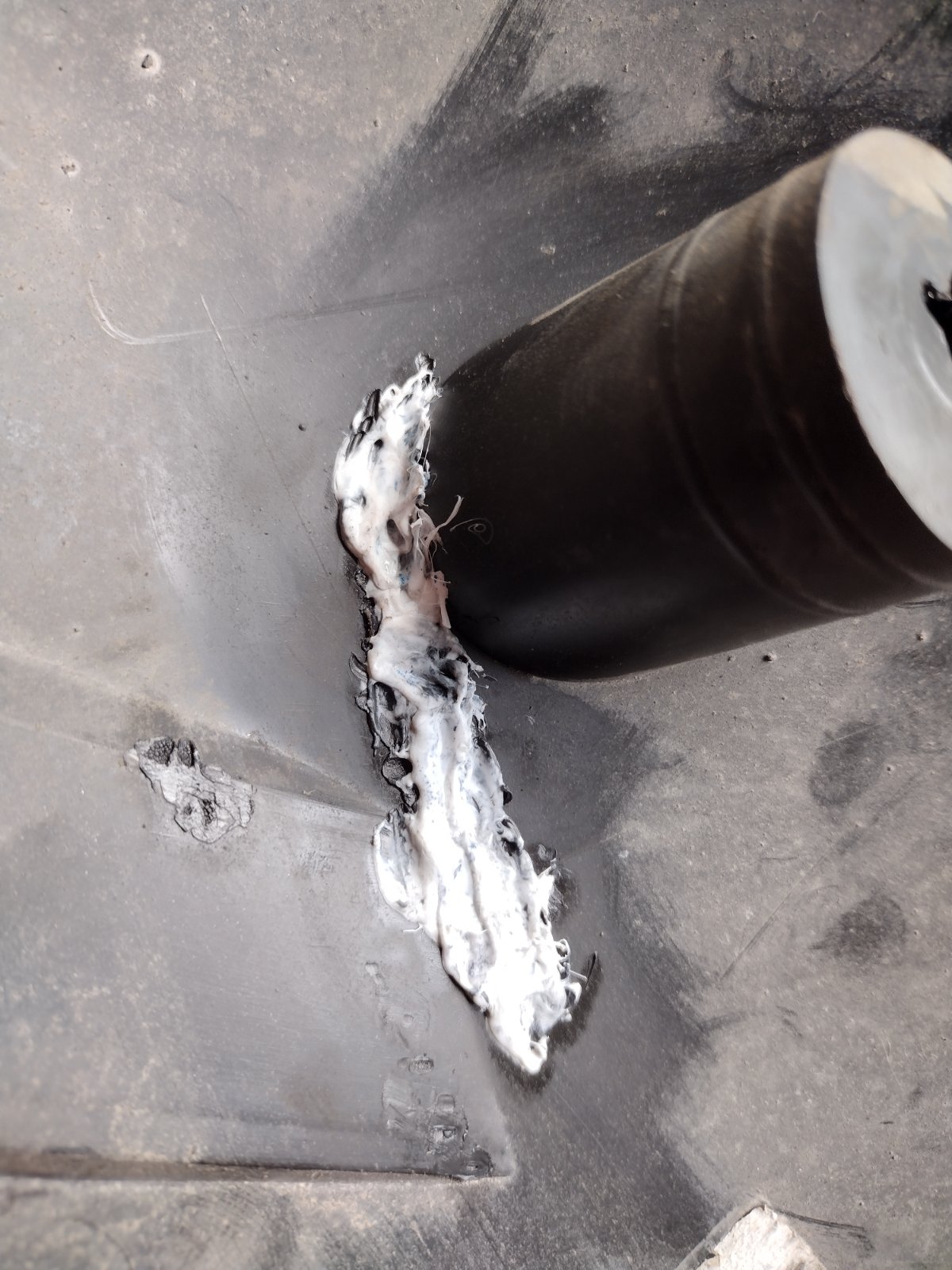

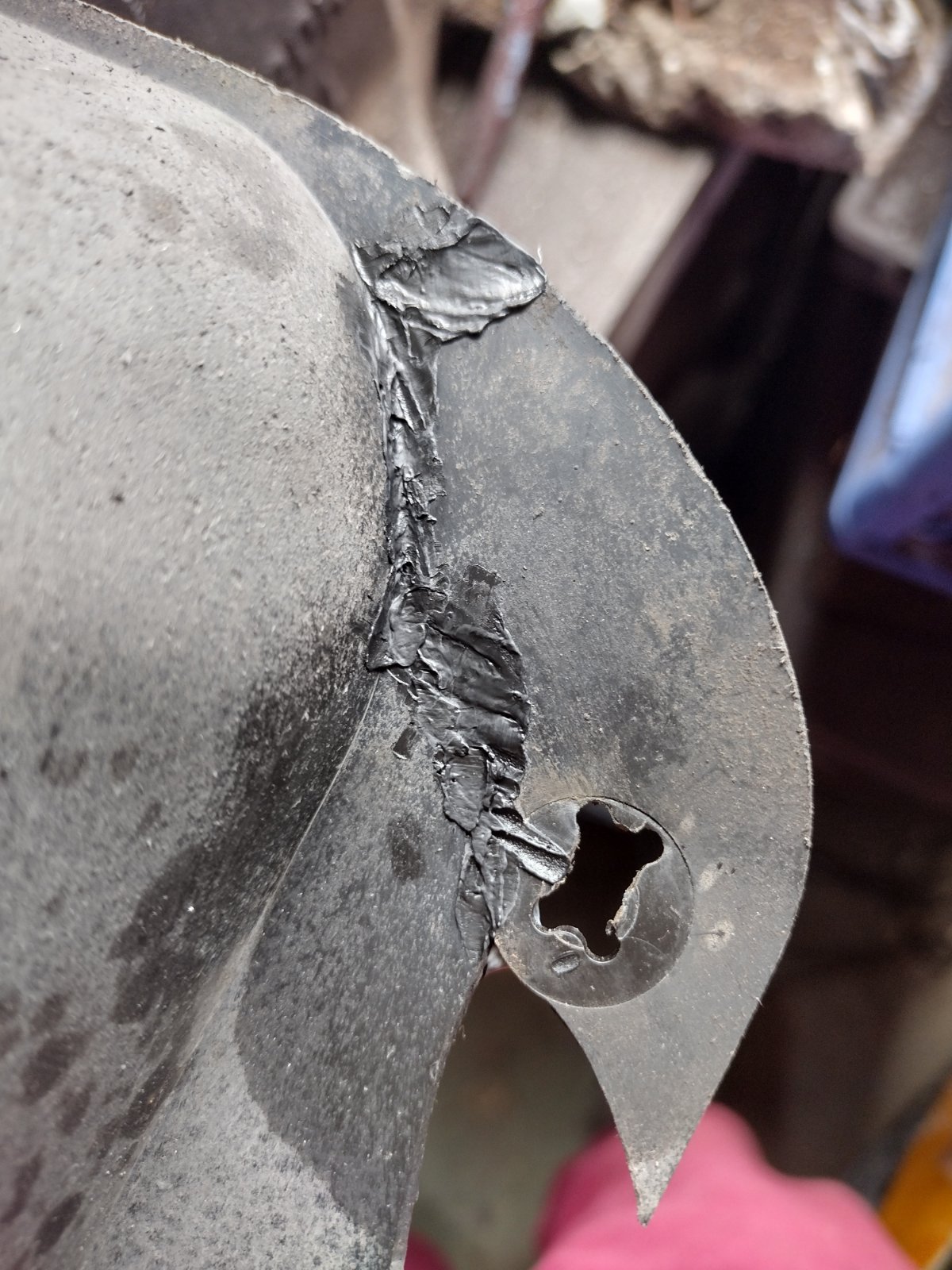

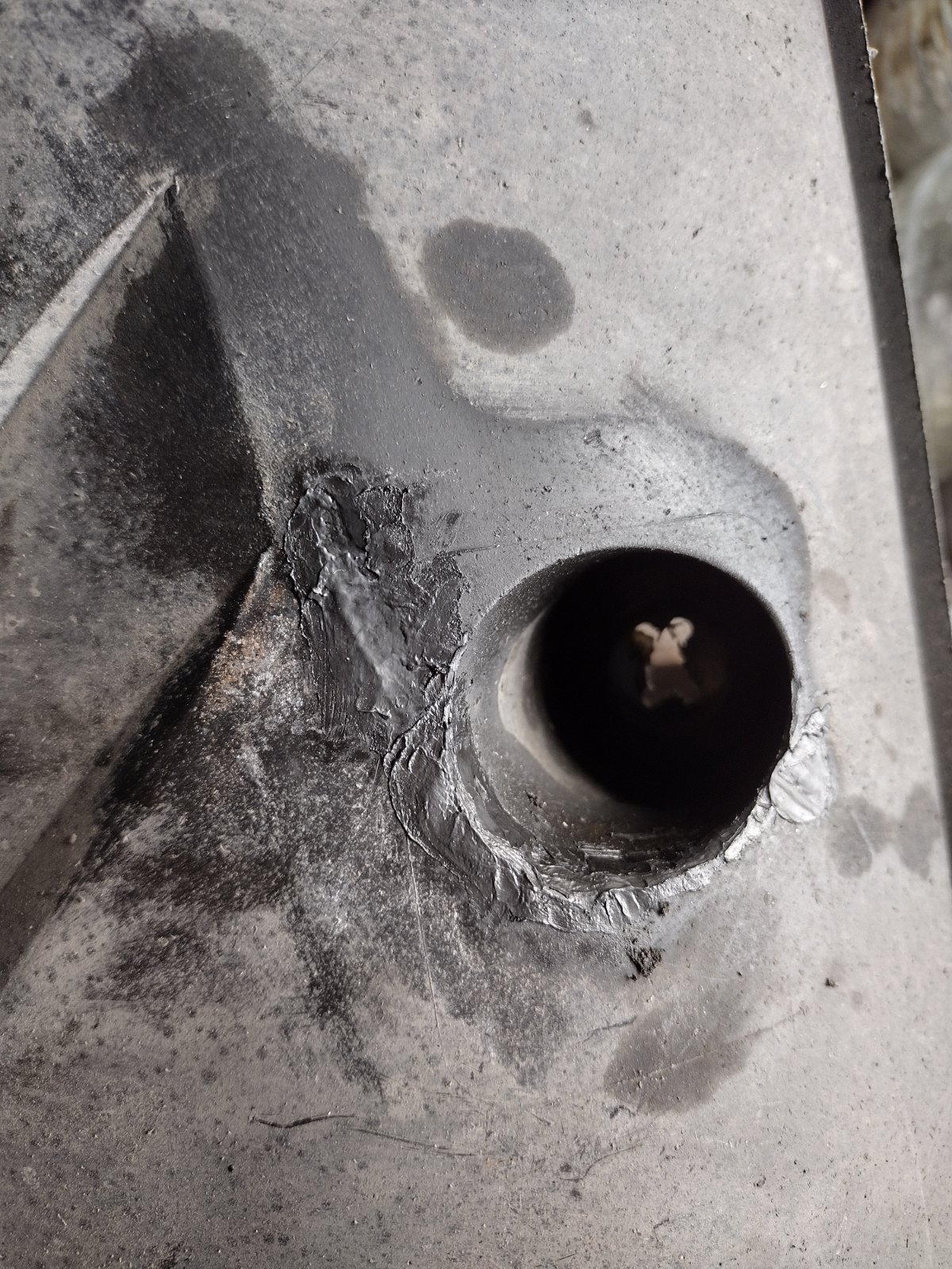

A few pictures from yesterday:

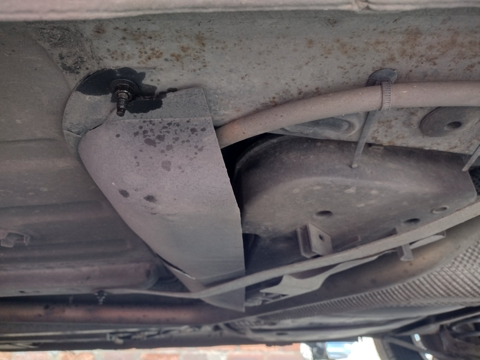

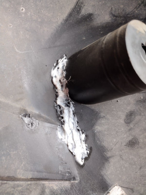

308 SW additive "flap"

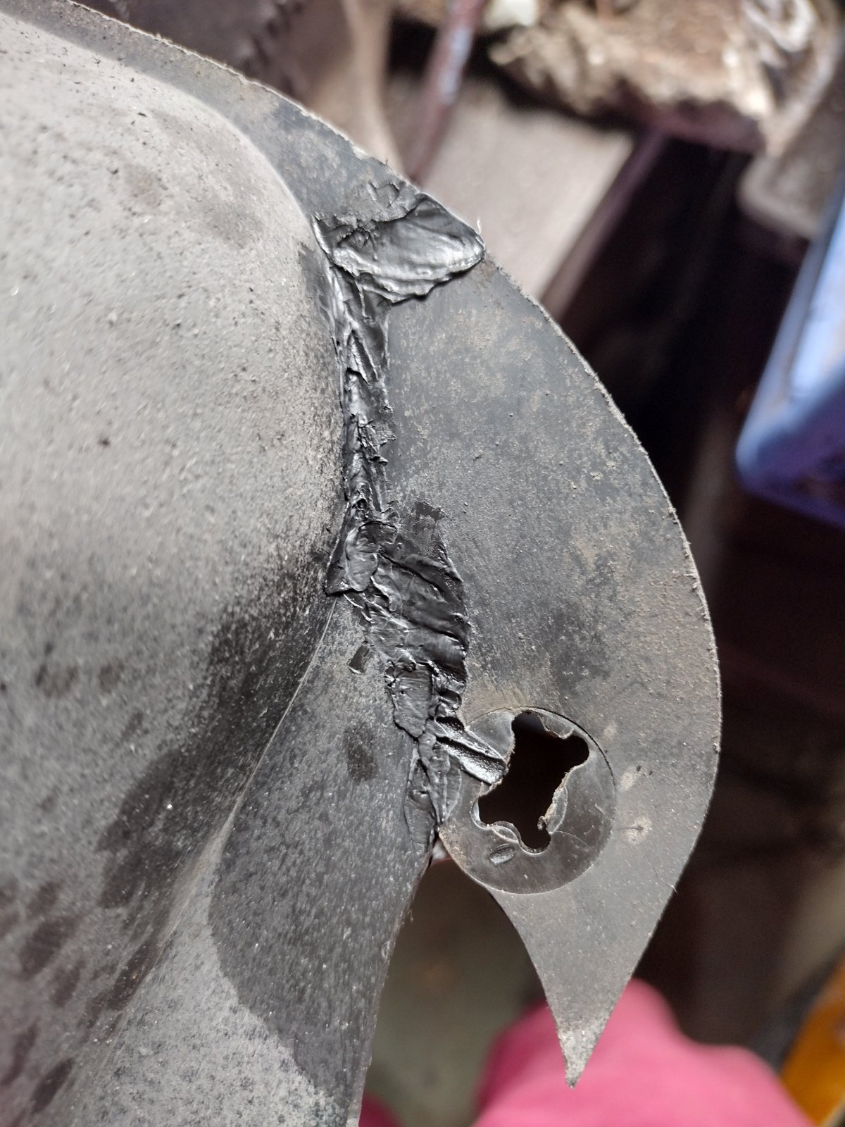

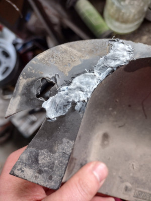

Which was slightly battered and broken, so a spot of soldering iron plastic welding:
Yogurt pot acting as PP (polypropylene) "filler rod"

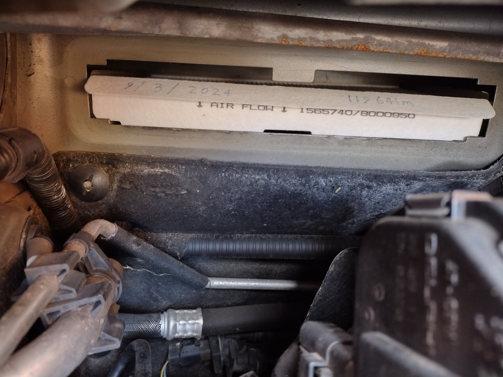

Unread post by MattBLancs »

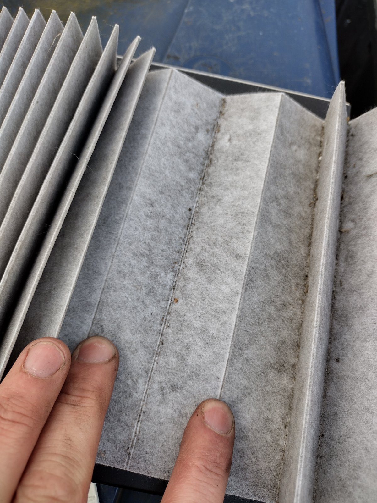

New cabin filter in position
Autopsy of the old filter revealed fairly high dirt loading in the media

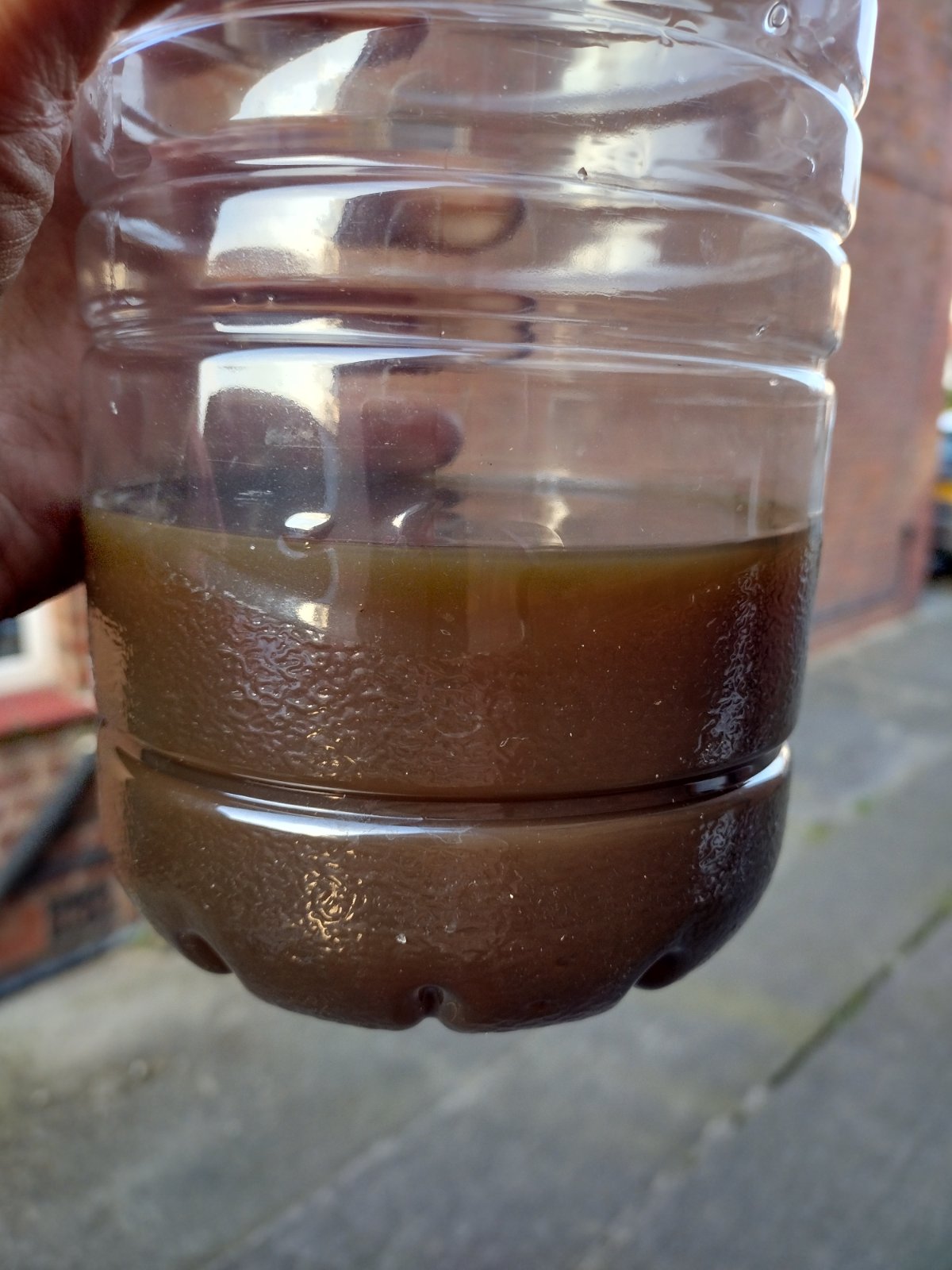

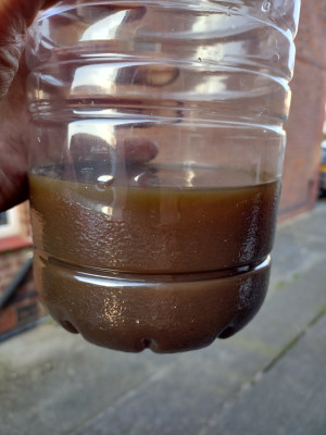

This is the "coolant" just what syphoned out of the header tank (ahead of begining the flush)
Yuk!
Yuk!
Feel better that filth being removed even no performance benefit!

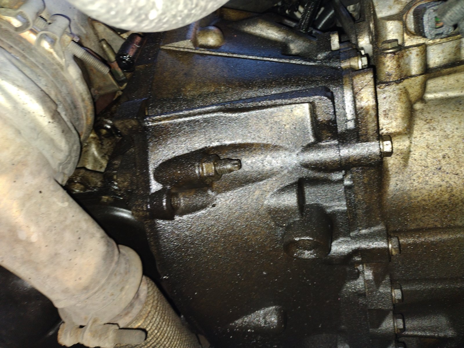

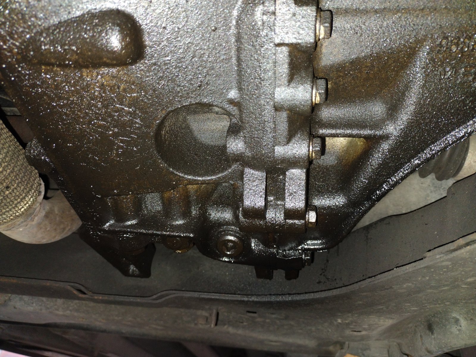

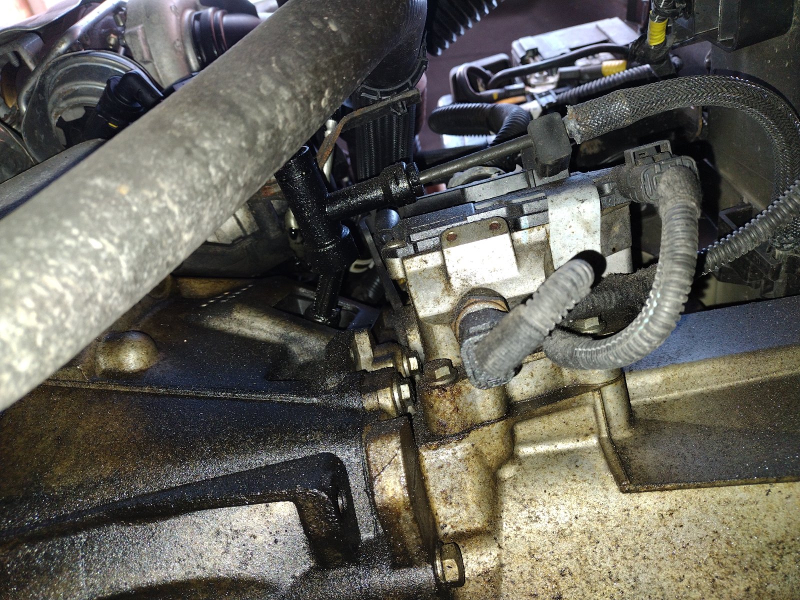

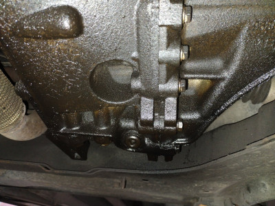

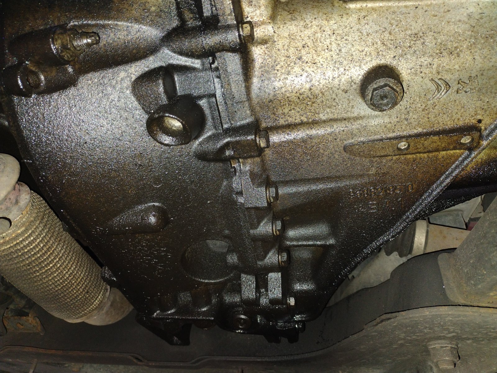

Gearbox casing generally oily all over. Not done the gearbox drain and refill yet, but wondering if this is from within or engine is weeping from somewhere. Something to investigate soon.
Gearbox
Gearbox
Gearbox
Gearbox
Gearbox
Gearbox
Gearbox
Gearbox

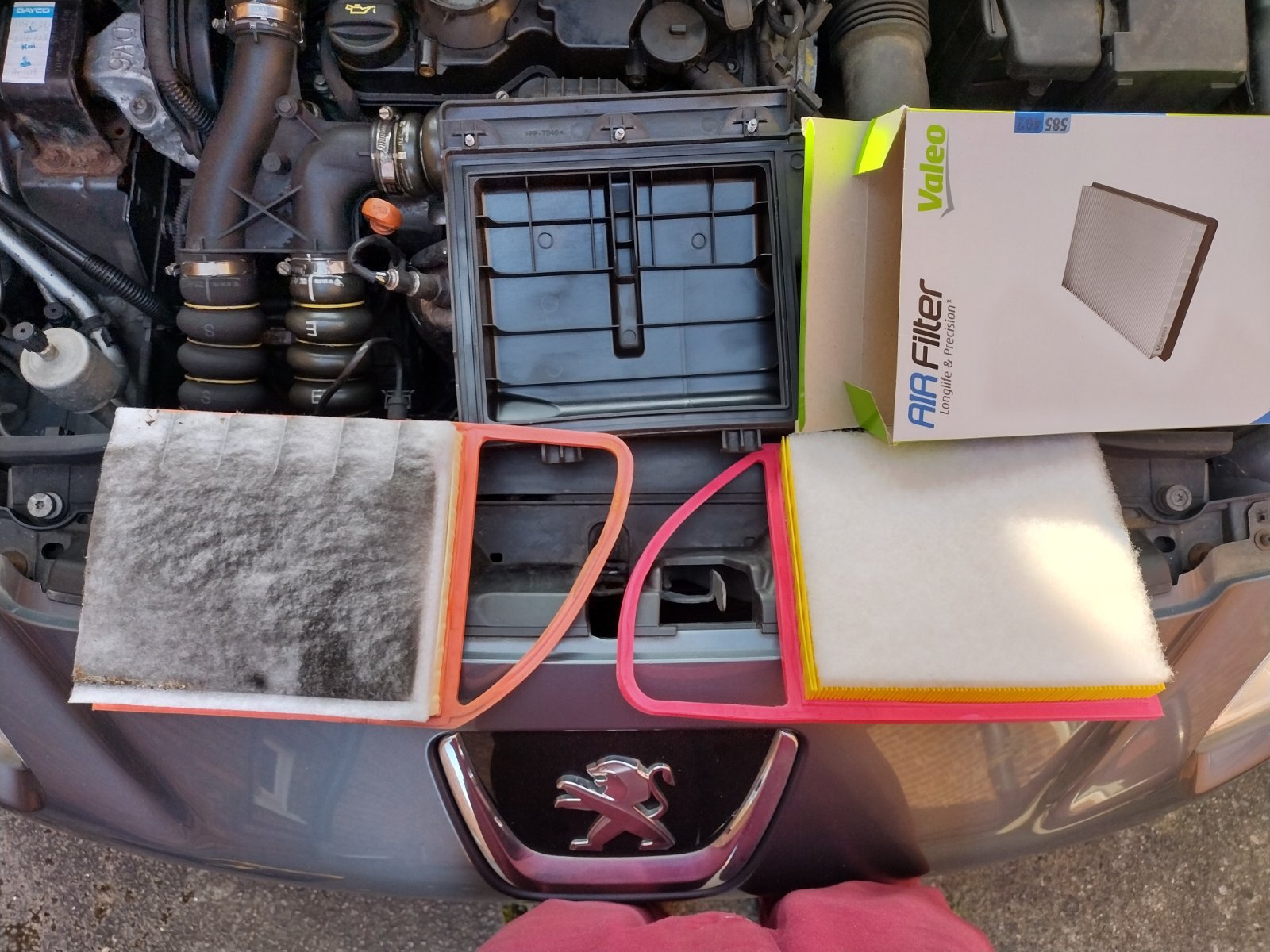

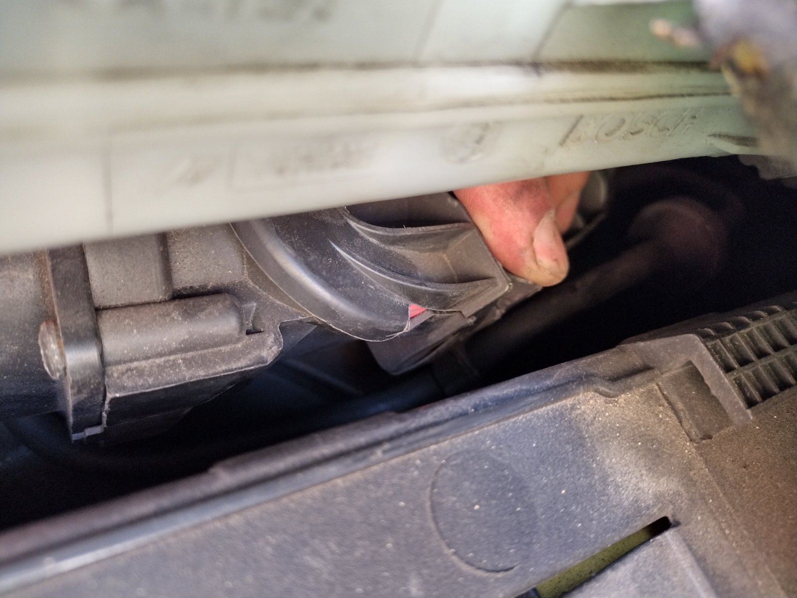

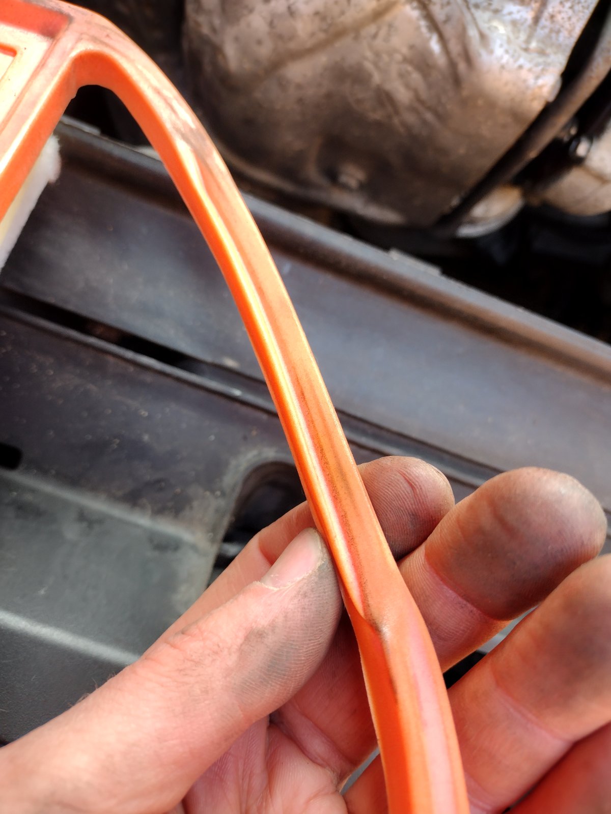

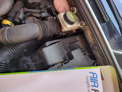

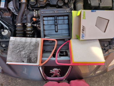

The later DV6 air filter housing is a funny thing, very flat and with the post filter air flow fed back from top half to bottom half on its way the the airflow meter
Old (Comline) and new (Valeo, Autodoc)
Creates need of this extra loop of seal, and then the potential for it to be misaligned!
"extra groove" from misalignment

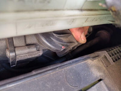

3x Torx screws and an awkward clip
Clip
Clip
Clip
Clip
Huskyxantia
Posts: 3918
Joined: 30 Jul 2018, 22:11
x 918
Unread post by Huskyxantia »
When i did my 308cc , i thought the rest of the fluid tank covers had fallen off or not put back on by previous owners, till i then found out it only had a flap piece . As for the air filter i mean whats wrong with a square type all that effort for a funny arm shape thing lol, which costs more than the usual shape. Oh well .

x 3565
MattBLancs wrote: 10 Mar 2024, 08:13 A few pictures from yesterday:
Coincidentally, LargeClive has just had a look inside a cheap Chinese plastic welder / stapler and given it a resounding "It's OK" :) Considering they can be bought for just over £11 delivered including 200 staples it seems like a worthwhile investment. I'm under no illusions that the welder is designed to last only until you've used up all 200 staples - but at that price I think it can earn it's keep. It's the sort of thing that could be used to reinforce shonky old Citroen AX dashboards that are splitting.... not that that would apply to anyone on the FCF of course :lol:
