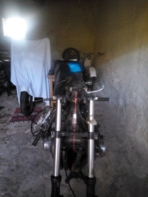

Here's a specially made tool
Then here's the reason
More info at the weekend
Pete

Pete I think you should copy that over to the homemade tools thread: :)

You will see why I posted here at the weekend Mick. The other tools to be used will shed a lot of light on the reason why. Function over finesse. Whether it works or not is yet to be seen.
Pete
