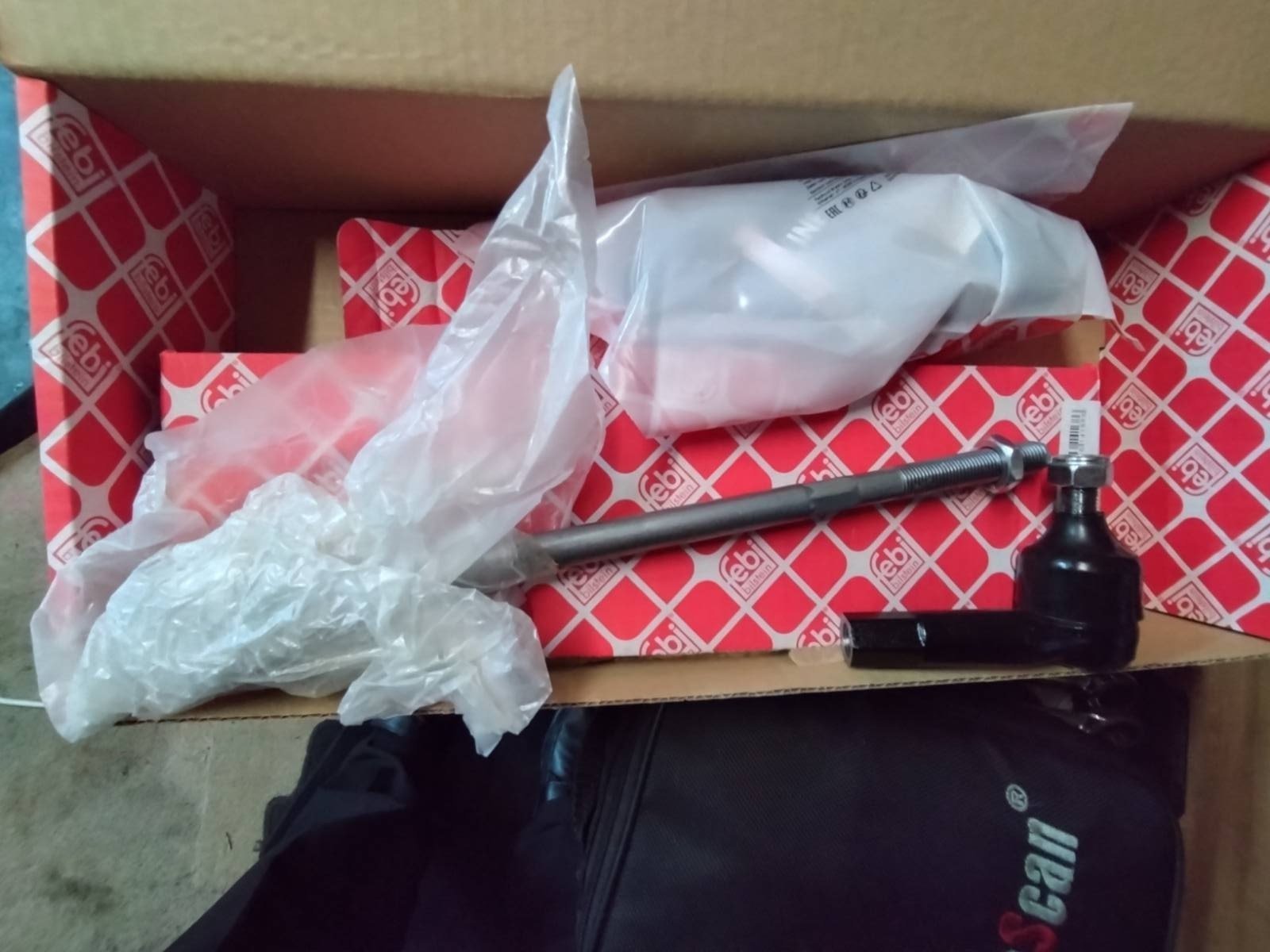

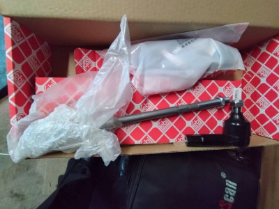

That nice Amazon chap did his usual 30 minutes ago, deposited my parcels in the alley next to the front door without ringing the bell and then climbed into his van and sent me an email saying my parts had been delivered!! Anyhow I opened them up, all Bilstein and checked all is as it should be, it is:

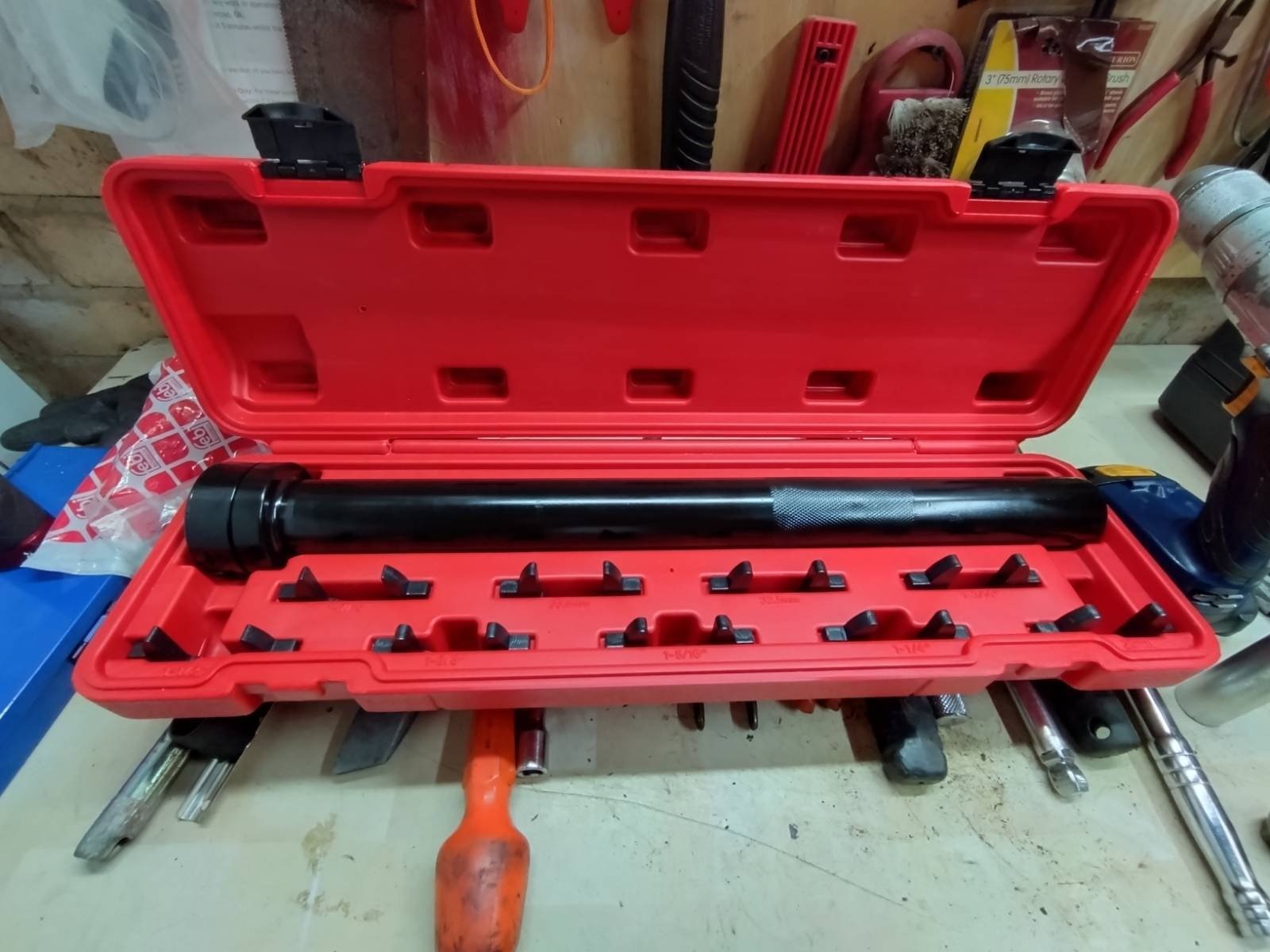

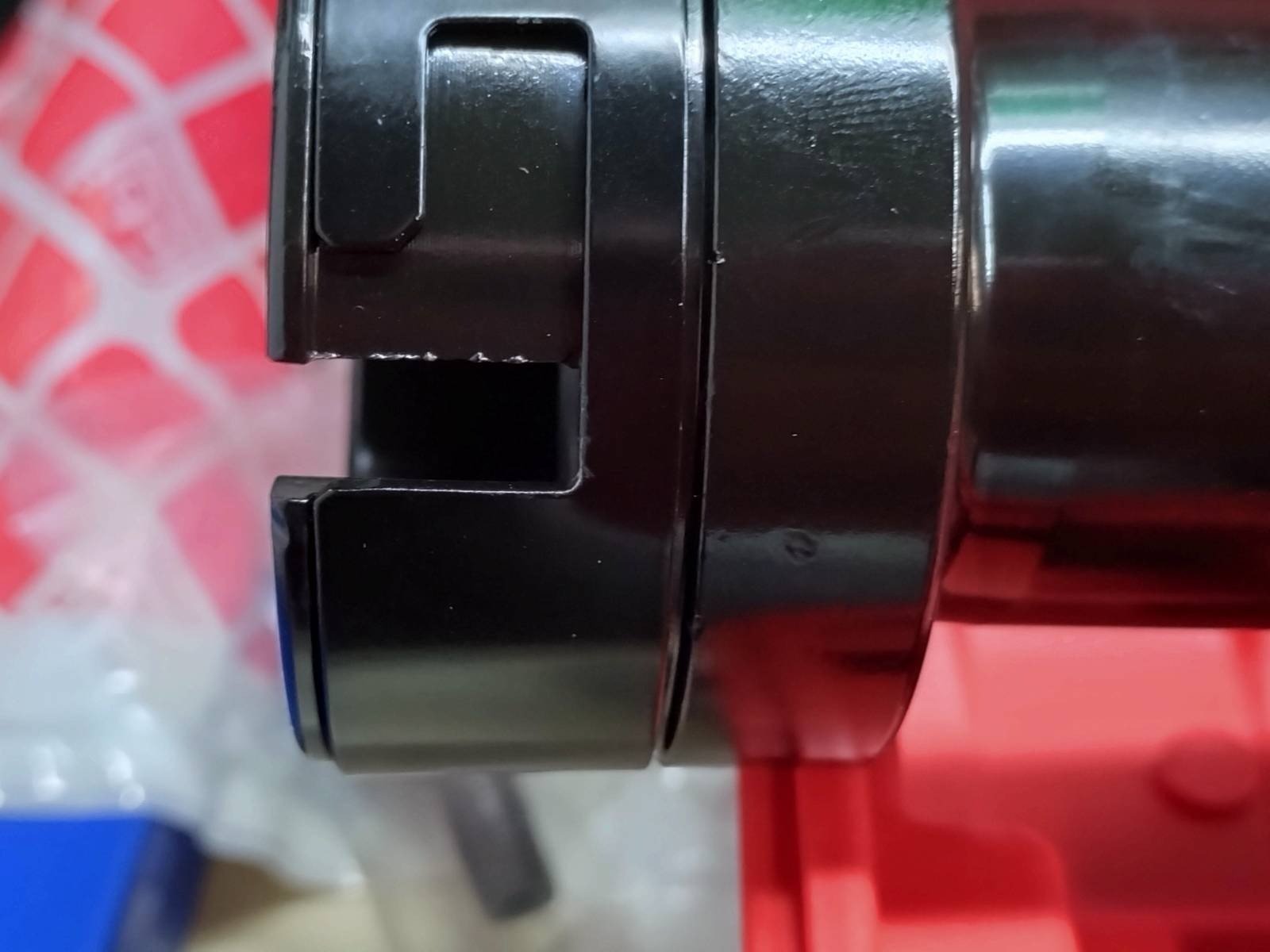

I then opened the other box to examine the installation tool:
I am quite impressed with the quality of the tool, it even has a locking ring to stop it slipping off, although in my car I doubt there is room to use it!!

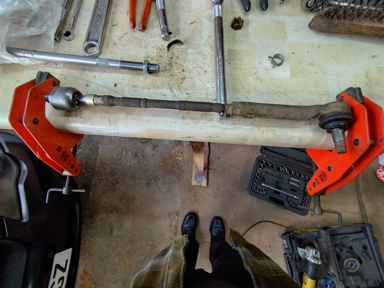

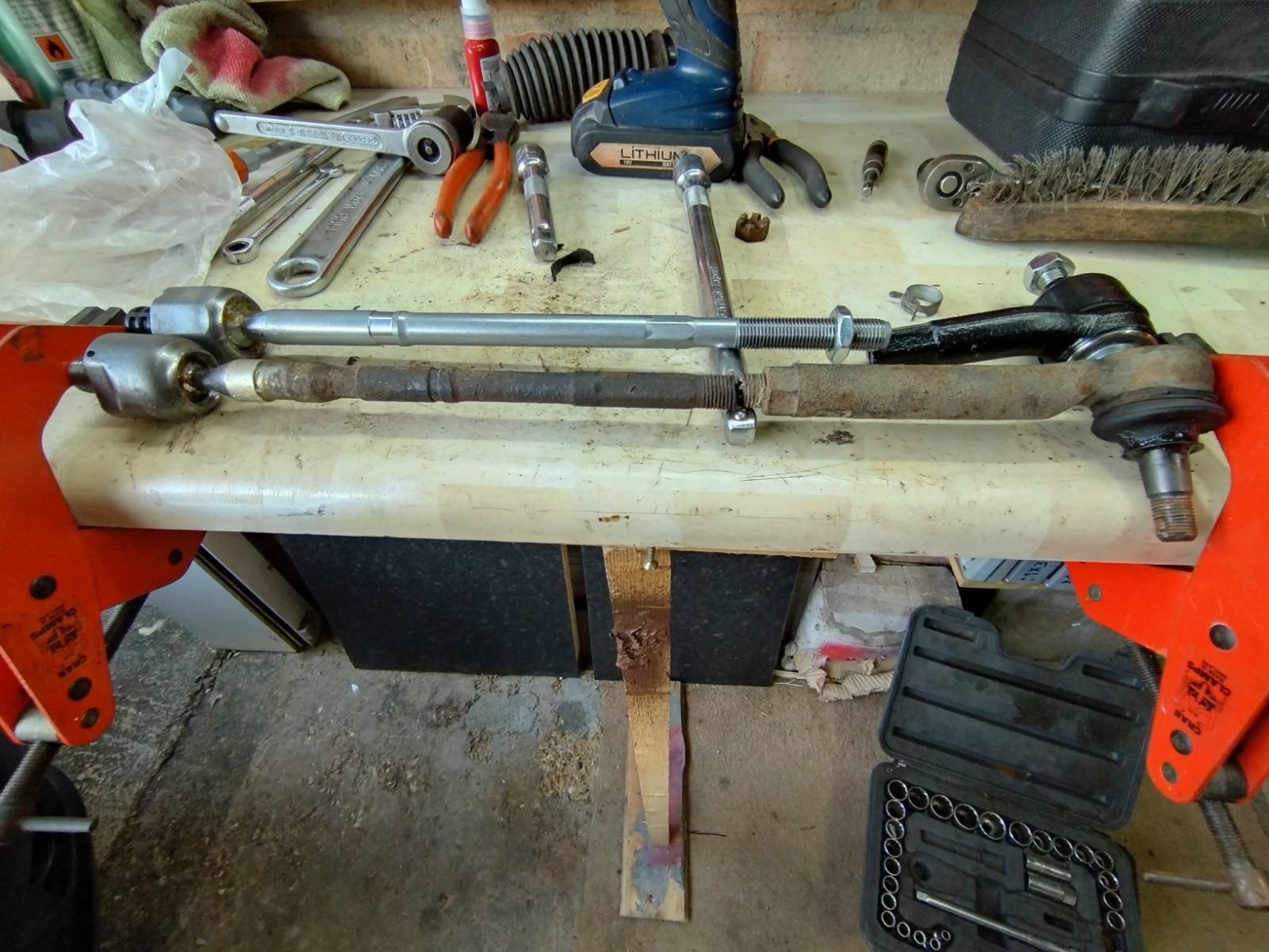

A mixed day today, two bolts would not come undone at all so employed many tricks. Got there eventually, went to install replacement tie rod only to find the end is too short!!!¬¬! GRRRRR Ordered correct end for tomorrow and set about rebuilding the lower control arm. All done so I had to replace the castor to pull the car back out the garage for security and will have to rejack etc when the new end is here!! Hopefully then just a matter of installing the track rod having set it to exactly the same length as the old one which is done using two g clamps on the bench to touch both ends of old rod and then fit new rod to same length,:
mark the position of the end and then install putting the end back on to the same point.

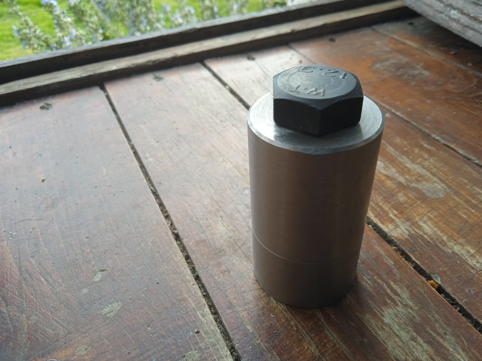

Here's a specially made tool
Then here's the reason
More info at the weekend
Pete

moizeau
- Posts: 1867
- Joined: 12 Jan 2015, 16:08
- x 423
Re: DIY Car Maintenance with function over finesse!!
You will see why I posted here at the weekend Mick. The other tools to be used will shed a lot of light on the reason why. Function over finesse. Whether it works or not is yet to be seen.
Pete
