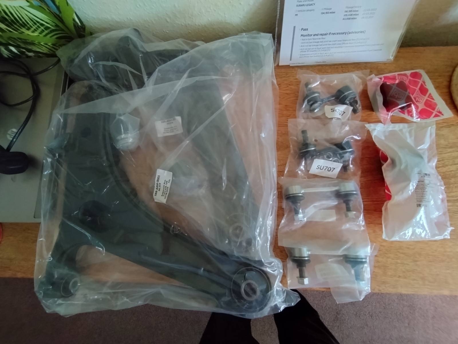

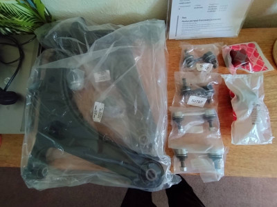

Further research today revealed the press will be required. However even further research turned up replacement control arms with pre fitted bushes and ball joints actually work out slightly cheaper than buying a full set of bushes and ball joints. It will also make the job much quicker consisting of just undoing and torquing up nuts and bolts with the swap in the middle of course.
https://www.ebay.co.uk/itm/193878822056
I am therefore leaning towards that as it would also include replacing the arm front bushes as a matter of course. I like the idea of a completely new arm with 2 years warranty verses a home refurbished one with no comebacks!! I will also replace the ARB mounting bushes and drop links to bring the front up to scratch.
The rear will simply be replacing the ARB mounting bushes and droplinks which are already on order.

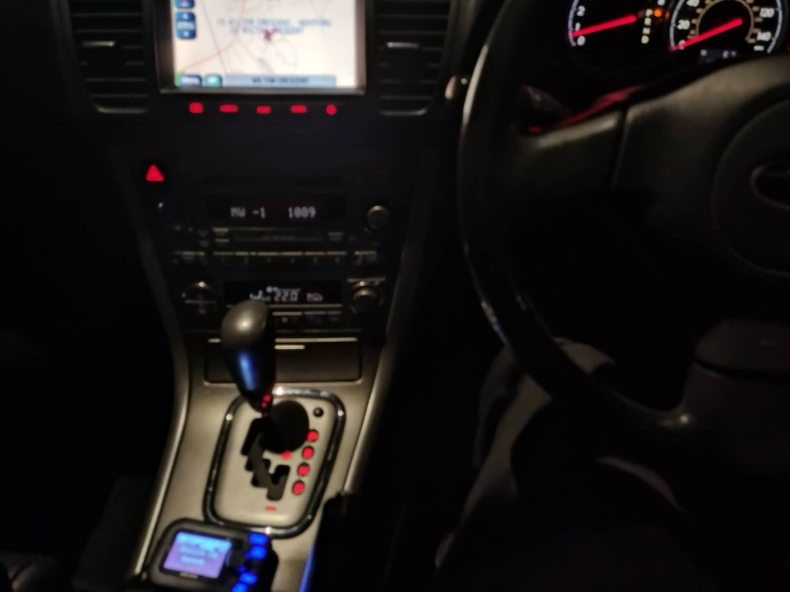

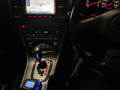

Sadly I have to report a defect in my airbag replacement work at the dealers. I took the car out last night for the first time after dark since having the work done. I turned on the lights and was greeted with this view of the centre console:

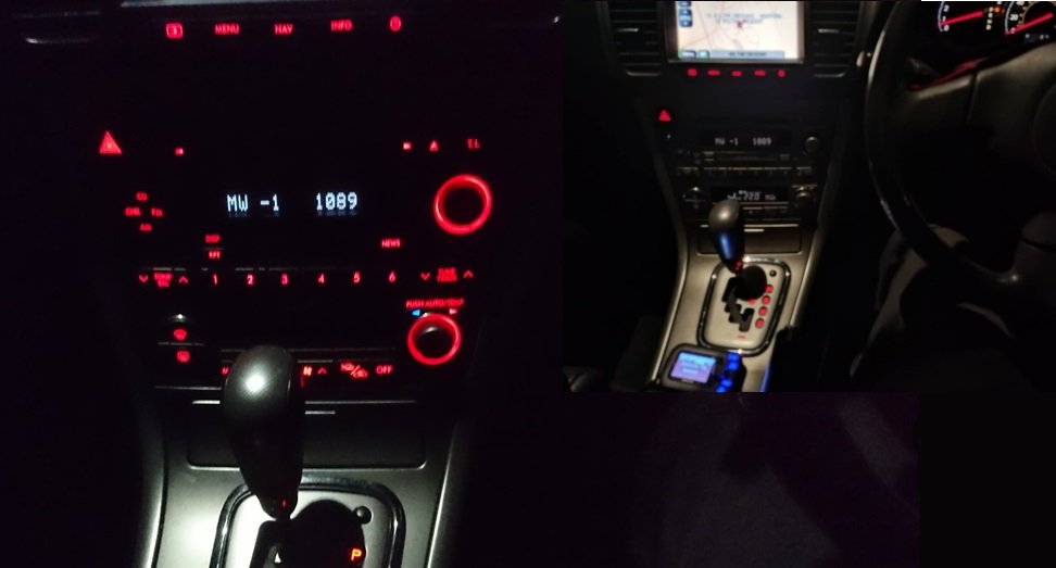

It may not be obvious to you what the problem is until you see that picture superimposed on one from before the work:
