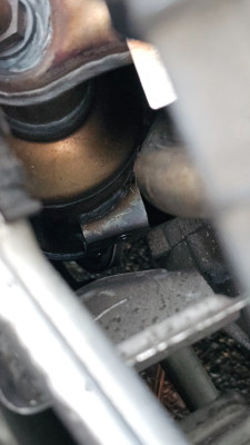

Hello all,

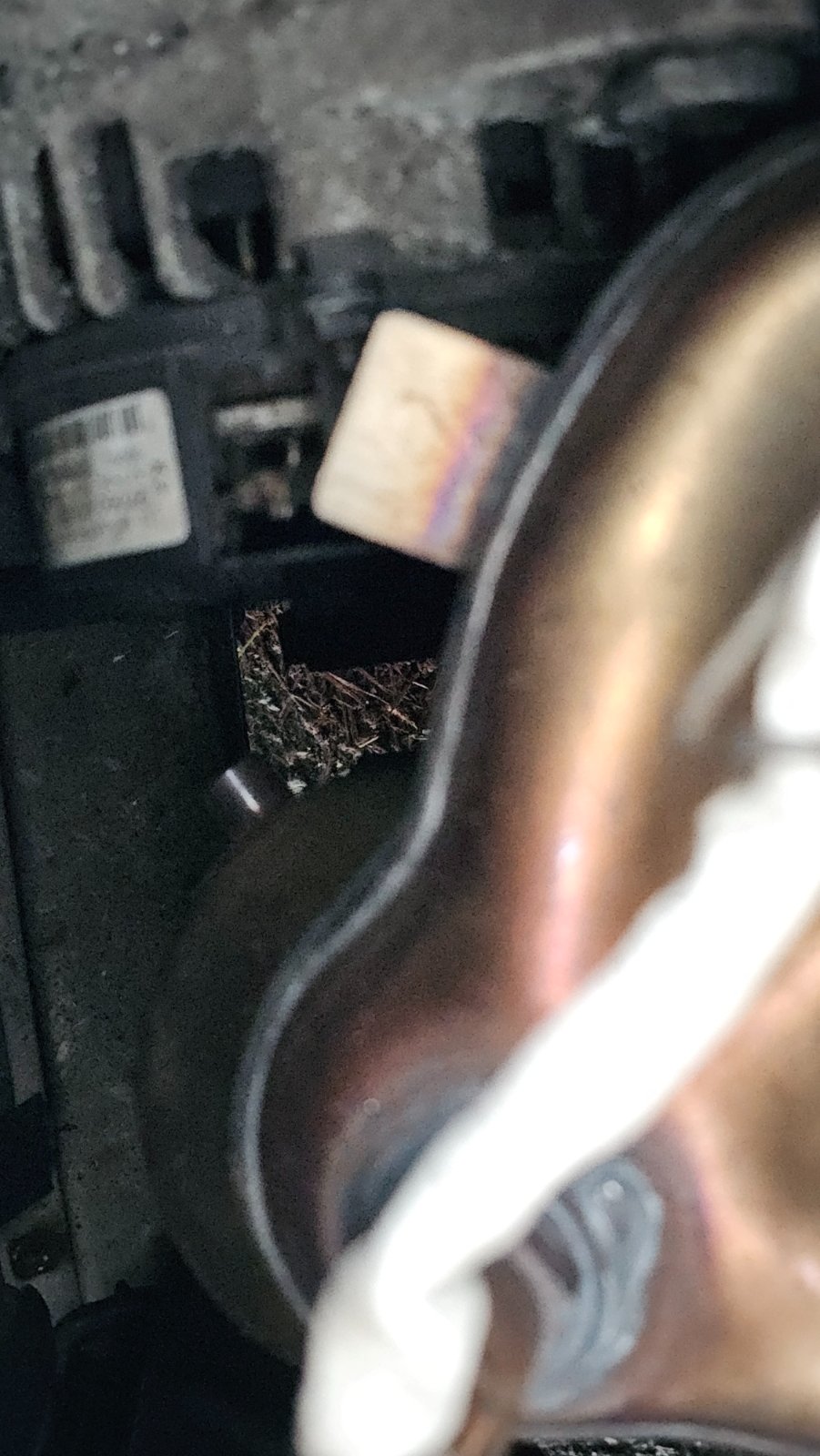

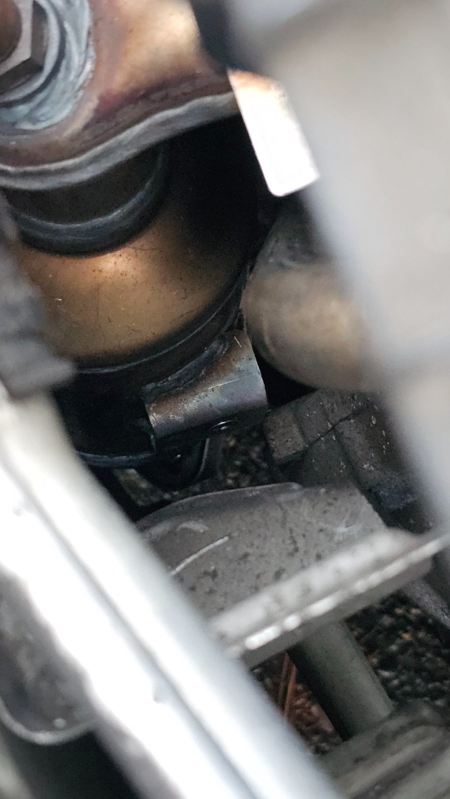

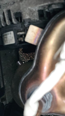

I have recently changed the manifold and cat on the 2011 C1. The cat had some brackets that looked like they should bolt somewhere to stop it vibrating. These were not on the cracked one that was taken off! Perhaps that is why it cracked?

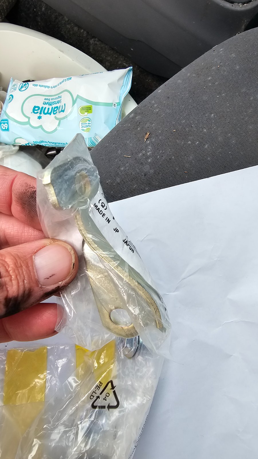

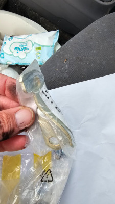

Anyway. Phoned Citroen parts and they sent a support bracket for the car. Photo attached. Can't for the life of me see where it attached to.
Can anyone help? Thanks Matthew

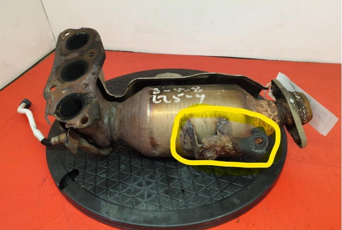

That attached to the right side of the cat, just below half way down where there is a bracket on the side of the Cat, to which that part fits and is bolted on and the other end is bolted onto another part. If you need the diagram, please see below:
