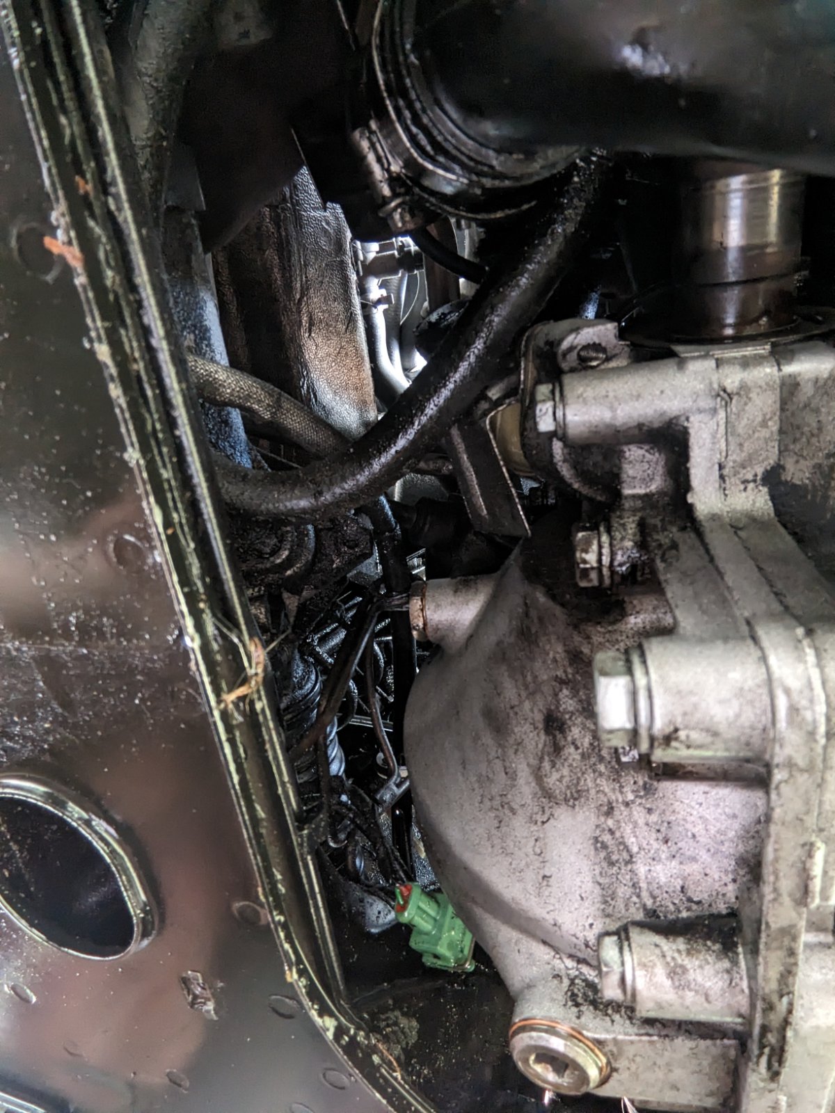

Got some photos of gearbox under side

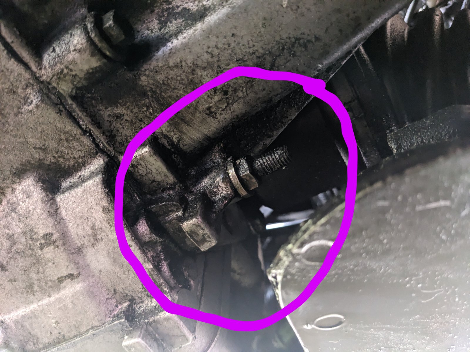

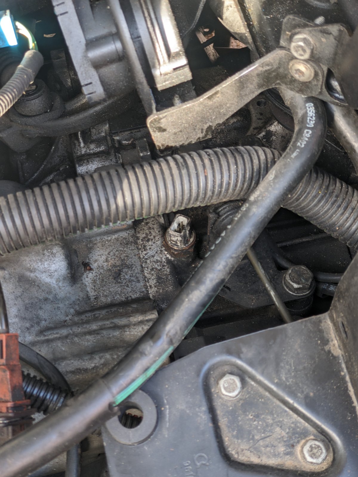

Big Eb
Posts: 36
Joined: 27 Feb 2019, 14:11
x 1
Re: Refill gearbox oil on xantia 2.0 hdi 110 bhp
Unread post by Big Eb »
Top is reverse switch
Middle is a female bolt with washer
Bottom is of the drain plug and other various bolts
Which is best to use or anyone recognise various bolts.

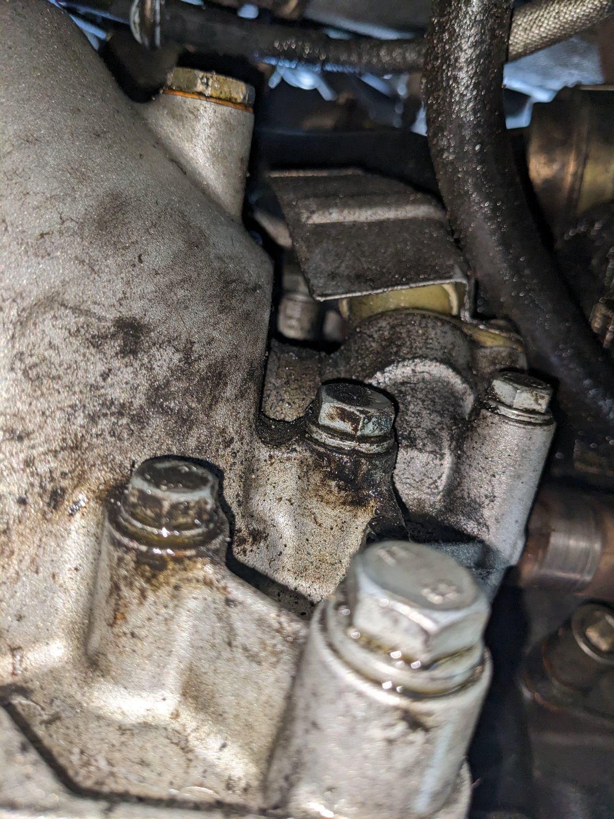

Big Eb
Posts: 36
x 1
Also saw this but doesn't seem to be holding anything together

Eb, the middle one on the tapered projection on the back of of the diff. housing is the level plug... Almost inaccessible... The filler plug is on top of the diff housing and totally inaccessible...
Still best to drain all and refill completely with fresh via the reversing light switch. I have many times... No risk of damage if you use a deep 22mm socket on the switch.
Make sure you only refill with the correct 75W/80 oil...
