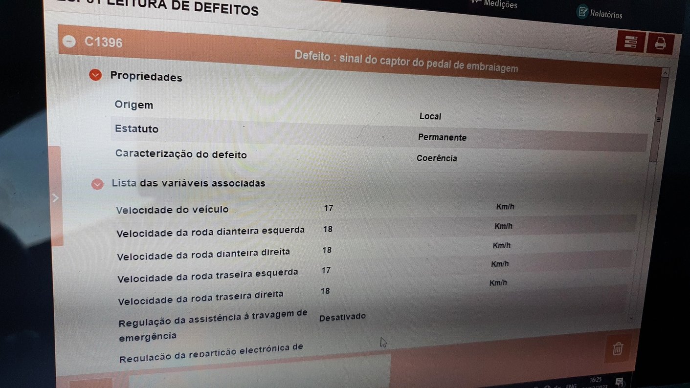

After 2 smaller trips yesterday , the error didn't reappeared, but i drove a bit with lexia connected and an error related to clutch pedal captor appeared ( C1396 )
I noted also that one of the wheels was with less speed than the others - maybe a bad ABS sensor?
x 6946
Re: U1213 on C5 X7
That may be due to a variation in the tyre pressure of that specific wheel's tyre.
