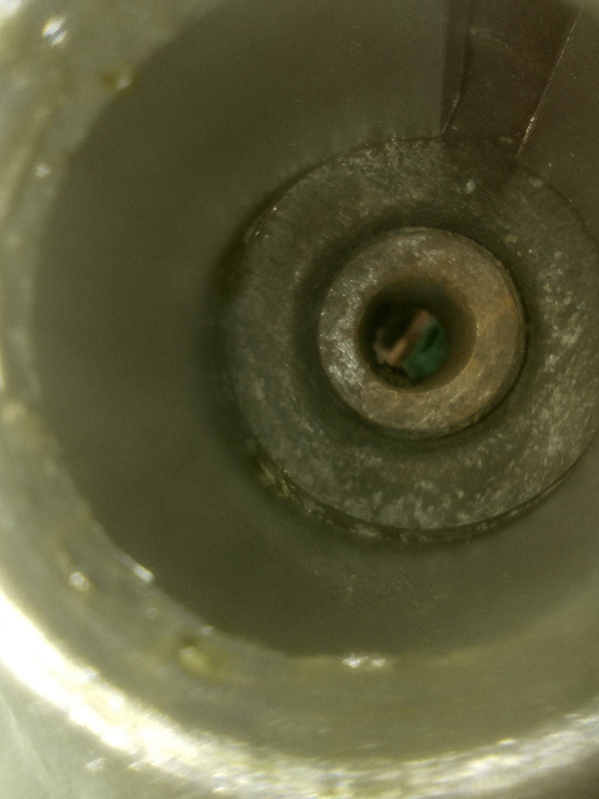

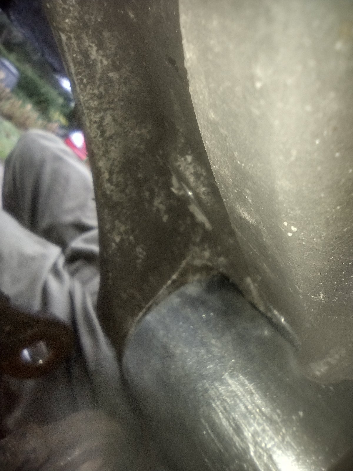

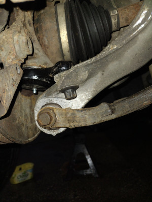

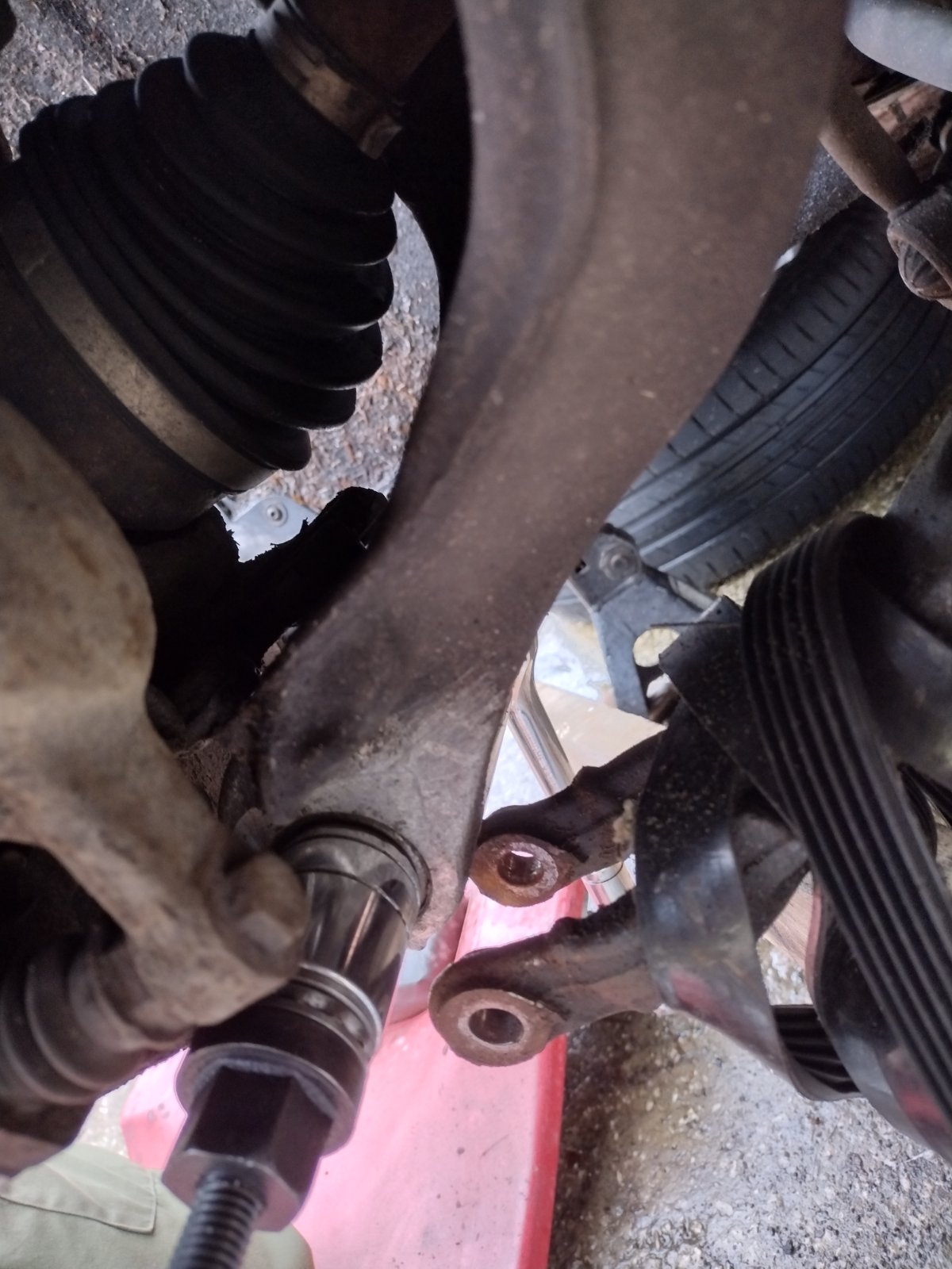

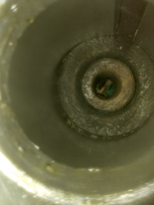

Picture on macro mode to confirm puller cleared the perimeter of the old bush in situ
Tight clearance
Tight clearance
Preparing to press/pull

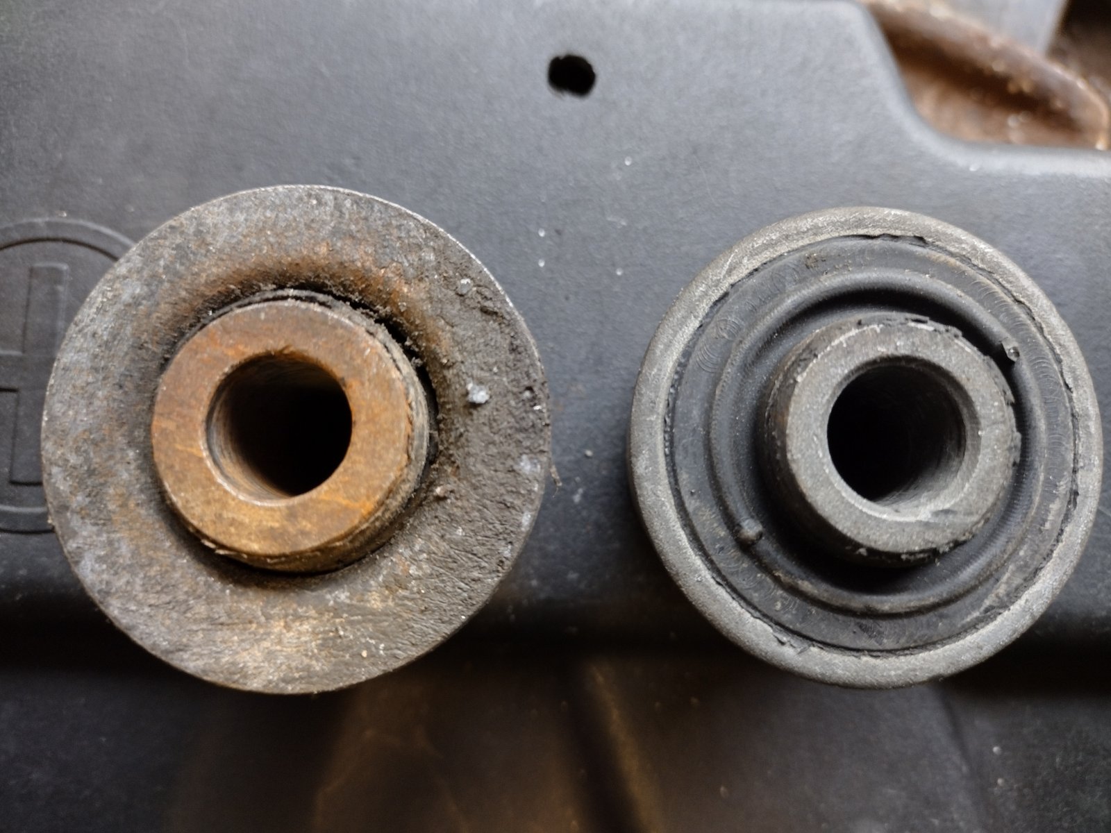

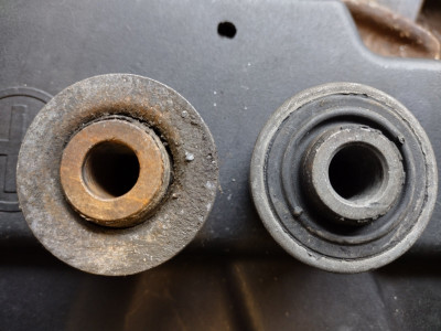

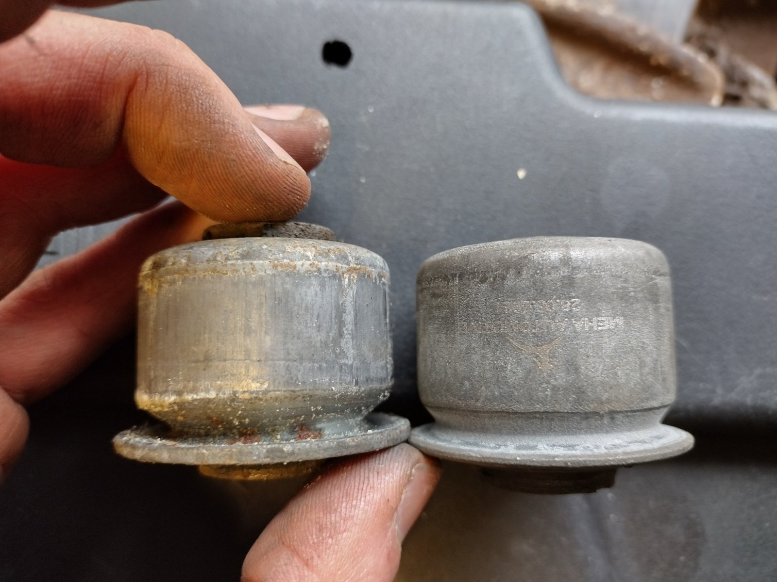

Old bush (have hold of) Vs new
Old v new
Old v new
Old v new
Old v new

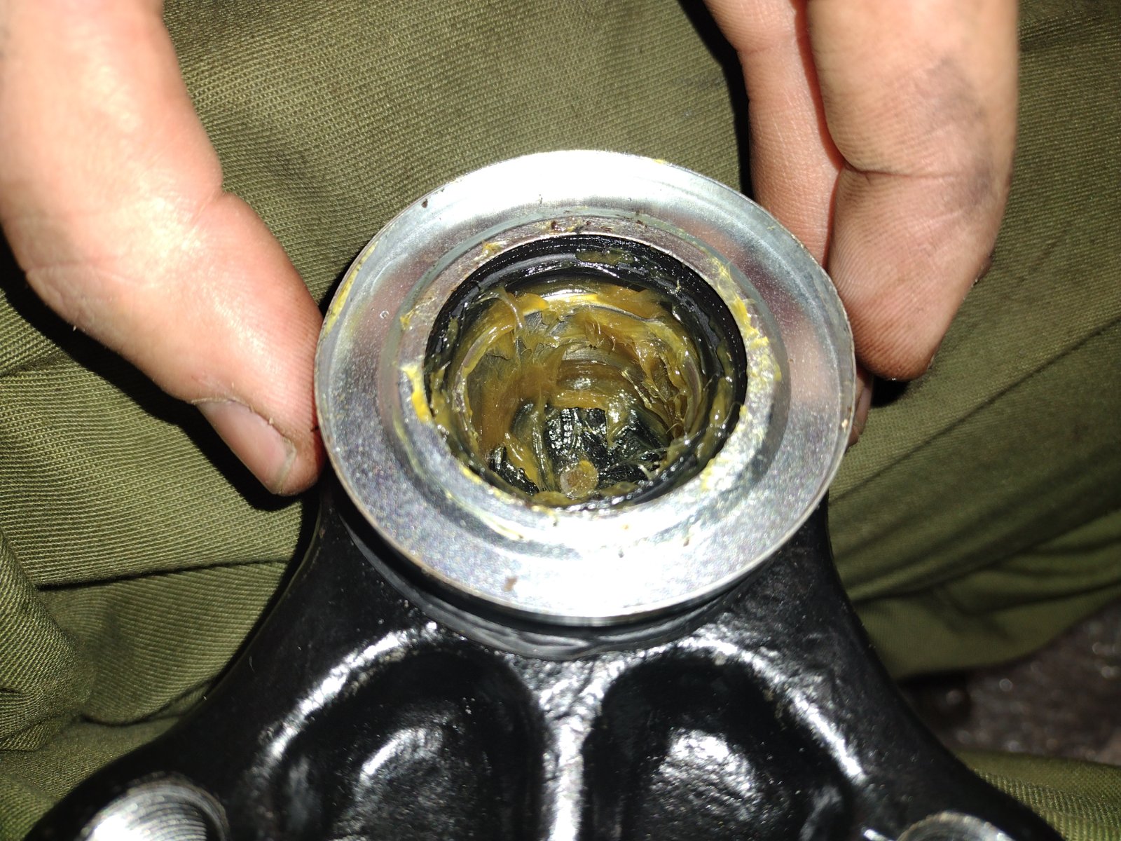

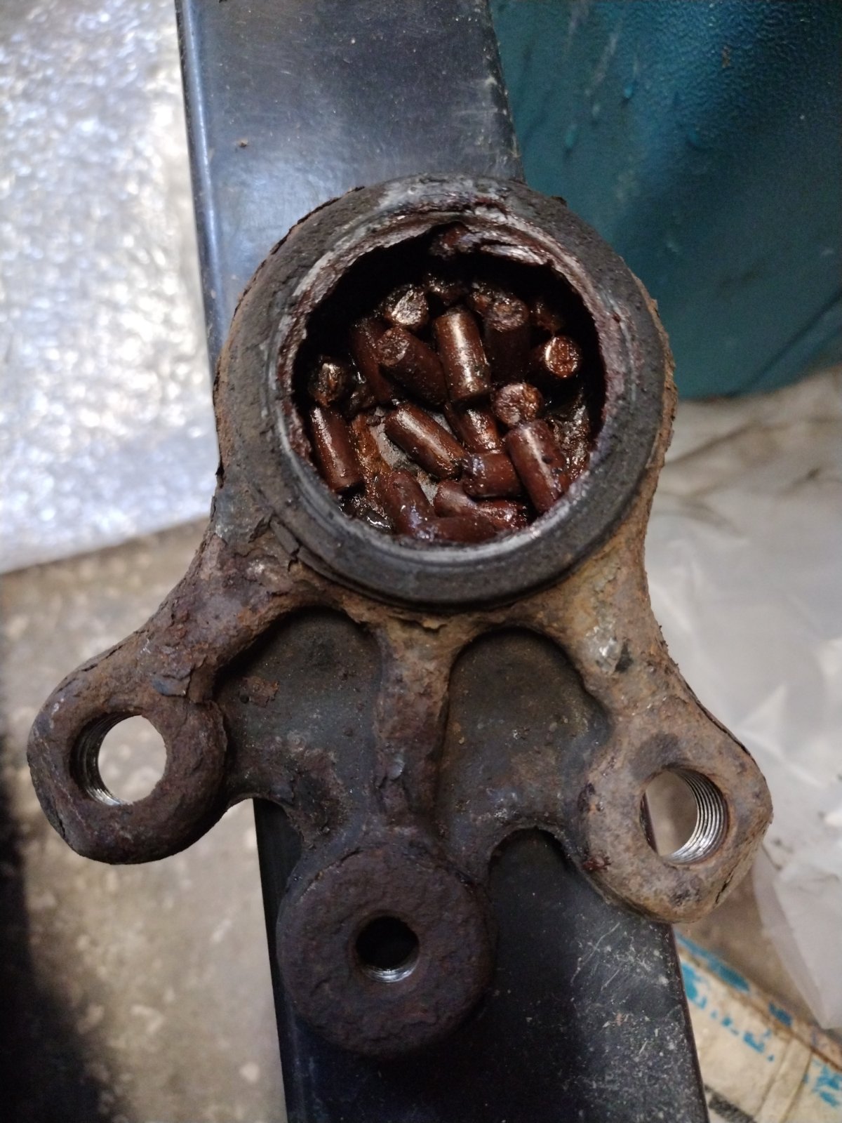

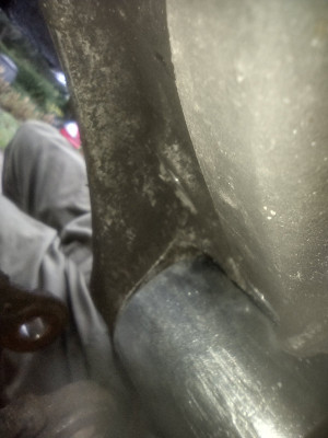

Plan to add grease nipple to the existing FRIP aborted...
Clearly not as healthy as I first assumed!

MattBLancs wrote: 04 Dec 2023, 13:42 Plan to add grease nipple to the existing FRIP aborted...
Looks like a case of athlete's foot there Matt...

Much swearing occured but the inner race is off.
New bearing stuffed with grease. Will tap it on with nipple removed (route for excess grease to escape and sod's law I'd smack it accidentally)

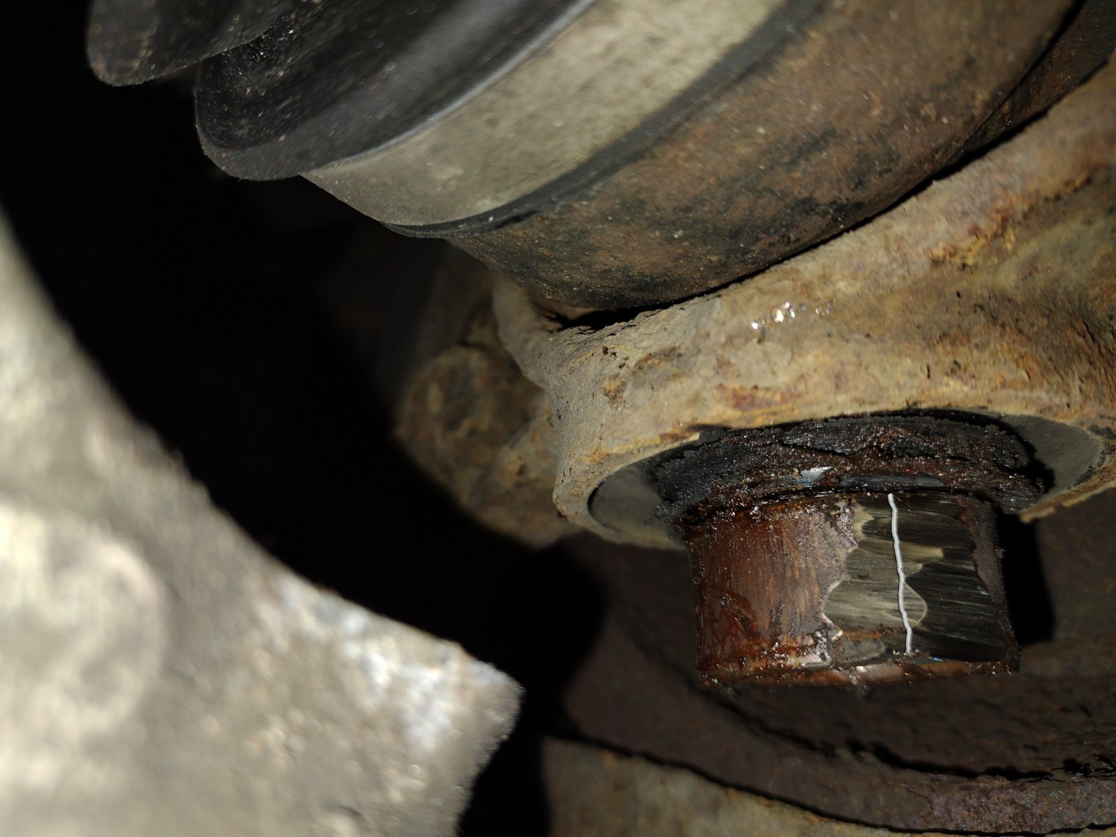

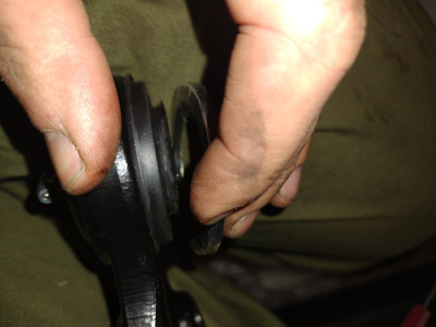

Anyone know which way up the metal ring goes?
From eBay link (item I purchased)
Seems to sit against bearing more keenly the opposite way to how it sits best against the hub!? Not particularly enamoured with it's fit on either and it's very generous centre hole let's it sit miles off concentric.
Eenie meeny miny mo coming up shortly!

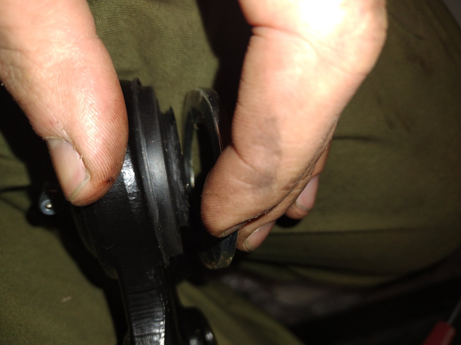

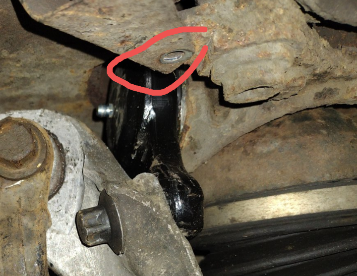

This seems best option, I think....
Centre area away from the protruding seal

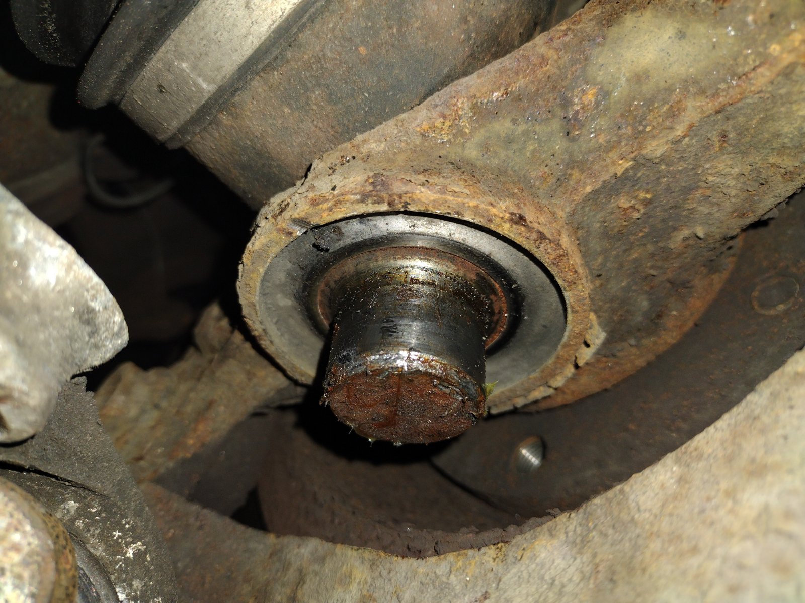

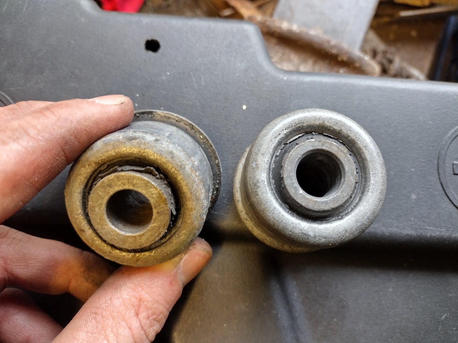

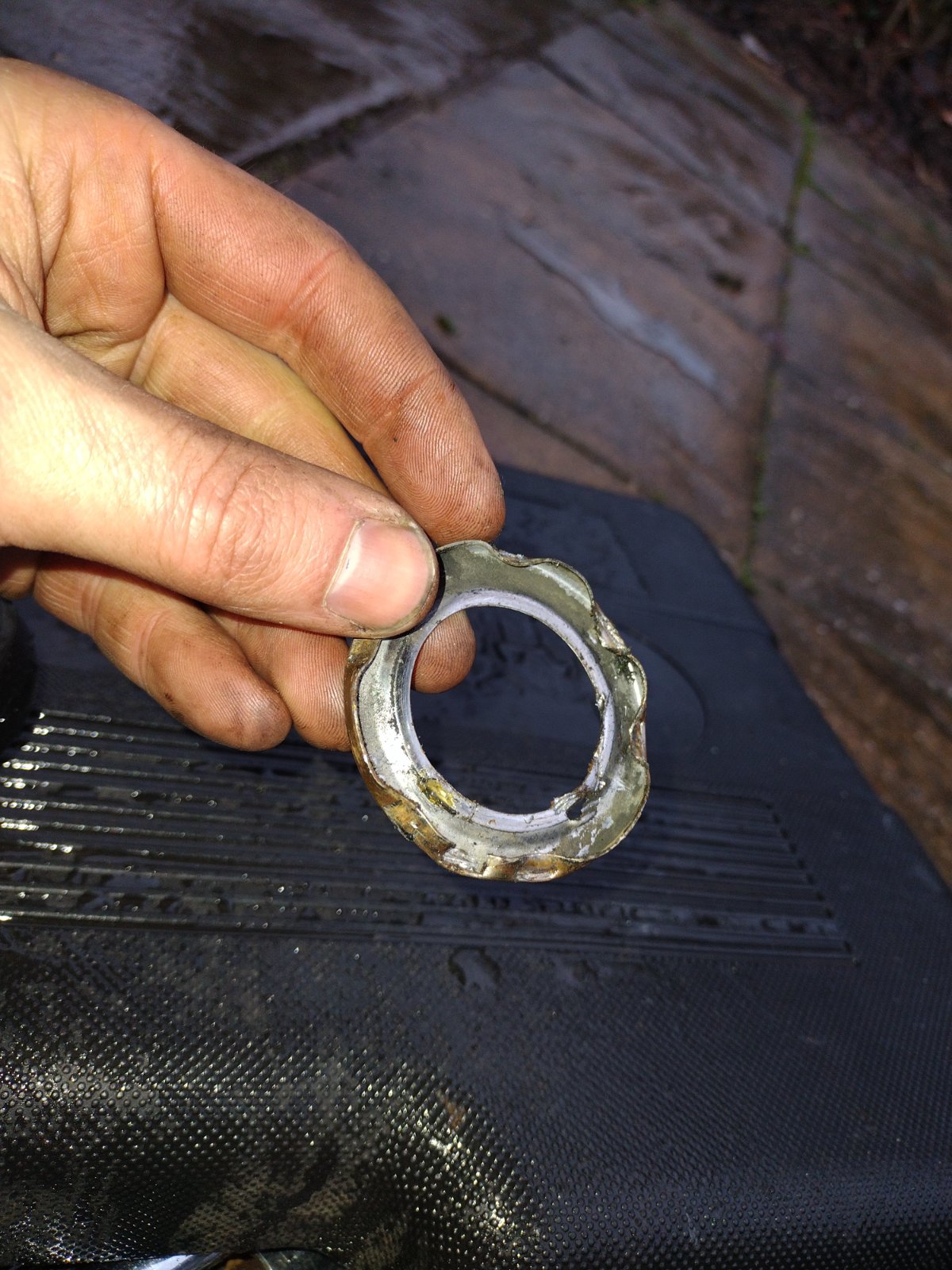

Brainwave! Is one of those rings, already in place!
Shiny = ring
Shiny = ring
Posts: 55070
x 8391
Looks like it!

It is....
I added some wax underseal (Bilt&Hamber) to the top of the ring to prevent water collecting/corrosion in the "tray"......and would have done the nipple insert if I had kept the car.

Took some shifting, well mangled by the time it came loose, but old ring removed.
Some grease above the new ring as well as below (just liberally everywhere :rofl2:

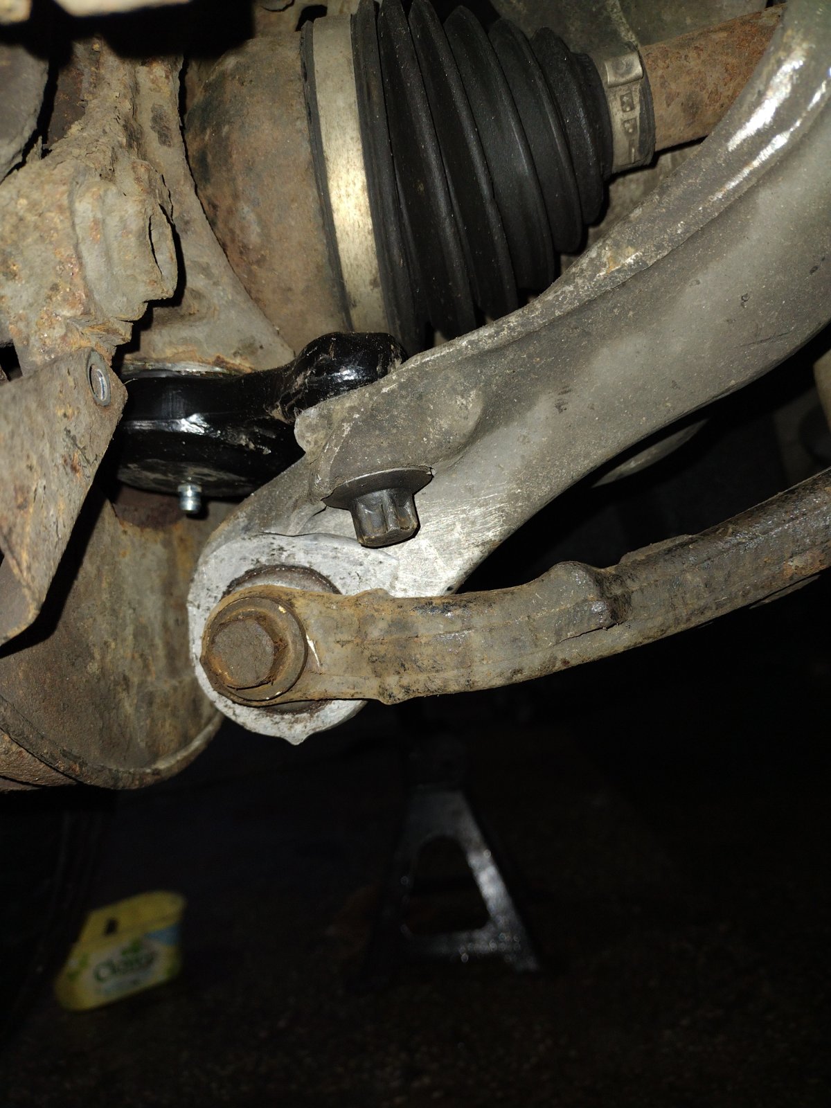

Surprisingly robust tapping with the hammer to bring the new FRIP into place.
Swapped to a straight grease nipple, couldn't get the 90° version to engage with the threads again (access limited)
Ta da!
Ta da!
