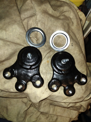

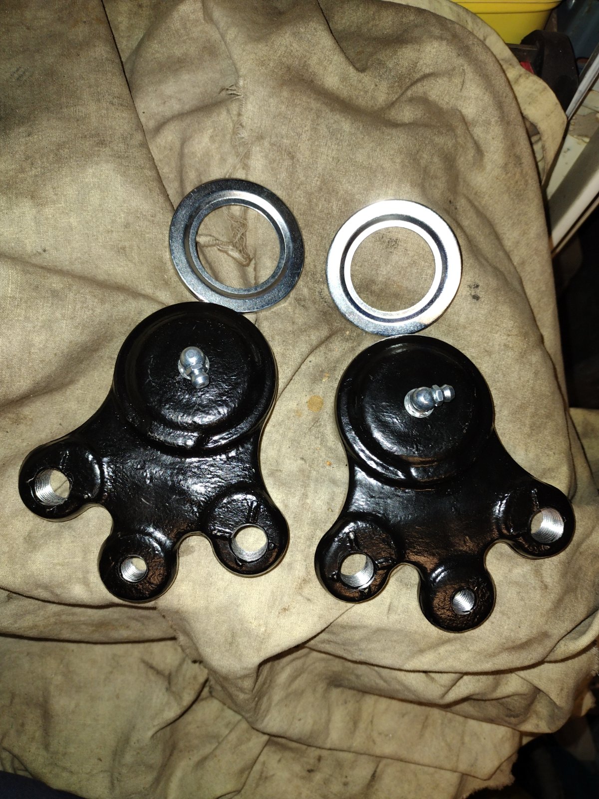

90° M6x1.0 grease nipples. Off eBay (and remarkably similar to the ones in a box set I'd forgotten included 90° variants that I came across again after the eBay order...)

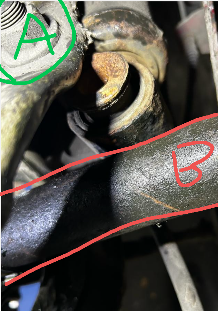

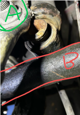

I'm amazed to be honest!
A = the nut that's supposed to hold the strut (anti roll bar drop link on other end of this)
B = driveshaft which it's can't have sat against in service (as would have worn a grove in it with the load it would have seen!)
Quite baffling!
Quite baffling!
Me, in May!!

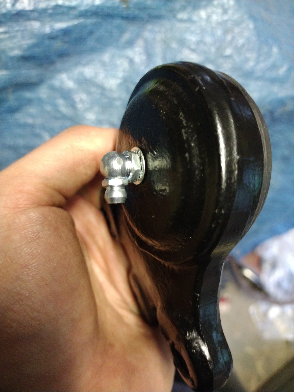

Just for completeness, FRIP with grease nipple installed today:
Described profusely here:
viewtopic.php?p=782201#p782201
