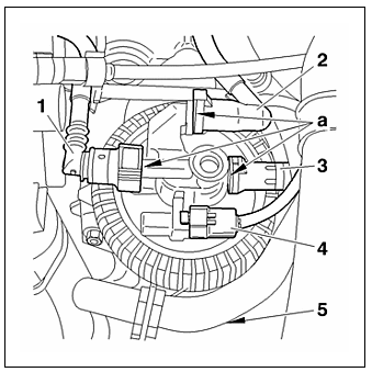

Just one question...in the article that highlighted the bimetallic spring problem (see previously quoted links), the guy said that his fuel filter had no electrical connections. Mine does, see below:
What is this connection used for?
Just to summarise and my conclusion to date: the starting problem was due to a faulty fuel filter housing.
